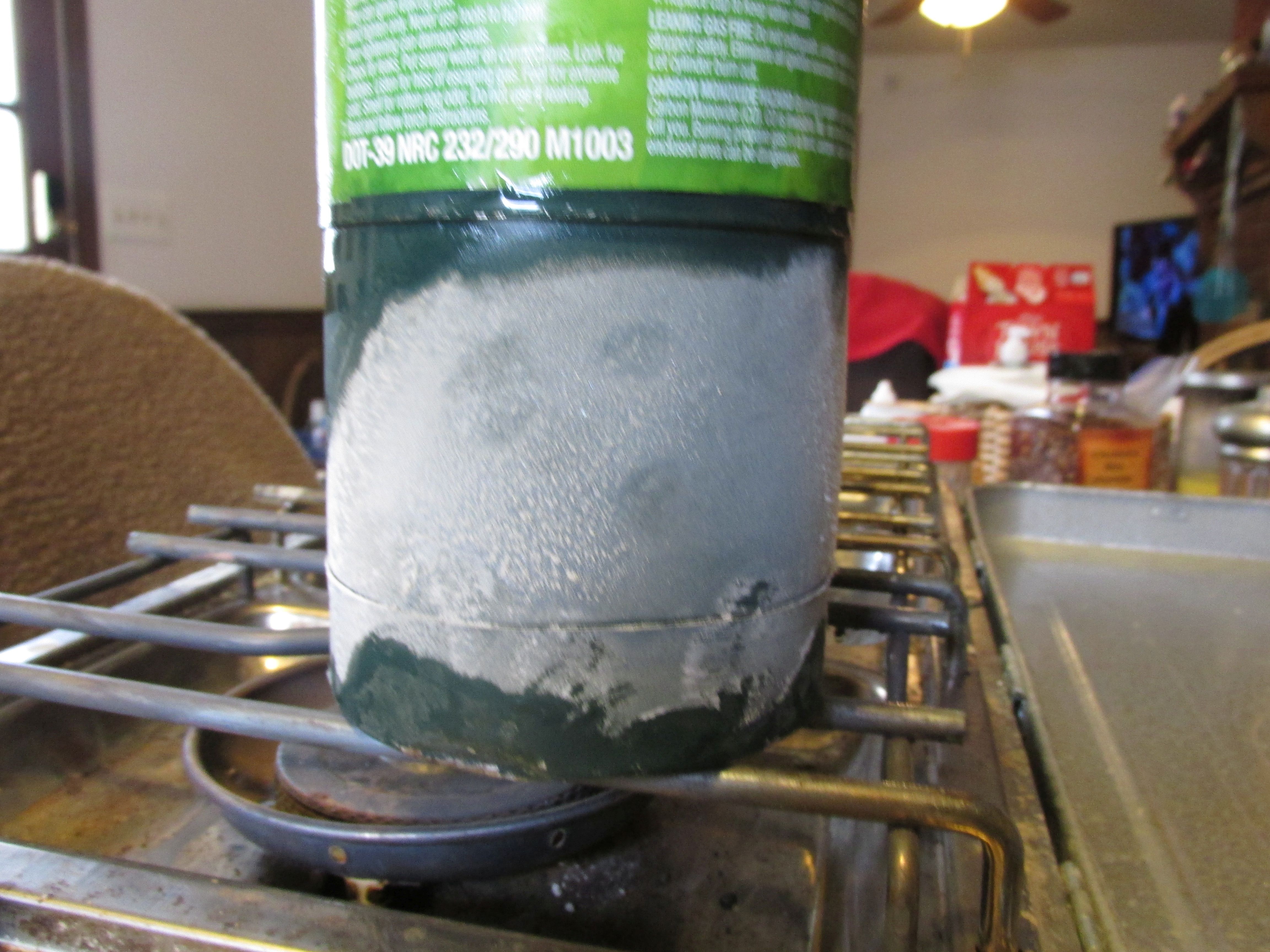

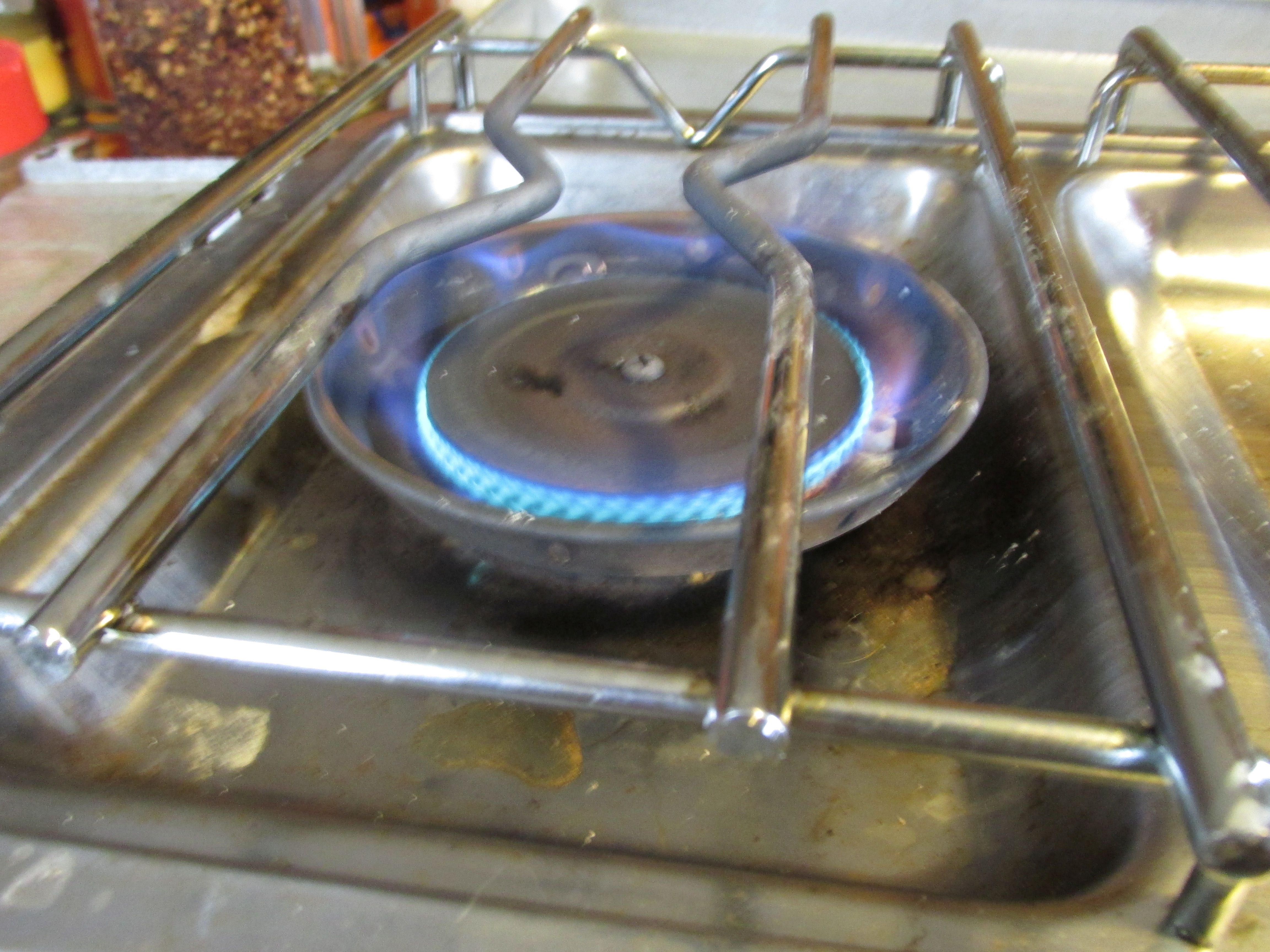

we have a few camping appliances that are designed to run off of 1 lb disposable propane bottles .... https://www.amazon.com/Coleman-Propane- ... 134&sr=8-4 .... while there is no doubt that they can really come in handy, I've found their negatives outweigh their positives .... not the least of the negatives is the fact, as can be seen in the link, they are expensive .... other negatives include the propane will freeze if they are used with an appliance that requires a good bit of propane .... the first two pictures show a frozen tank that was powering a single burner set on medium/low in our 3 burner camp stove .... thus my motivation for asking, if anyone using these bottles refills them ..????.. if so, any insight you may have would be appreciated

I always thought those weren't refillable. Maybe I'm wrong. I haven't purchased those in years. My goodness, have they gone WAY up in price! I don't think your pictures loaded if you intended to post them.

my oooooops .... they should there now

as mentioned above .... years ago I rigged up a hose that runs from our camper's quick disconnect fitting to whatever appliance I'm using .... that setup has served us well for 20 some years and is still what we use when using our propane three burner camp stove ..... what I need is to come up with a setup to use when we are not near the camper while cooking .... my preference is not to be tied to hauling 20 or even 10 lb propane tank so the ease of using a 1 lb tank is attractive .... having just learned that our camping stove will freeze a 1 lb bottle requires me to have 2 or more on hand
