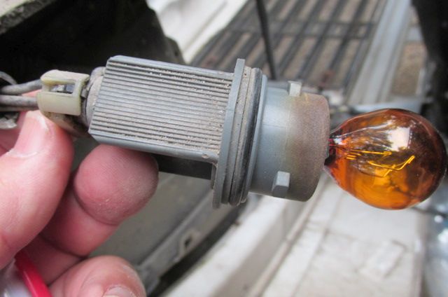

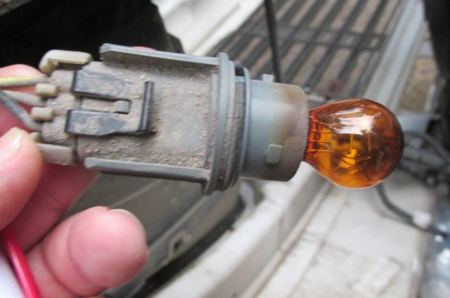

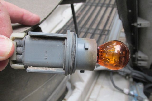

yesterday needing assistance with a couple of issues we stopped at Boerne RV .... their primary focus is repair and service, NOT sales .... I want to give them a positive endorsement as being a good place to do business .... as noted, we needed help with 2 issues .... first, the driver's side running light (which also serves as a parking light and turn signal) on our Sportchassis had gone out .... having a new one in the truck, I replaced the bulb ... it still didn't work .... as can be seen below, the bulb plugs into what I'm going to call an adapter socket, the plugs into the truck's wiring harness .... second, I needed a bottle of rubber seal treatment .... when we walked through the door a fellow called to us to come on in .... I told him what we needed ....he took us into there small store which happened to have exactly what I needed and was pressed $2 less than Amazon .... we then walked outside for him to take a look at our truck .... based on past experience, I sure didn't want to have to find a Freightliner facility .... my hope was he might know a local repair shop where I could take the truck to have it fixed .... as can be seen below, the bulb plugs into the adapter which plugs into the wiring harness .... I opened the hood, he removed the fitting shown below and then removed the bulb .... I heard him say, that's not where it should be ....he walked back into his shop and came back with a small, flat blade screwdriver .... he used it to move a metal contact and plugged the bulb back in ... I'm most happy to say, ALL'S WELL .... he wouldn't take any pay for fixing the socket .... neither the lady in the office and the fellow who did the work could have been any nicer .... we were literally in and out in less than 15 minutes .... we were impressed and pleased

Your next gremlin? Looks like that running light runs hot. Discolored plastic socket looks heat damaged (brown). Could also explain the dislocated electrical contact in the socket your fellow found. Might want to see if there is an LED equivalent replacement. Lower power - less heat. Similar brightness.

I was thinking pretty much the same thing .... those fittings with the same number bulbs have been there since the truck was built in '07 .... they have fogged up to where both sides need to be replaced .... my hope is they will last till we get home in April where I'll make a decision on replacing the bulbs, the plugs or the whole headlight fixtures

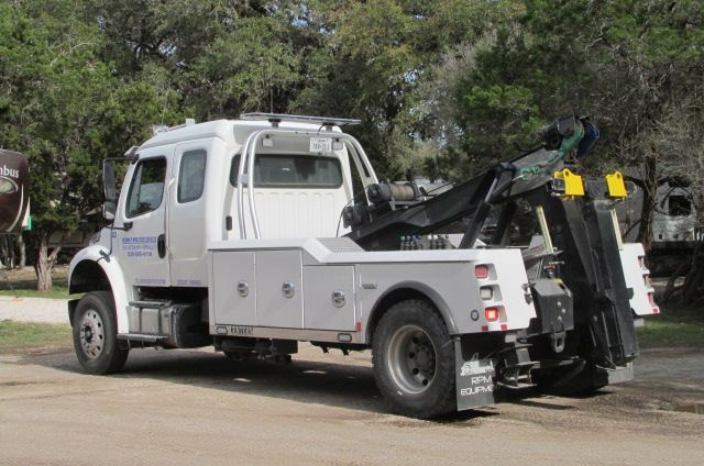

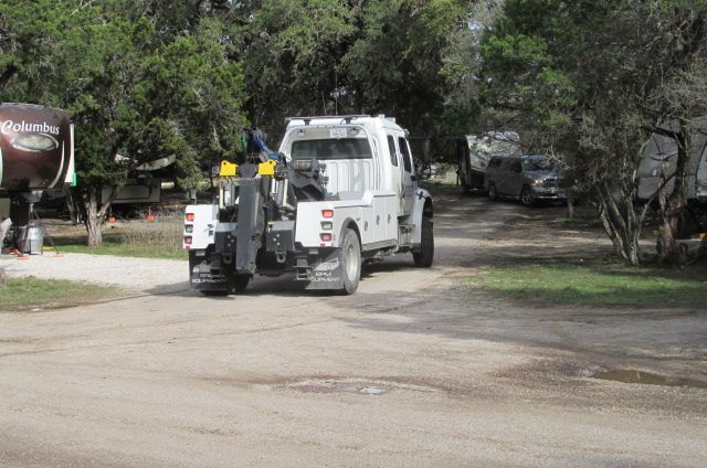

as noted above, today has been one of twist and turns .... the tow truck finally arrived .... I couldn't help but smile because just, like our truck, it turned out to be on a Freightliner M2 Chassis .... the driver proved to be very good at his job .... hooking up to our truck included removing its driver shaft and running a air line from his truck to the air tank on our truck .... he parked our truck at the repair shop at 5:15pm .... the shop closes at 5:30 .... they will check it out in the morning and give us a call when they know what is causing the problem
