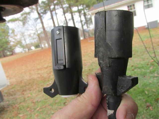

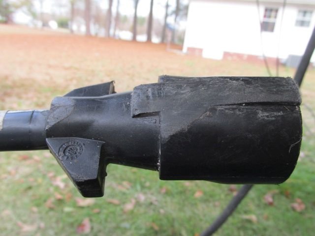

another item checked off of our pre-trip To Do list .... 40 years ago without arthritic finger joints it was much easier to replace a "Trailer-Side 7-Pin RV Blade Wiring Harness Connector" ===> https://www.amazon.com/CURT-58140-7-Way ... 163&sr=8-9 .... its the plug that connects the 12V power cord from the camper to its tow vehicle .... picture 1 shows what happens when the plug comes loose and slides down the road pavement (picture 1) .... replacing the entire cord with a plug can get expensive .... replacing just the plug is a much cheaper option .... second picture shows old and replacement .... the third shows the replacement installed .... the plug doesn't come with any written instructions and it takes a couple of minutes of pondering to figure out how to disassemble it .... once you get it apart the color of each wire is stamped beside each connection .... hard to believe it took me almost 2 hours .. :? .. oh well, its on there .. ;)

Good job Jim! The new one looks a little more ergonomic too!

the old one was molded onto the end of the wire .... the replacement isn't as heavy duty .... I shortened the cord to where if the new one should pop loose, (hopefully) it will swing in the wind but not hit the road .... sure would be nice to never test it .. 8-)
