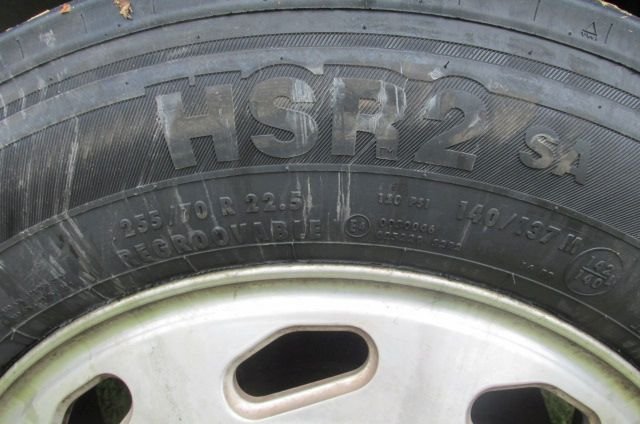

a major item on our pretrip check list was taken care of this morning .... that being new front tires for our truck .... the tires were bought through our membership in the Family Motor Coach Association and installed by Colony Tire of Raleigh .... the folks at Colony tire sure didn't have much in the way of business while I was there .... from there I drove over to Freightliner of Raleigh to pickup a set of tow hooks to install on the front of our Sportchassis .... unfortunately, they ordered the wrong ones so a reorder is underway ....

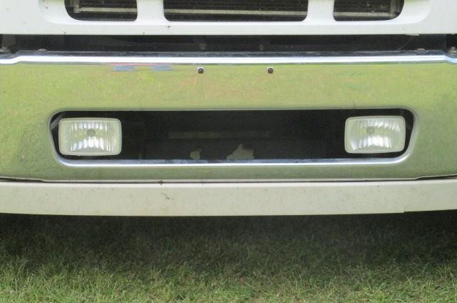

those who followed our most recent trip to Texas may recall we got stuck twice and required a short tow both times .... there aren't any tow hooks on the front of our Sportchassis (picture 1) .... consequently, connecting a winch cable to it is difficult to do without damaging the bumper .... on our way home from Texas we camped with a couple who were driving a newer Sportchassis with tow hooks (pictures 2 & 3) .... a little over a week ago I called the local Freightliner dealer and ordered a set .... naturally :roll: , when I went to pick them up, they wouldn't fit .... the fellow I worked with promised to do some research and reorder .... just got word that he had to go to someone back at the factory and has been promised a correct set will be shipped .... they should be here next Thursday .... once they arrive, getting our sons to install them will be next item on our agenda

as mentioned above, we just replaced the "Steer Tires" on our Sportchassis .... the oldest Michelin we removed from the truck was made in 2010, the youngest 2013 .... both had surface dry rot cracks .... the cracks on the oldest were more pronounced and the tire was worn on the outside edge .... it started wearing years ago when the truck's front end was out of line .... it still had plenty of tread from the inside edge to the worn outer edge .... I could have had it rotated on the rim and probably gotten a few more years wear out of it but I guess I'm just getting too old myself .... as a side note, those tires had the same liquid tire balancing fluid from day one .... the inside of the tires looked as shiny black as they did on day one .... NO sign of any dry rot, cracking or aging .... furthermore the inside of the rims looked new .... yes, I had them install the same fluid in the new tires .... I'd much rather spend the money and replace a tire early than to push it and have to deal with problem out in the middle of nowhere .... I decided to replace both because there would be a bigger difference in tire diameter than I am willing to put up with .... I believe the handling would have been rather squirrelly and like I said, I'm just not willing to put up with it .... if these new Continental 255/70R22.5 HSR2 SA tires last 10 years, that may well be longer than I do .... ;)

the new tires on our truck that were mentioned above

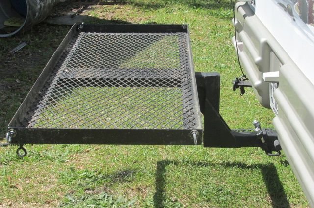

the first picture below shows the carrier behind our camper on August 20, 2019 .... it was taken at a truckstop located on I-40 just east of Knoxville .... the second picture shows the broken area .... the third shows the carrier last week when we dropped it off for repair .... the rest show the carrier when I picked it up a few hours ago and with it mounted behind our camper .... the last pictures show a recently purchased stabilizer .... the shop really beefed up the carrier .... the hitch bar is solid steel .... heavy steel reinforcement plates have been added .... one can be seen in the 5th picture on the front of the riser .... this checks off another major item on our Have To Get Done list

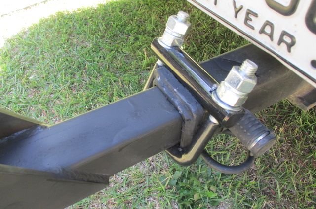

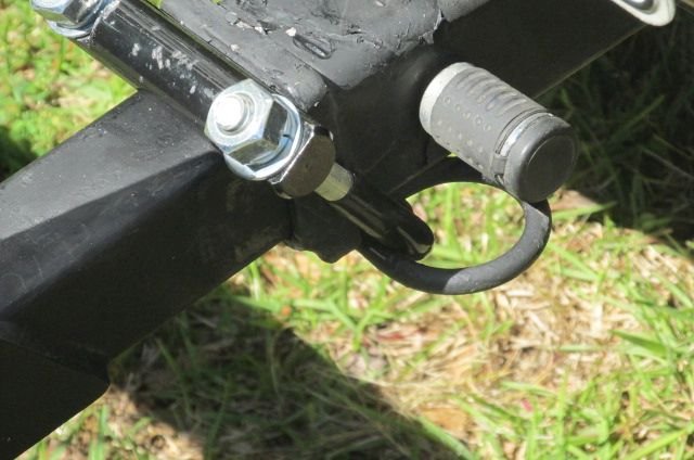

OK, I fully admit that I'm prone to over think and then rethink many of my projects .... earlier today I revised the stabilizer mounting shown above .... with this mode of mounting, the stabilizer is pulling down on the carrier's hitch .... also as noted, the rings for attaching safety chains change the dynamics .... the gap the U-bolt has to cover is longer .... so much so that there isn't room add a locking nut .... hopefully, the lock washer will be sufficient .... one bonus of this change is the carrier sits a bit more level

as mentioned above, the next item on our pretrip check list will (hopefully) be taken care of today .... our first task of the morning has been to get our truck to the shop for them to install front tow hooks .... the fog lights shown in the first picture will have to be moved toward the center so as to install the hooks as seen in picture 2 .... should be a bolt in operation, the only question is how many bolts will be required .... example, will the entire front bumper need to be removed :?:

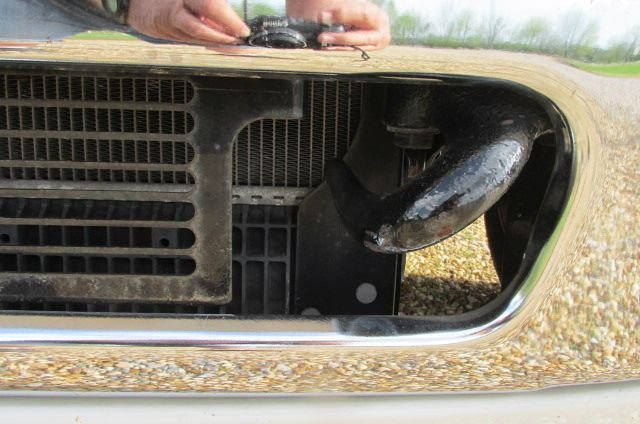

Post by JEBar » Fri May 01, 2020 3:37 pm

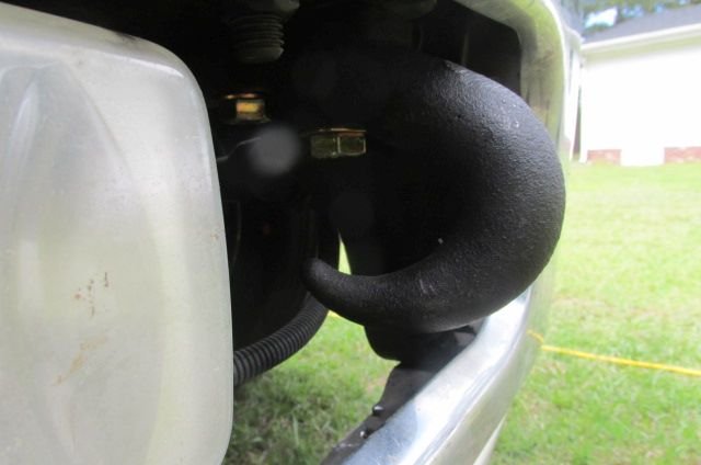

the hooks are installed .... they most certainly are heavy duty .... my hope is not that they are in place, we'll never need to be pulled out again ;)

Post by BigAl52 » Fri May 01, 2020 5:49 pm
Those look like they should do the job. It always works that way you will never need them again now that you have them.
Posts: 20449
Re: 2020 Trip To South Dakota
Post by JEBar » Fri May 01, 2020 7:04 pm
if that proves to be the case, the hundreds of dollars we have tied up in them will be money well spent
