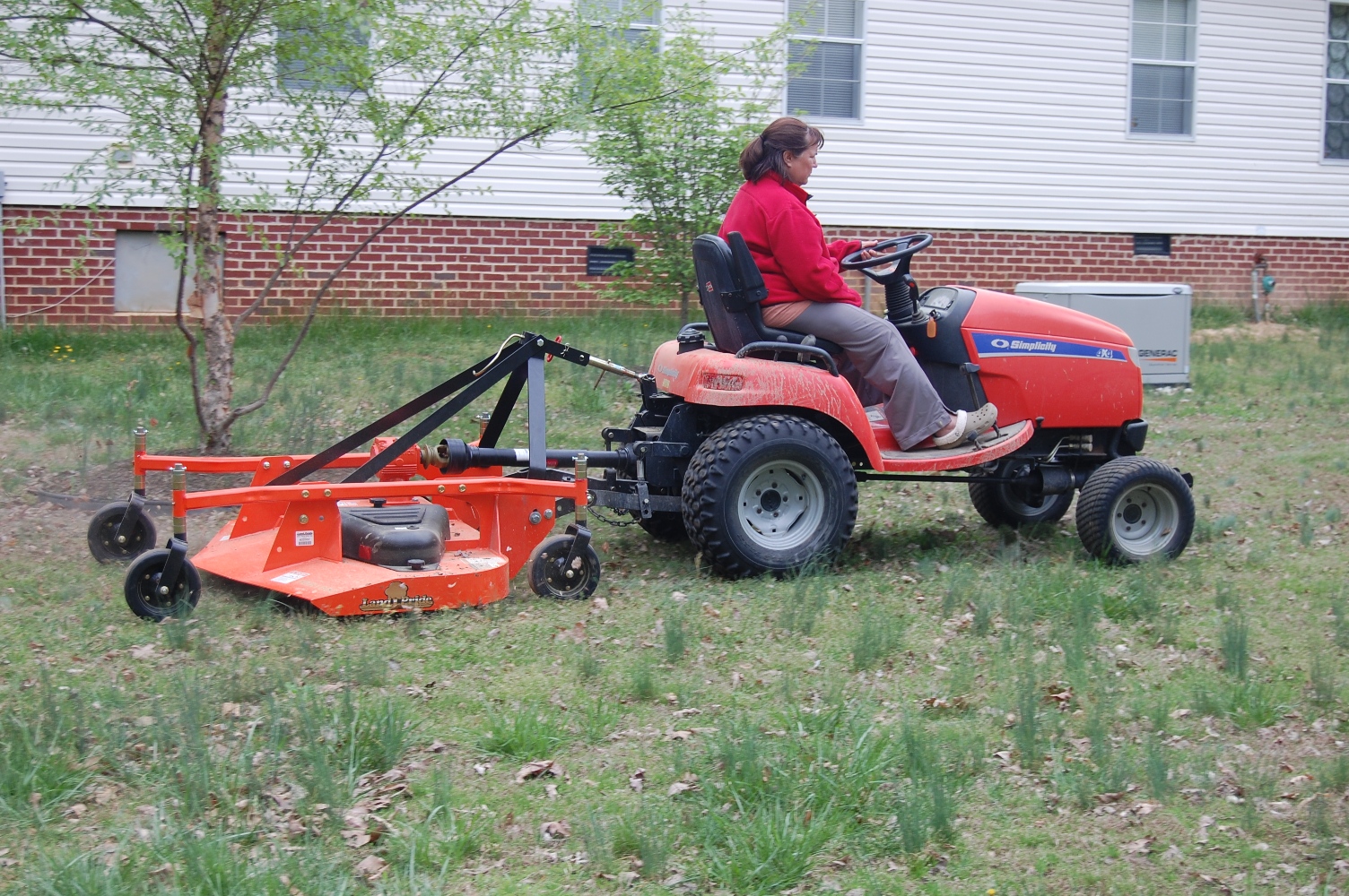

Miss Tina's finish mower for the tractor needed new blades. The last time we just had them sharpened. She knew the guy who did the job at the local Farm and Feed and he came by and jacked up the pull behind finish mower, put it on blocks, took off the blades, sharpened them on the grinder, and then reinstalled them. We paid him $75 for the house call, much less than the $100 they charge to pick up and deliver the mower and tractor BEFORE they ever do any work. Since then the business has gone kaput, and he is no more... moved from the area. I had just had a major surgery back then and couldn't use my left arm at all.
This time, we ordered new blades, the old ones were original equipment and were done. Since I can't roll around on the concrete, we decided to do it the easy way. We put the mower on the concrete pad and dropped it. Took off the drive shaft, and then rolled it forward onto the attachment points so it was standing vertical and tied it off so it was stable and couldn't fall. Then I could sit in the chair and work. Soaked the bolts in WD40 and let them sit for a half hour.
Half inch breaker bar and Bam... off came the old blades. New blades went right on. 55 foot pounds of torque per spec, and we were golden.
While we had the mower handy to the shop, greased all the fittings, greased the shafts for the pto on the tractor and the mower, and the U-joints on the drive shaft. All in all, about 90 minutes work. Cut like a dream.
Gimpy all Grumpy can still git some things done. :lol: Just have to adapt and overcome.

Simplicity mowers were Massey Ferguson. This model is the Legacy series, top of the line when Miss Tina chose it years ago. Front and rear Hydraulics, cruise control, electric adjustment for the Belly mower if you want to use it. We dropped it about five years ago when I bought the finish mower, and there it has stayed. This one is 4wd, with a locking rear axle as needed. It does the job so far, and we have a blade, and several other attachments, but we have been thinking of a full size entry level tractor with a bucket since we have gotten older. If we went that route, we would keep this mower and leave the mower attached and only use the smaller tractor for mowing at that point.... or maybe for spreading grass seed and aerating.
