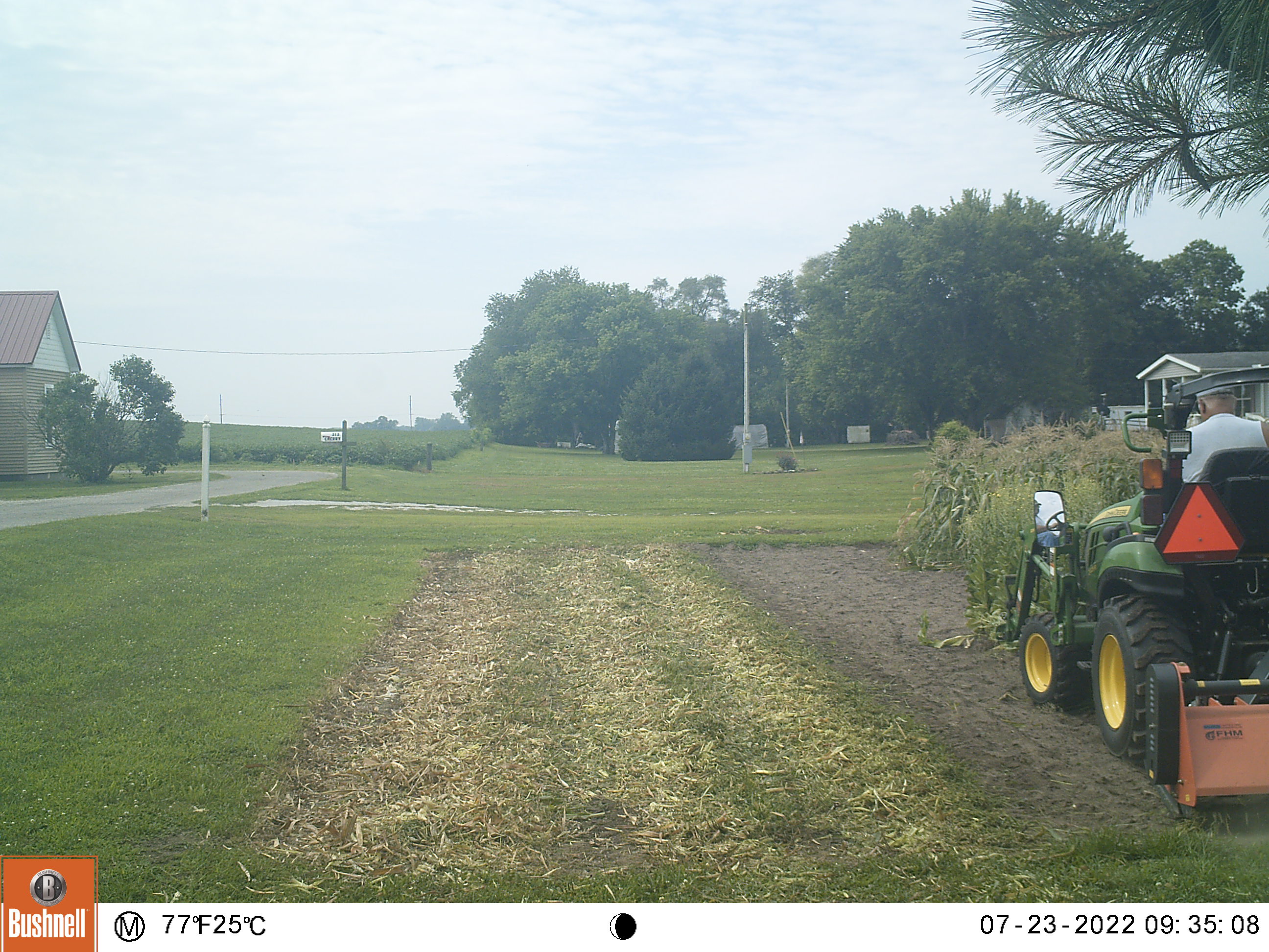

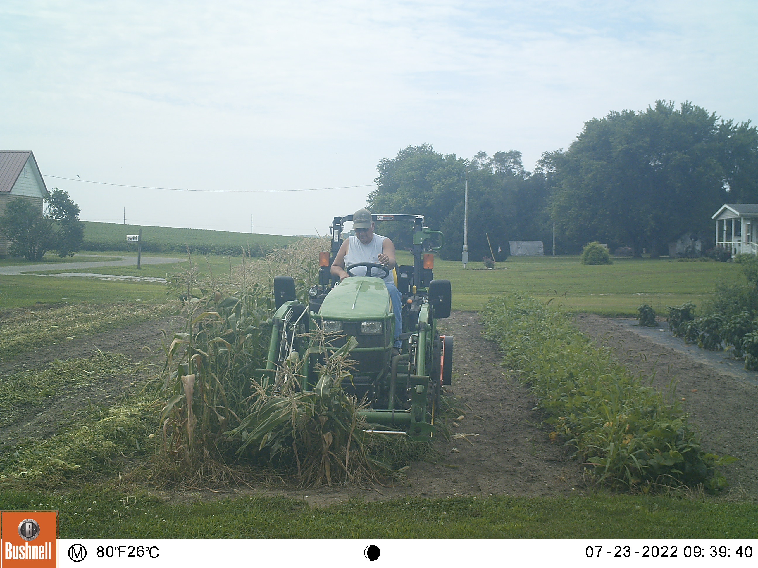

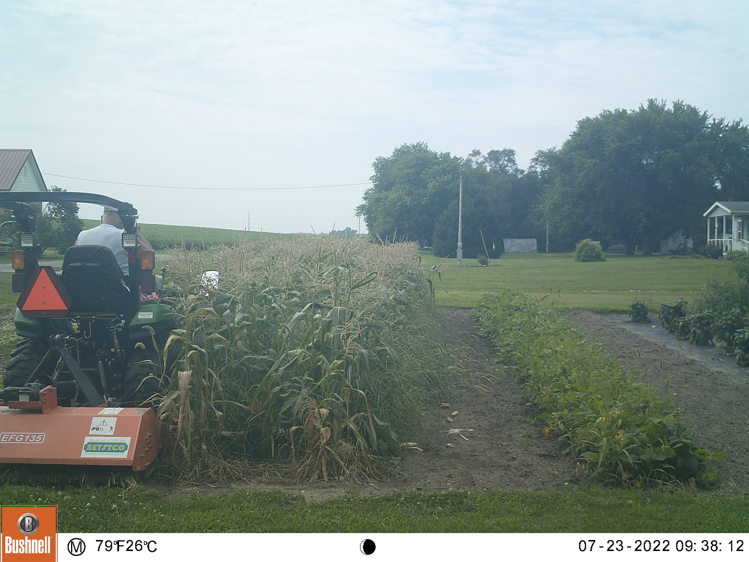

I have a flail mower that I use with a compact tractor. The one I bought has the hammer blades that handle brush and rocks better than the Y blades. Mine works really well for mowing pasture and food plot area next to woods. I don't have to worry about picking up small limbs and I can mow through brush areas with small saplings without problems. I purchased an entire set of replacement blades at a discount when I bought my mower. Mine also handles the garden sweet corns stalks better than any mower I have ever had.
I have never seen a flail mower that can be pulled with an ATV. I assume it has its own engine, since my flail mower is powered by the tractor PTO.

Mine is only a 53" cut and my compact tractor has 18 HP at the PTO but so far I have never got into anything that bogged the engine down.
Pretty sure mine is made in China. I got it from Betstco company in Oregon. The brand is Farmers Helper. I have had mine for 4 years and have had no issues to date.
