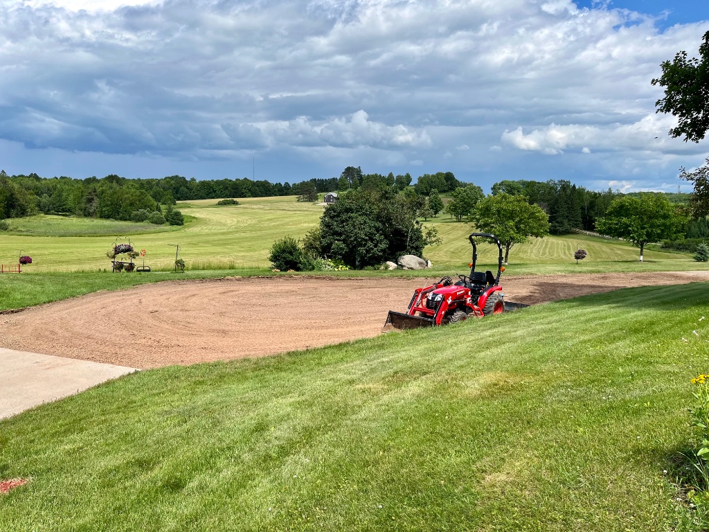

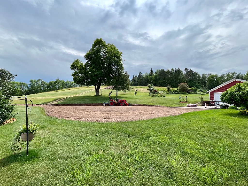

I’ve completed the lowering and leveling of my driveway and circle for turning around. I removed about 100 yards of clay and dirty gravel from the area and another 20 yards of clay/dirt from the backyard and placed it on the hill as a berm.
My turn around area is 50’ by 50’ and with the backyard I figure 60’ by 60’. If I want the clean one inch gravel to be four inch deep I figure I’ll need 46 cubic yards. How is my math?

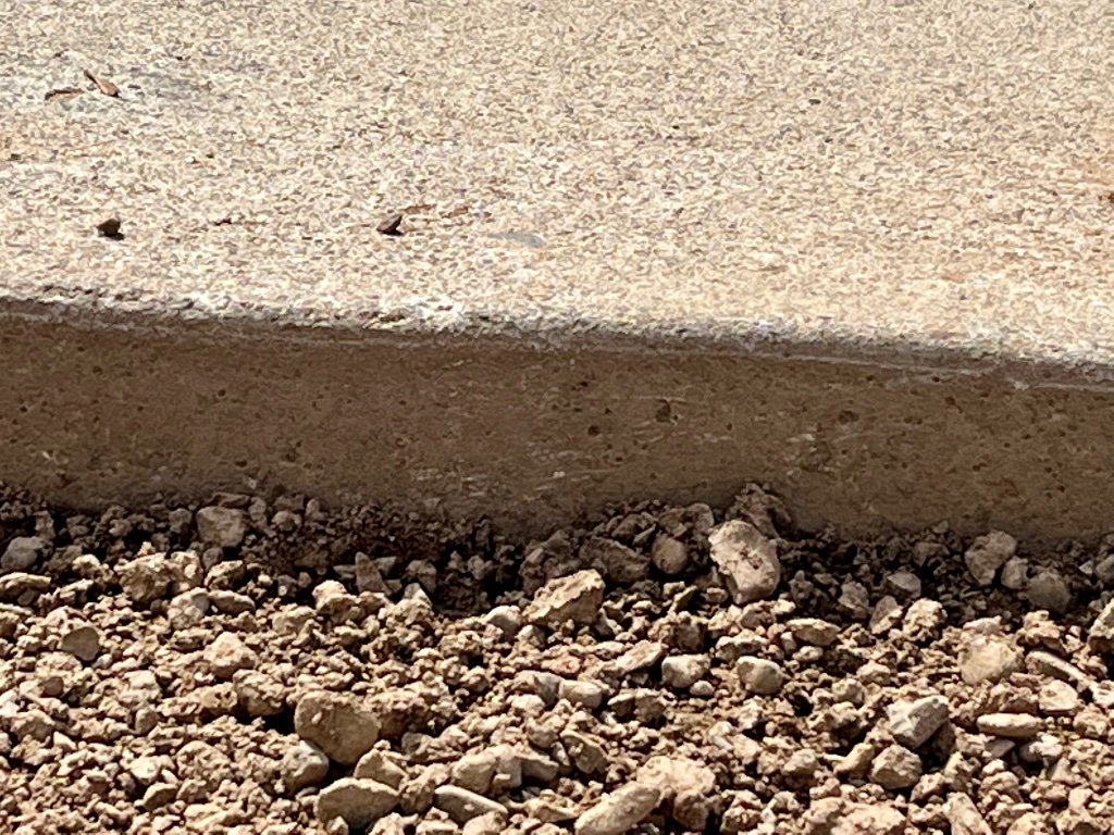

The gravel was about two inch above the concrete and made a two inch puddle last spring when the snow melted. It’s now about four inches lower.

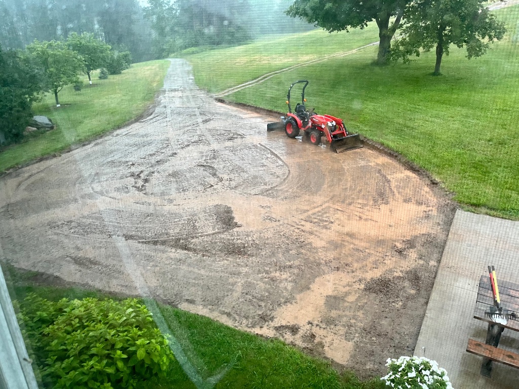

It just started to pour. Looks like I need to add an inch of dirt in a small area so it doesn’t puddle under the gravel.
And I need to add a small drain channel at the bottom end.

Sorry my question didn't go through. What type of matting are you going to put down?
My drive way is a double layer of 3 to 4 inch rock, topped with 4 inches of 1". underneath it all are two layers of driveway matting that keeps all that rock from sinking into the virginia clay.
I'd also suggest dropping some french drain piping in there across your driveway and to the lawn. It will help track that water out. Looking at those puddles, you might have some serious moisture issues if you do not.
