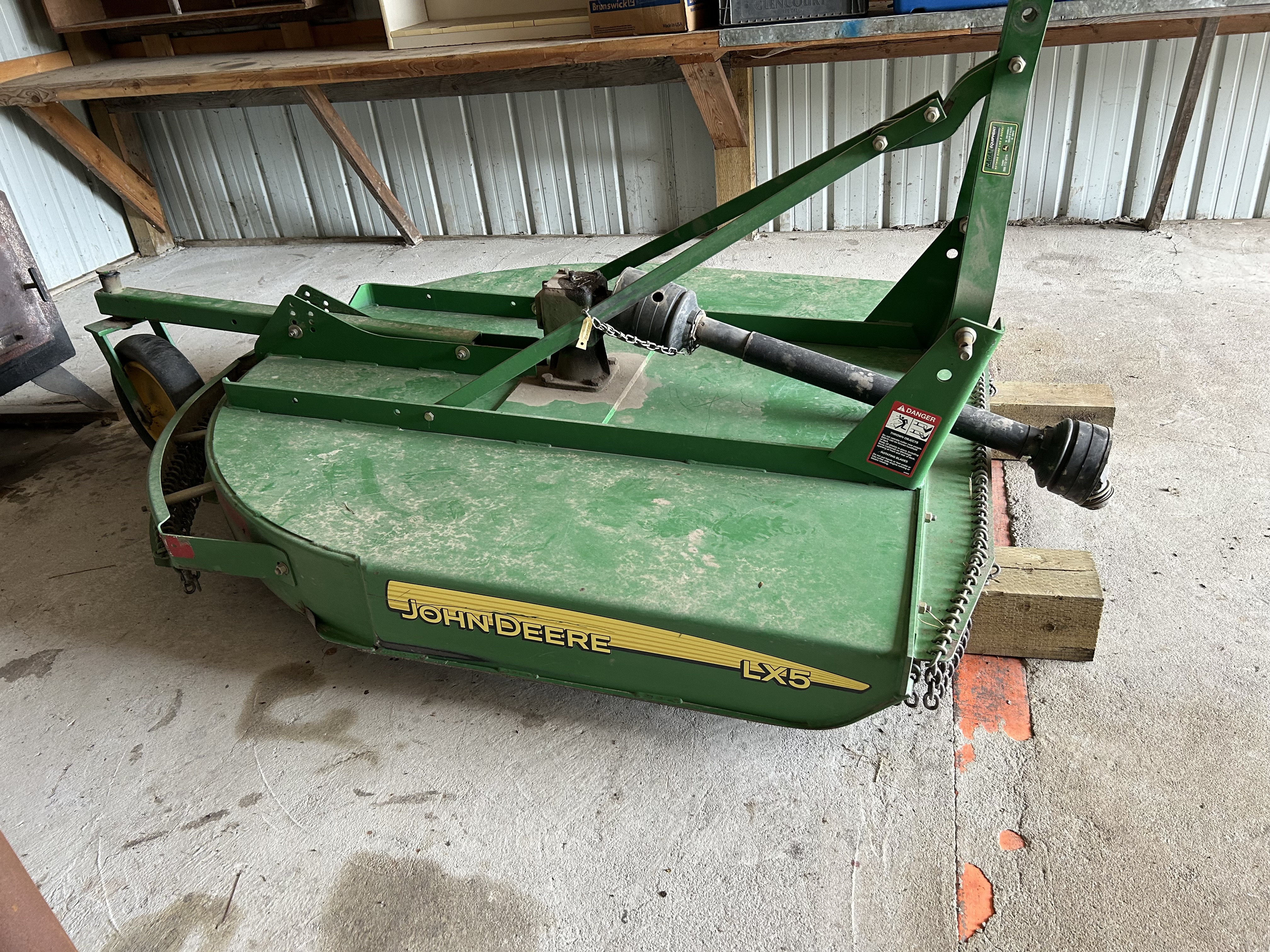

I have a John Deere LX-5 rotary cutter that I’ve used for 20 years. Mostly to mow fields of grass and weeds so not real heavy duty work. I don’t know what level of “duty” is is but I would guess it would be in the middle of this chart. JD had changed the model numbers. Here is a John Deere chart of their different level of cutter. And a pic of mine I took for insurance purposes as I left it up at the property. Not likely to be stolen but who knows?
https://www.deere.com/en/cutters-shredd ... y-cutters/

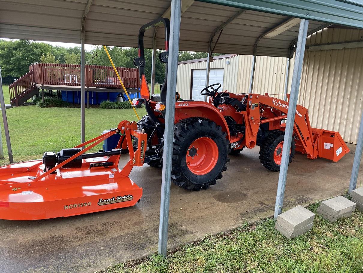

I'll try and get a picture of the modifications of OUR bush hog after it was upgraded by our mechanic, but this is the bush hog on the tractor when it was brand new. Note how small the gear box is on the deck. If you look at the very front of the skirting, you can see the leading edge of the skirt and see it's thin. I never claimed to know much about farms or farming, but I knew enough to know what we needed in the upgrade from the tractor we had:
I made sure we got a bucket, forks, bushhog, box blade...
I made sure the tractor had 4wd, locking rear diff, adequate power for the jobs we would do MOST of the time, but didn't over buy... (A mistake made ALL too often.) Our 2501 will handle 95% of the jobs, and is fuel efficient and the maintenance and parts are therefore much cheaper than if we had gone to a much bigger tractor that would have been too large to run the fence line, consumed much more fuel, and WOULDN'T have fit in the barn to scrape the mess out. :lol:

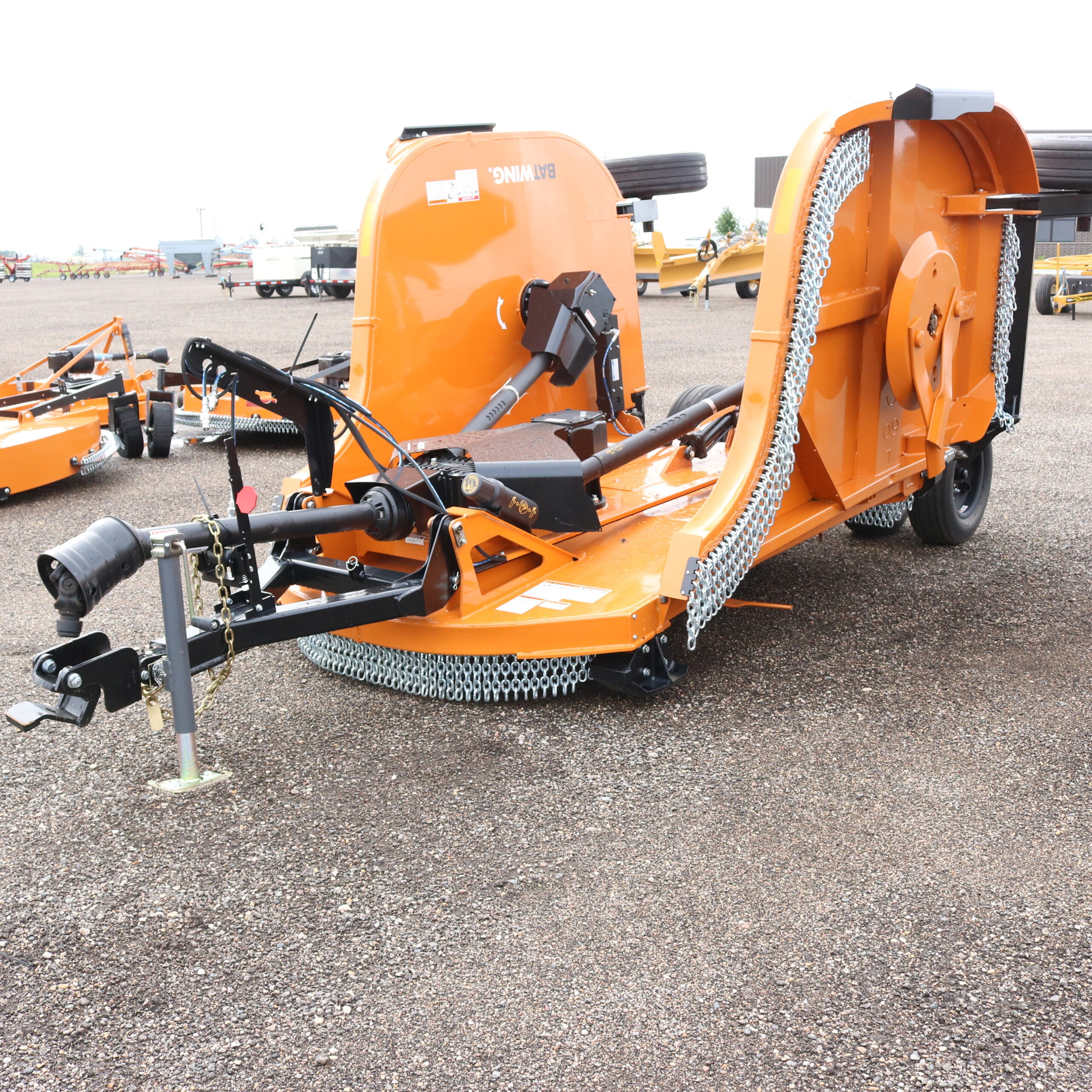

Posts: 7496
Re: 4 ft brush hog
Post by BrokenolMarine » Mon Sep 16, 2024 2:32 pm
I think most of the State Road departments use Bush Hogs, and what we see the most of here are the top of the line Bat Wing Bush hogs...
DOT bat wing cutter 31000 dollars new.jpg (1.41 MiB) Viewed 8471 times
The one above new runs $31,000. :o I was looking at them online trying to find a really good picture and they are up for sale used for $15,000 to $20,000. :roll: They are tough.
