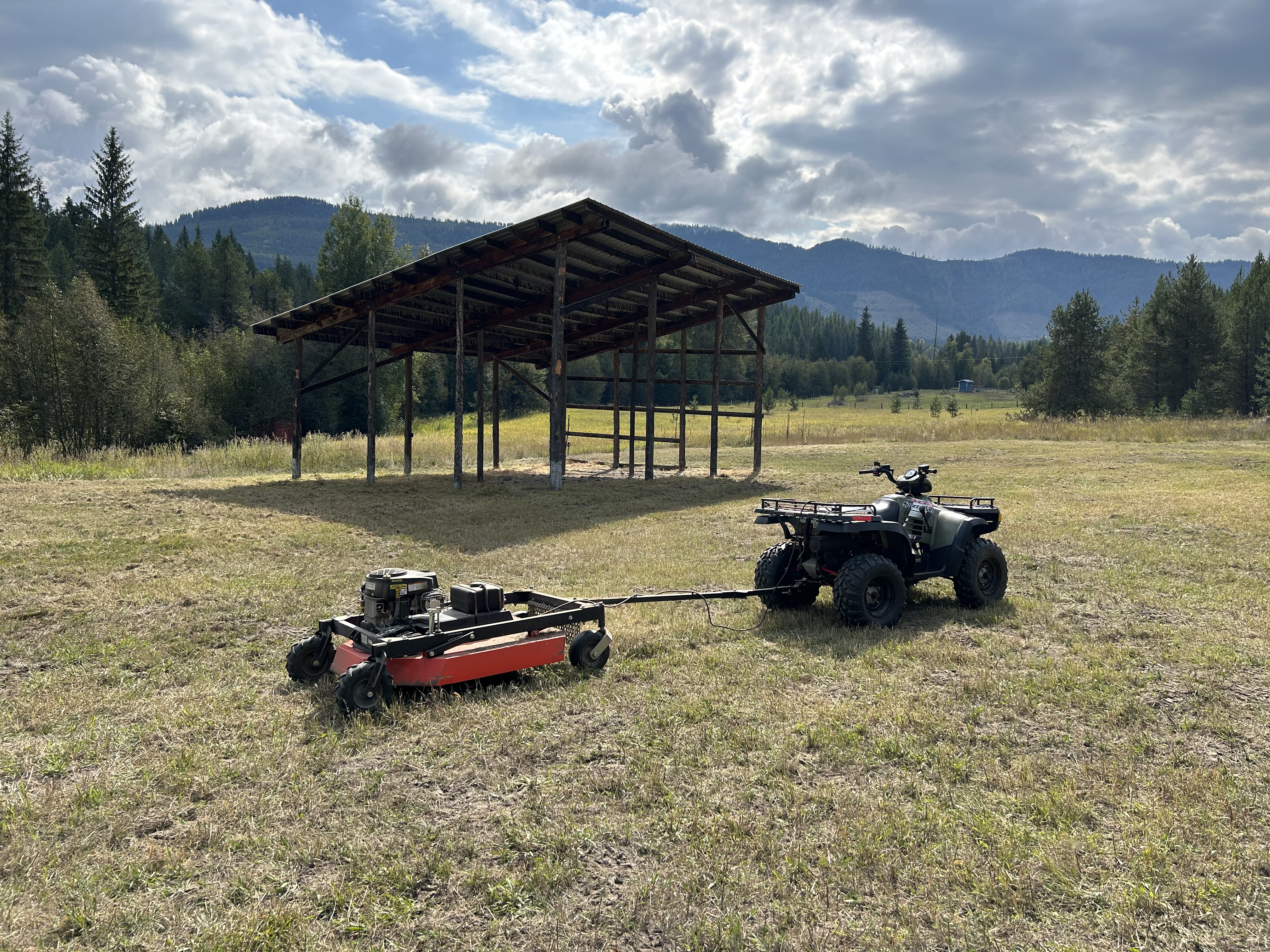

I have a very dependable 2004 Polaris Sportsman 400 that I have used for snow plowing, towing a 25 gal sprayer, towing a brush hog and many other hard uses. While it’s great for towing wheeled equipment I wonder if it would have the umph to tow an implement that contacts dirt such as the disc you mentioned. It’s been wonderfully dependable for the 20 years I have worked it hard. It’s currently retired from snow plowing but it still pulls the sprayer and the brush hog.

I agree with you about wheeled implements being easier to tow than a small chisel plow or a small set of discs although such implements are made for ATV's. I am trying to get a feel for minimum power needed to pull those.
By the way, you sure live in a beautiful area. Is that your view in the morning? Wow!
