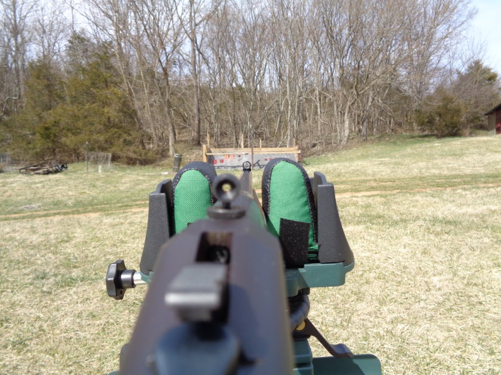

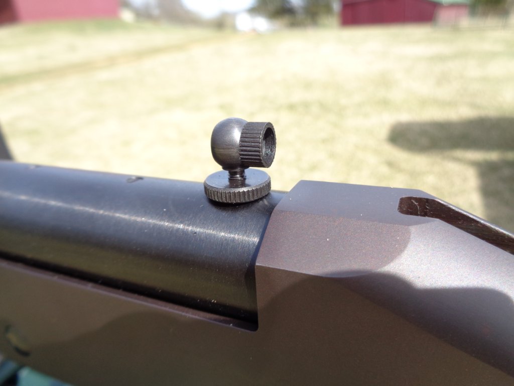

Here is a another option you may want to consider - Skinner Low-Pro on the rear with a Lyman Globe on the front:

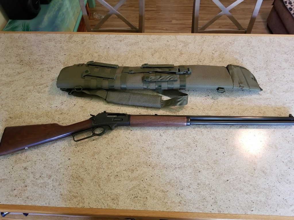

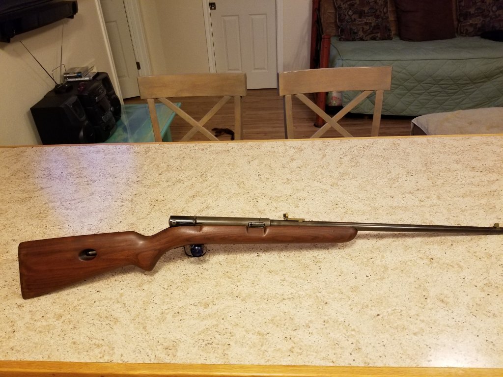

I have both styles, Express on 45/70 and barrel mount on 22 cal. Like them both.
