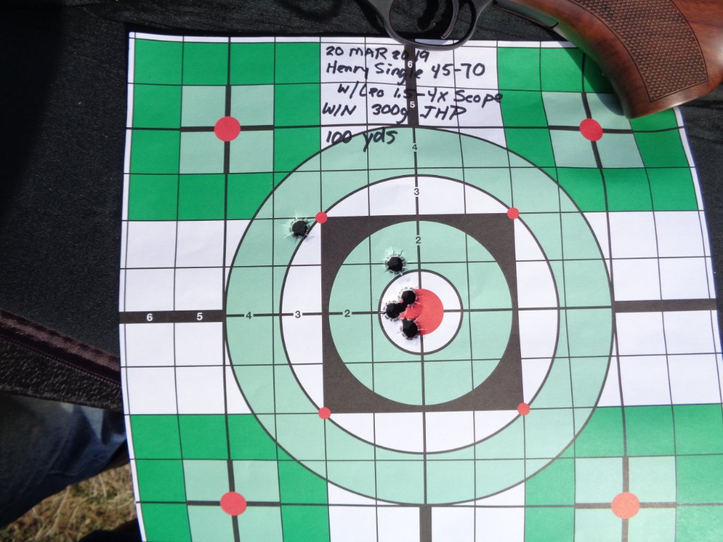

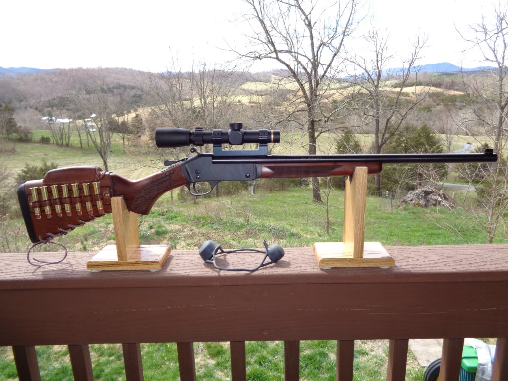

We have singles in 357Mag, 44Mag, and 45-70, so obviously, we really like them. A Henry single in any caliber is a short, handy, fun little rifle with excellent wood and craftsmanship for a very reasonable price - usually around $340. They do have their issues, though - a very heavy trigger out of the box, and the break-open no-receiver design can make scope mounting a little challenging (scope has to be high to clear the hammer, which makes it hard to get a good cheeck-weld). Below is a pic of our 45-70 set-up with a Leo 1X4 scope and Rick Lowe cheek riser. We also have done the "Grainger Spring Mod" to all three of our Henry singles. Overall great rifle for the money - I think they would be excellent in the field for taking deer.
Henry Single 4570 (3).JPG (184.82 KiB) Viewed 7871 times
Henry Single 45-70 Sight-in @ 100yds.JPG (147.13 KiB) Viewed 7871 times
