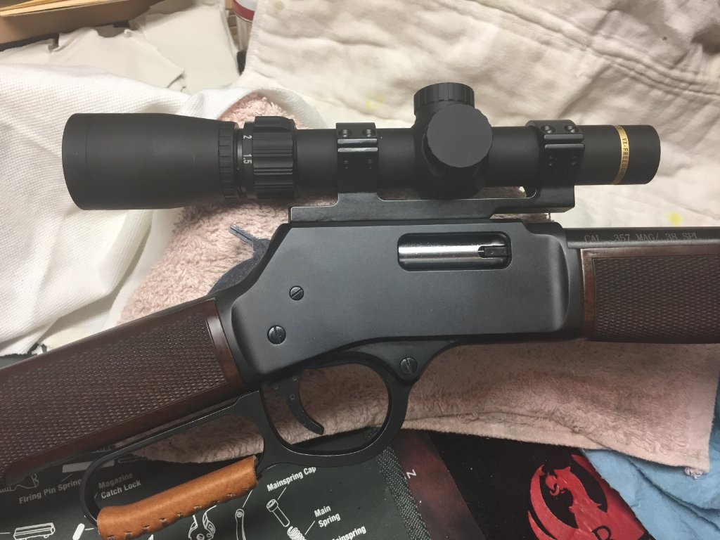

Brother_Love wrote:I used the Warne base and I had to remove the rear sight. It was easy to drift out with a brass punch. I wanted my scope as low as I could get it. I’m using a 3-9 but might go to a 1-5 to get it even lower.
Leupold VX Freedom 1.5-4X24 can get really low. Put that on my BBS and it's worked out well. These are the Talley Rail/Ring set-up, so not as low as it CAN be, but not bad...
Henry BBS 357 w Scope Aug 15 2018 001.JPG (136.84 KiB) Viewed 6121 times
