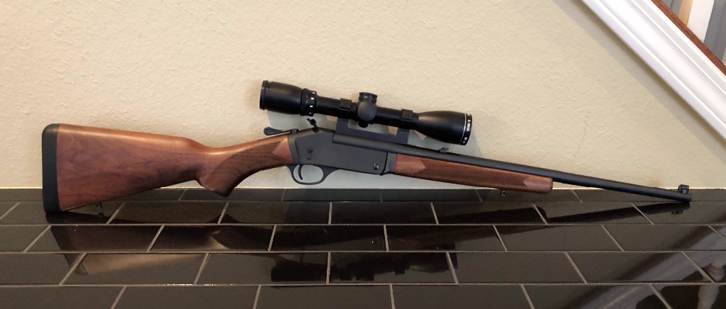

Post by ScottCard » Sun Jan 20, 2019 12:31 am

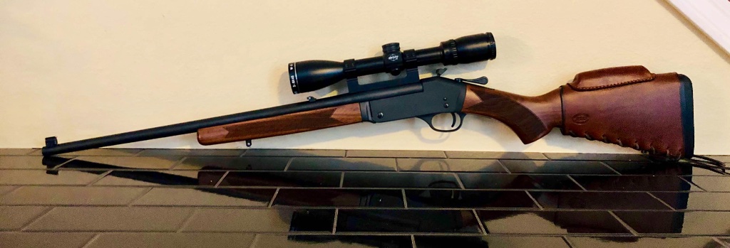

I picked up the 30-30 single shot a little over a week ago. I installed the Talley single piece rail with rings using a Swift 3-9x40 I took off another rifle that I decided to revert back to open sights. I also installed a Grovetec hammer extension I found in my safe. I will also install some sort of cheek riser as the scope sits a little too high.
This is going to be my deer rifle for use in the woods. It really seems to be a nice rifle for the price. My only complaint is the heavy trigger pull at 7-8 lbs on my gauge. It breaks pretty nice though with no slop. If the weather permits I may be able to sight it in tomorrow. :mrgreen:

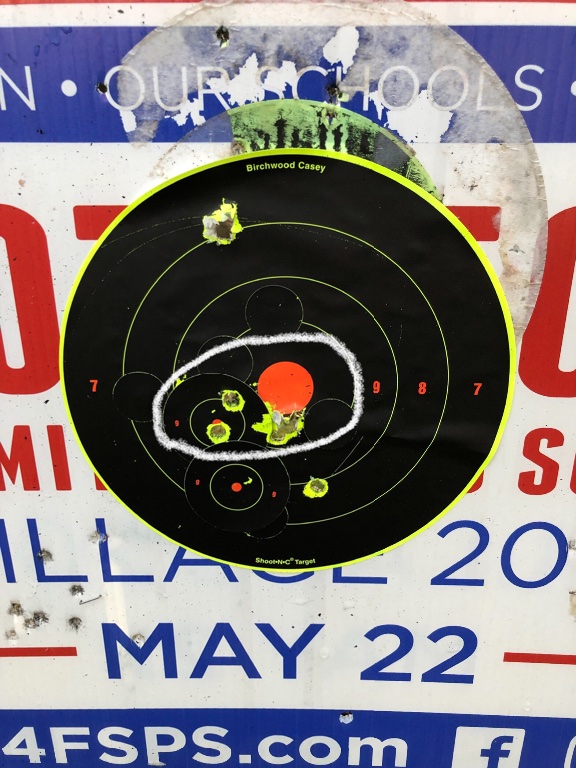

Post by ScottCard » Mon Jan 21, 2019 12:06 am
Thanks for the warm welcome back!
I did manage to do a little shooting today. It was a bit of a struggle since the scope was a bit too high and my bore sight tool had dead batteries. Oh well, that just meant more shooting!
I shot Winchester soft point 150 Gr soft points until I was reasonably sighted in at 25 yards, then went to LeveRevolution 140 Gr and 160 Gr. I ended up shooting about 20 rounds total. My last four shots are circled in white on the attached target, and were shot at 50 yards with the LeveRevolution 160 Gr cartridges. About a 1.5” group. The first two shots were the ones touching and the last two I pulled to the left a bit. Shots were fired off shooting bags.
The rifle is nice and the potential for nice groups is there. The trigger is heavier than I would like but with practice I expect I can improve my marksmanship with it. I think I can definitely get to 2 moa with it, probably better, and that will certainly work for my intended use of it as a woods rifle for deer hunting out to 75-80 yards.

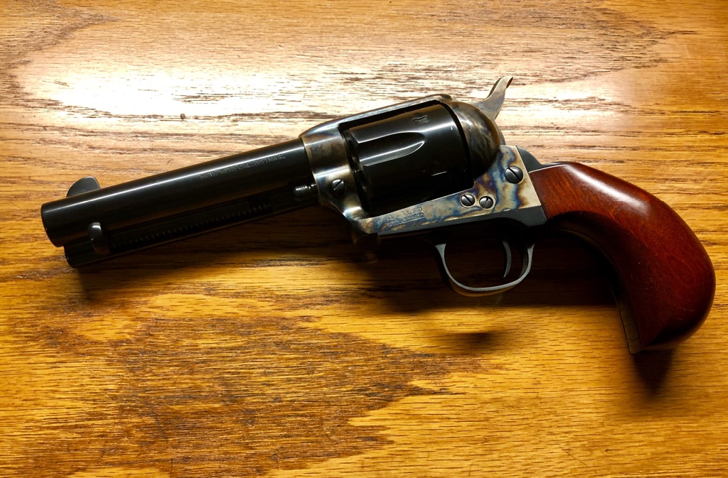

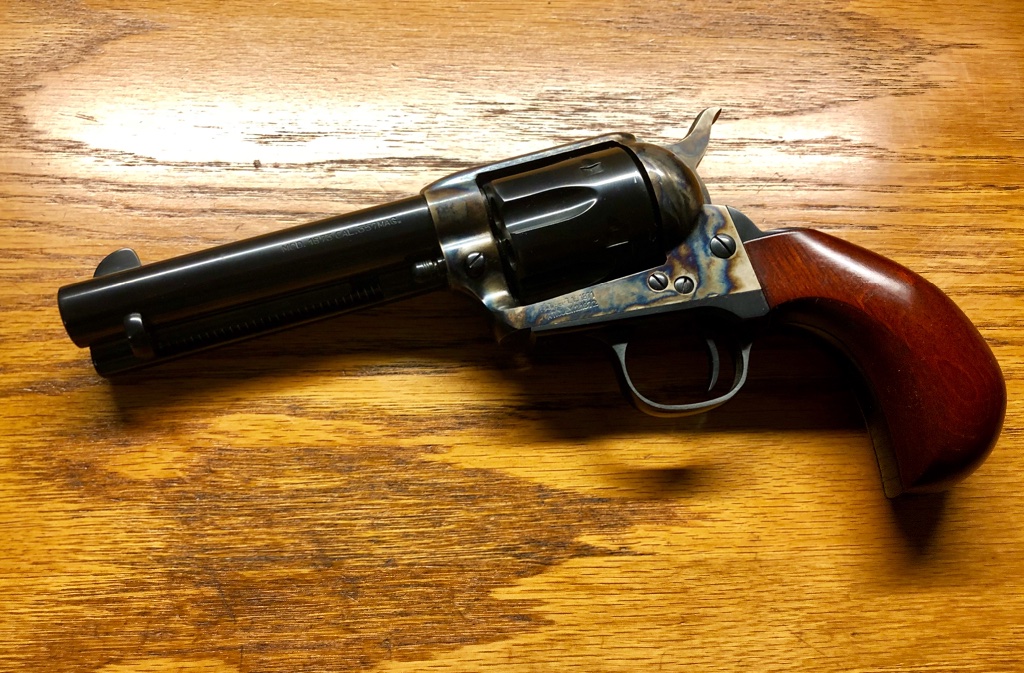

I also fired my first shots from my recently acquired Uberti 1873 Cattleman Birdshead 357 4.75”. It’s a pretty nice SA for the money. The finish isn’t A+ but the workmanship seems pretty doggone good.

On your revolver. I had the exact same Uberti SA model you have, only in .45LC. Totally agree with your eval of workmanship: ..."the workmanship seems pretty doggone good." And the Birdshead is very comfortable to shoot also.

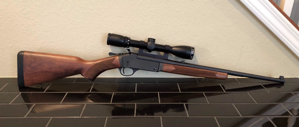

Post by ScottCard » Fri Jan 25, 2019 8:11 pm

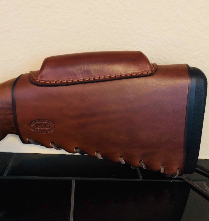

I had a goody arrive today. It is a leather stock cover with cheek riser from Rick Lowe Custom Leather. Now I can get a good cheek weld! 8-)

Post by ScottCard » Fri Jan 25, 2019 8:14 pm
One more pic...

ScottCard wrote:I had a goody arrive today. It is a leather stock cover with cheek riser from Rick Lowe Custom Leather. Now I can get a good cheek weld! 8-)
That's a beauty of a riser! I had to put one on my BBS 357 once I scoped it, but it isn't nearly that snazzy. Will have to check out Rick Lowe Custom Leather! Thanks for the pic!

A lot of Rick's products are sold through Brass Stacker. So check them out too.

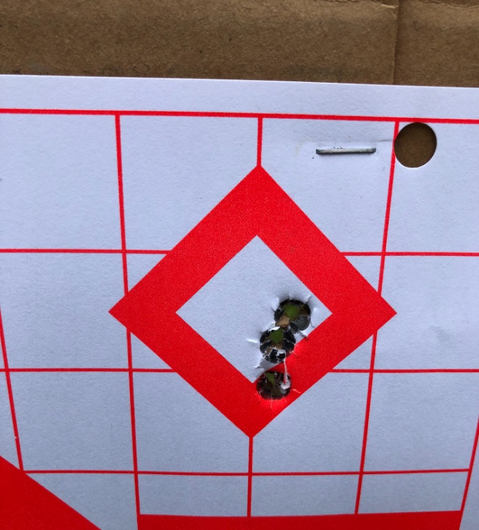

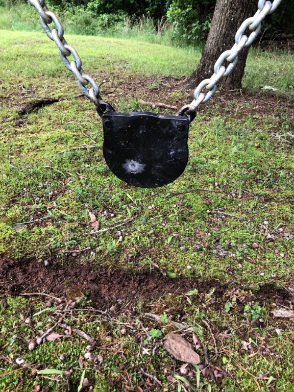

Post by ScottCard » Sat May 11, 2019 10:20 pm
I was able to get some more shooting in yesterday. This rifle really likes Hornady Leverevolution 160 grain ammo. I was able to get my Swift 3-9x zeroed at 50 yards which should keep within 1.75” out to 125 yards according to the ballistic calculator I used. That will more than suffice as my deer hunting property only provides shots out to about 90 yards.
Here is my final 3 shot group at 50 yards shooting with the forearm supported on a shooting bag. I knew I pulled the third shot down a tad. I didn’t measure but that looks like a .75” group so 1.5 MOA and capable of better. I’m not a great marksman so I’ll take that! I took one shot at my 6” rifle gong from 105 yards...pulled it a little left but again I’ll take that.
The trigger is really nice now. Wall, break. Just how I want it. Pics because it did happen! :mrgreen:
