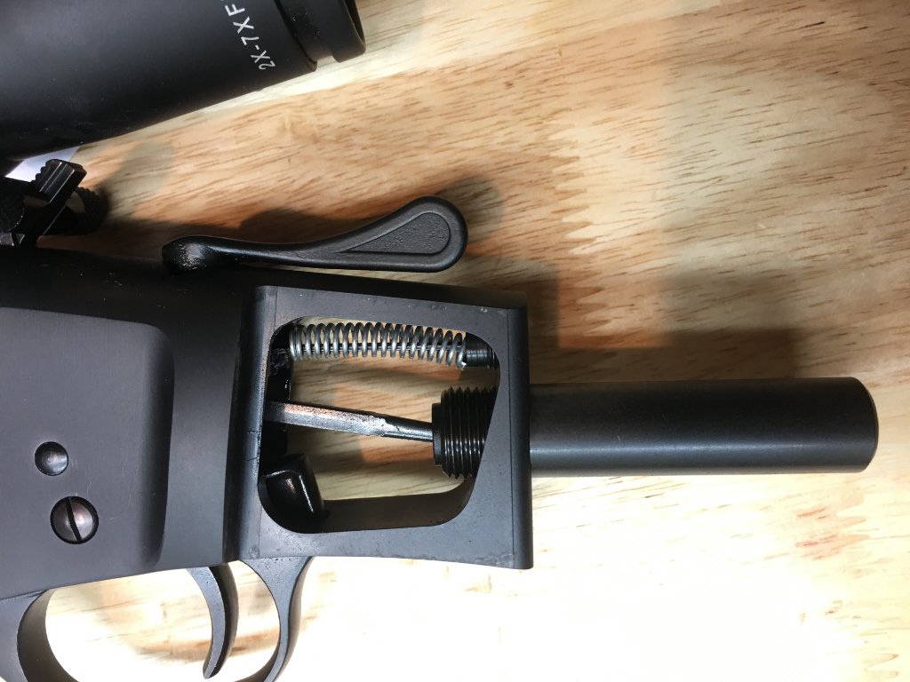

I got the springs today from Grainger so I went downstairs and made the change to my gun. I take no responsibility for the modification in any way. I didnt discover it and take no credit for the leg work it took to find this out. Im merely passing on info to those here who own a single shot. Its a very easy mod and if I can do it anyone can. Im no engineer or gunsmith. I can see from looking at how this is done that it could have been done different perhaps with better results. First picture shows removing the butt pad. There is 2 phillips head screws in the holes at the pad. Remove those screws.
Next photo shows removal of the stock there is a 3/16 allen bolt in the very center remove that . You will need a long allen head wrench or a changeable tip screwdriver which is what I used.

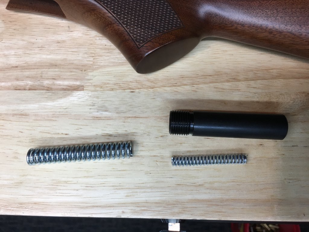

Next you will unscrew the spring tube. That allen head bolt you just removed screws into the base of it. You will also see the hammer arm that fits into a recessed sleeve that presses into the front of that tube. That sleeve sits on top of the spring you are about to change. There is no parts here that are going to leap out at you are catapult across the room. Next picture shows the springs. There is a little spring inside the big spring. The big spring is the one you want to change. Just take it out drop in the new big spring and put the small spring back inside of it. Then screw the tube back into place. There will be a small amount of resistance but not a big deal. Next picture shows the spring tube and the last picture shows the springs.
When done replacing spring tube reassemble the stock and pad. I thought in made a nice improvement on the hammer pull and the trigger pull. Mine is definitely better. Im not sure why one would use one spring inside of another to me. Seems like there could be some binding there with the two springs. I will leave that though to the designers to figure out another system. Right now I like the 357 Single Shot. It might have some issues that need addressed but for what you pay for them I think there a pretty good deal.

I'd guess that the 2nd spring is needed to launch the hammer with harder force against the firing pin. Maybe get light strikes without it.

I'm speculating on this, too. I'm thinking that the double spring is required for the rebounding hammer design, a weaker spring to keep the hammer from the firing pin, and a stronger one to overcome it when you cock the hammer, and pull the trigger to trip the sear to fire. Looking at the parts diagram in the manual, they simply show "hammer springs", parts 50a and 50b, part 51 is the hammer spring piston, which must be out of sight in the photos, remaining on the hammer spring guide. This little project sure looks doable to me, no worse than pulling the stock on a SxS shotgun to clean and lube :) . Thanks for putting it up, BigAl.
