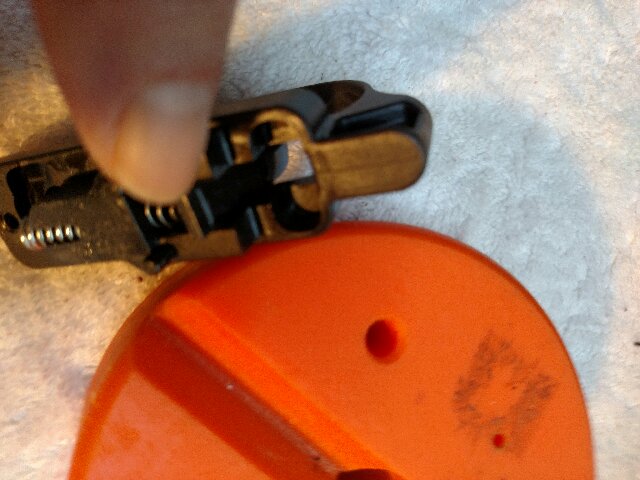

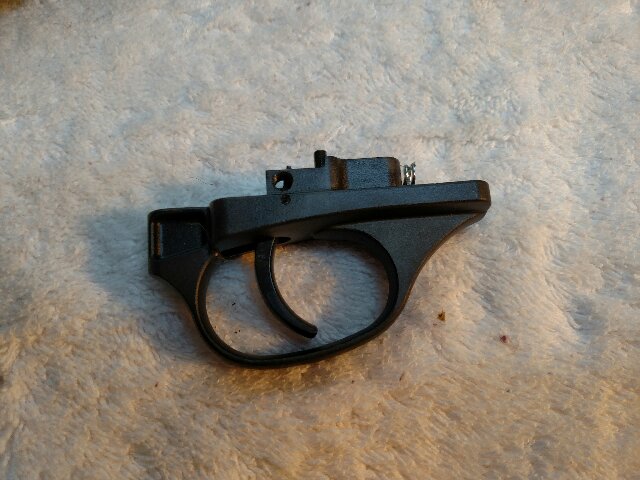

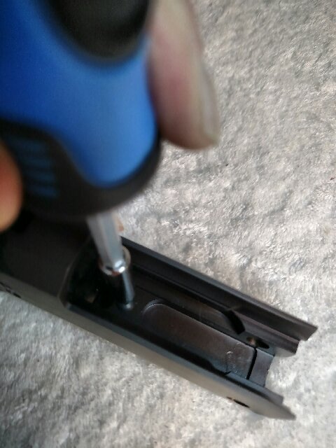

Did a little more on the trigger and took some photos. Hopefully they load in the correct order.

Third is the Allen screw inside the receiver. It is a 3/32.
Fourth is the trigger assembly. It should come right out if you pull it. There is a spring on the front that should stay in place.

The last one points to the "ledge" on the hammer. Polish this with the 600 grit. I got it shiny, and didn't change the angle or really take anything off.
With this last bit of work, the trigger is between 3 3/4# and 4#. So, will be happy and leave it there. Rifle season starts for us on Oct 11.
