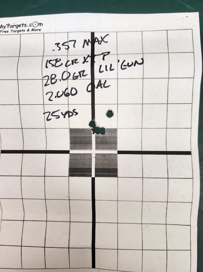

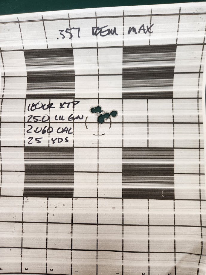

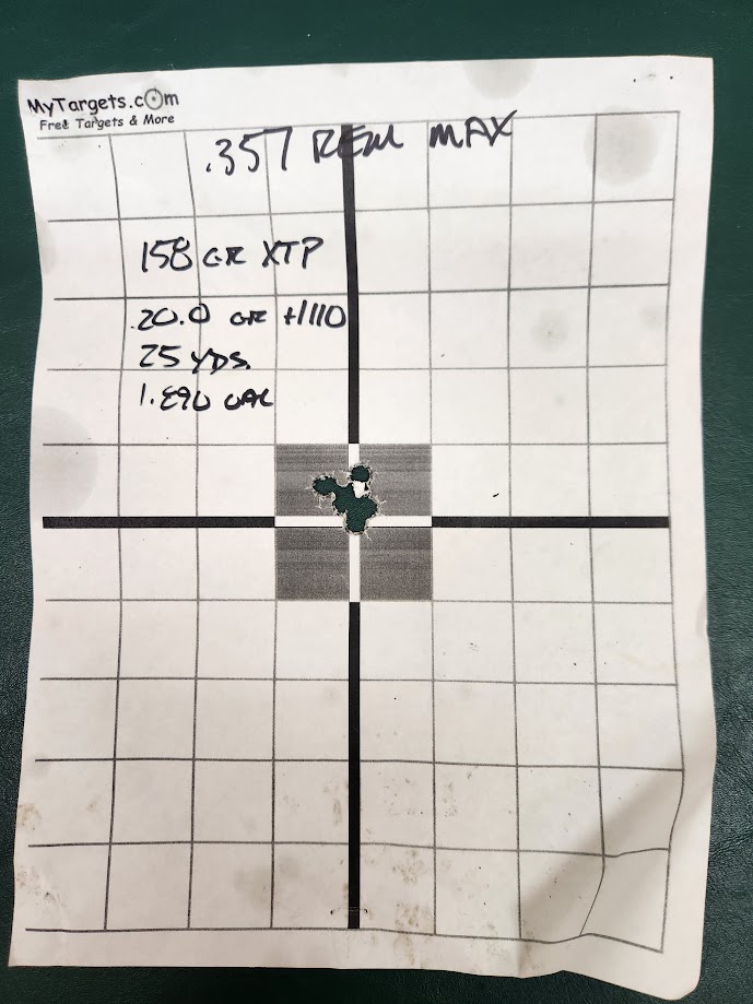

Working up some loads:

Working up some loads: 180grainMaxLilGun.jpg158grainmaxH110.jpg
Holey Schmoley, that's one hot load! I load 6 grains less Lil Gun for my 158 XTP FP and that is a stout load for .357 Mag. The rifle sure likes it though.
I'd be interested to see what that does at a little further distance, and if you hunt, how that works on game.

Going to try 28 grains of Lil'Gun under the 158 XTP. Once I find something I like, will try at 100 yards. Plan on using it this upcoming deer season.

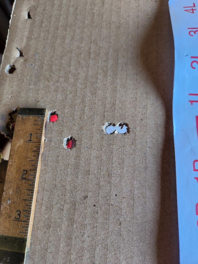

158 Grain Hornady XTP w/ 28.0 gr Lil' Gun (wanked the last shot to the upper right)

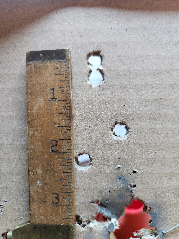

100 yard test w/ 158 Grain XTP w/ 28.0 gr Lil'Gun ( group was ~2 inches X ~1 inch)
10 shot average muzzle velocity 2488

docscott wrote:
Tue Aug 13, 2024 8:06 pm
WOW
You're knocking on the 2500 door with the 158, that is a whole lot of knockdown power.
And you're still getting great groups.
