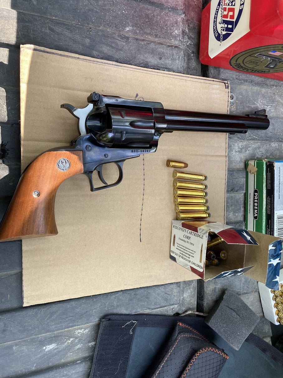

357 Max ammo can be purchased. A friend online gave me a source and I bought two boxes. It's a kicker to shoot. But NOT cheap. I asked Miss Tina if she wanted to try and after taking this picture she ... passed. :twisted:

Really, in the Super Blackhawk, the recoil isn't THAT bad... :roll:
357 maximum.jpg (514.96 KiB) Viewed 11762 times

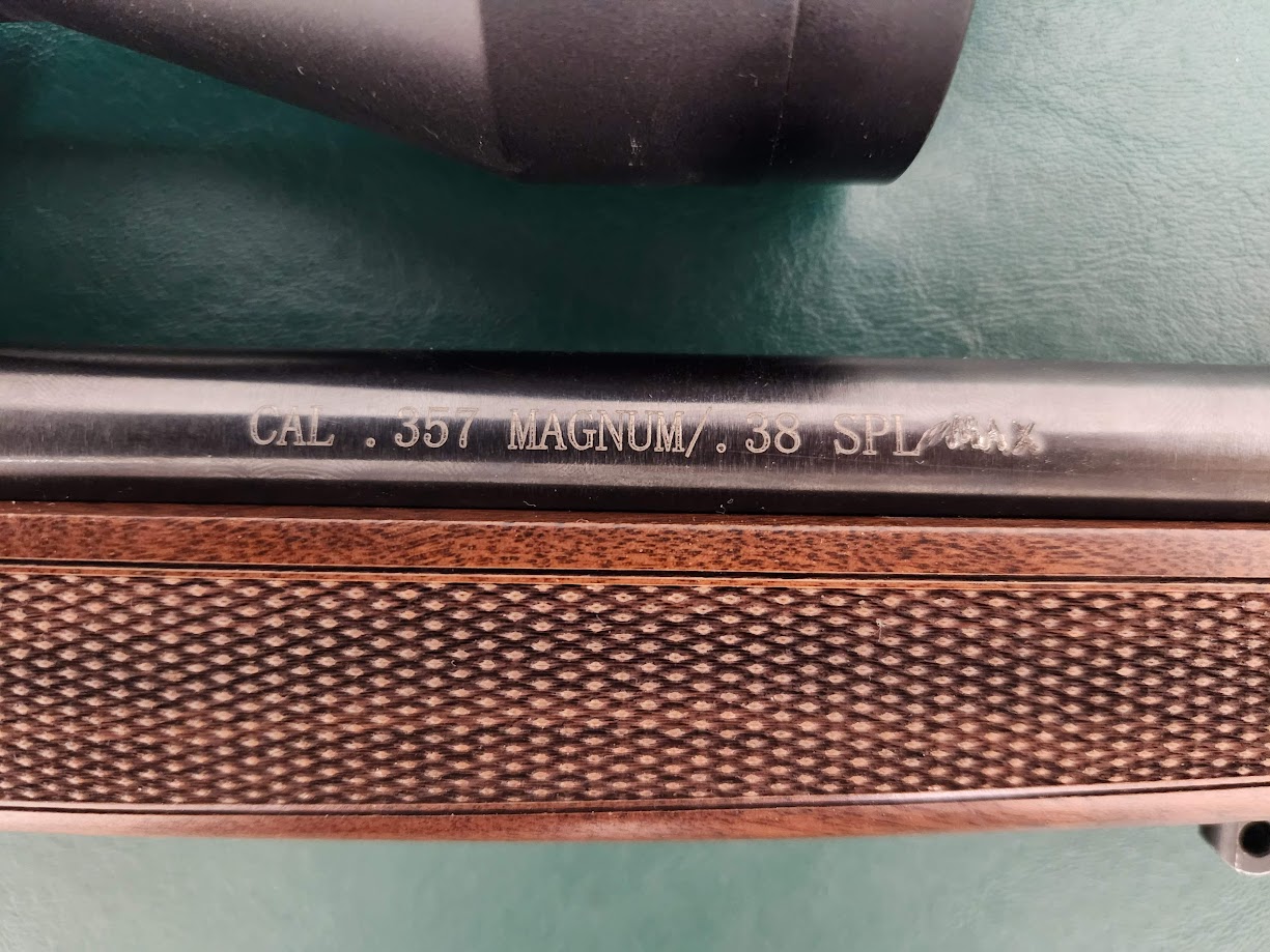

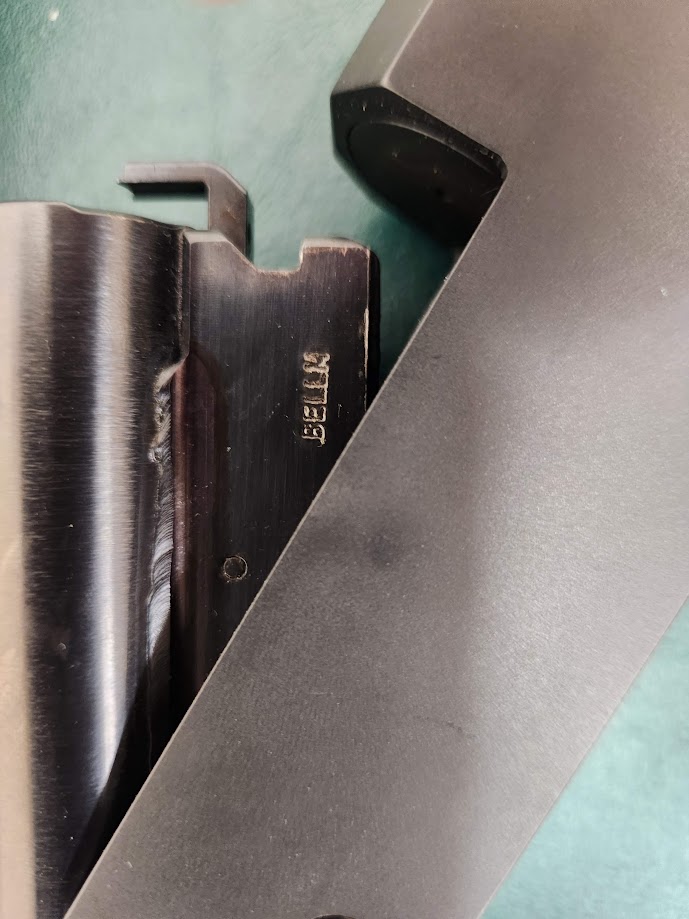

Post by docscott » Thu Jun 27, 2024 6:16 pm
Got my barrel back today. Put on scope. Have not shot it yet.
