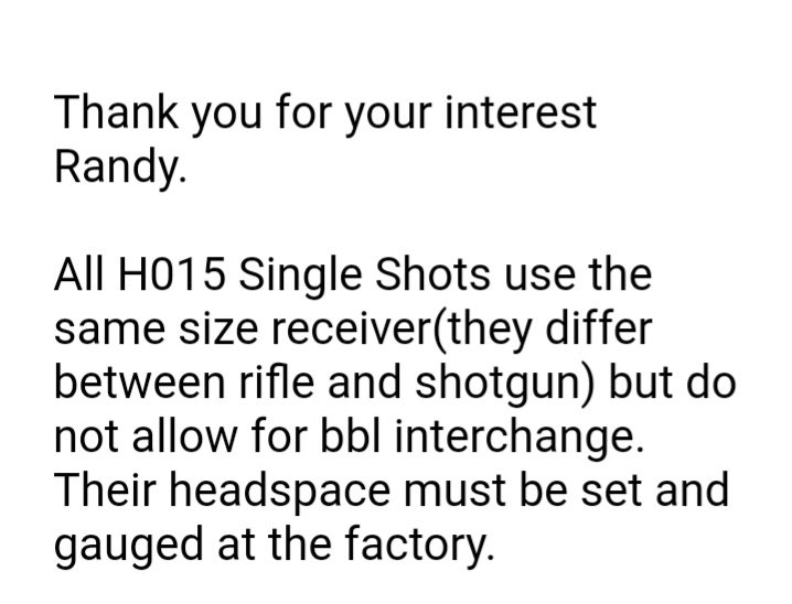

This came to me as I look at a few of the recent SS rifle threads.
Does anyone know if the receivers of the pistol cal. and rifle cal. are different, or the same?
Can they handle the same pressures?

Per the Henry tech. Rep.

That they are Tom, I actually have a pair 444's, a Sporter Safety, and a P.
Was lookin at the Henry SS and noticed it comes with a 1:20 twist... which would be great for a 300gr+ cast.
Just lengthen the chamber a wee bit and well there ya go.
If it's the same receiver, then the pressure should be no issue.
