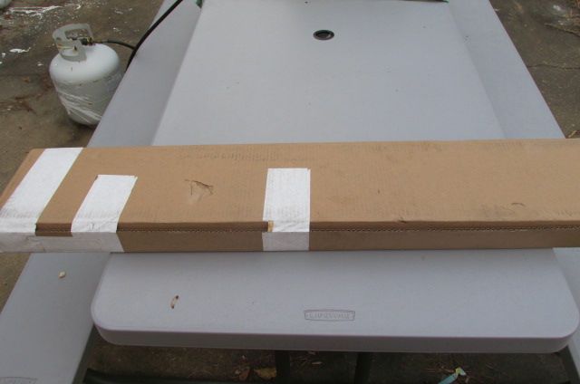

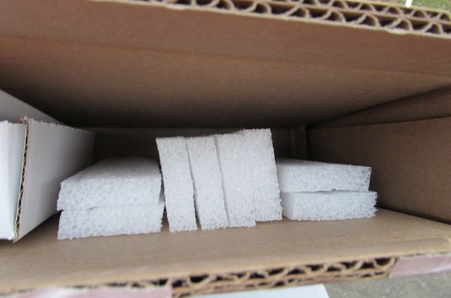

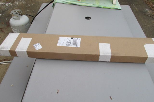

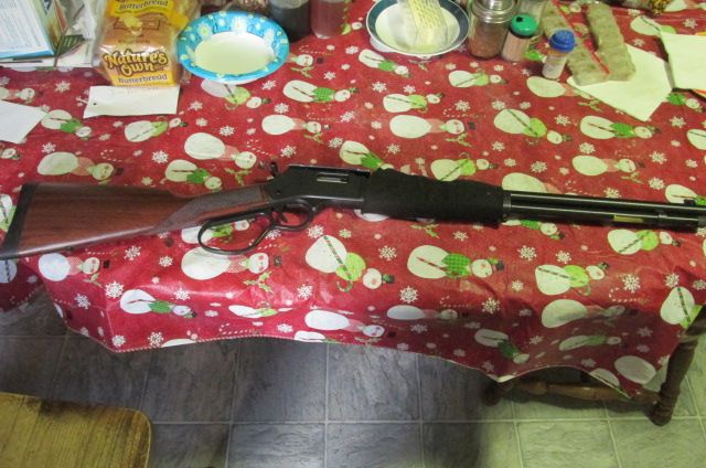

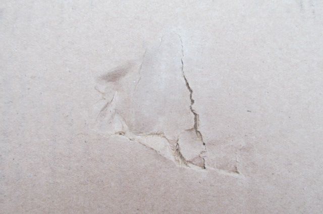

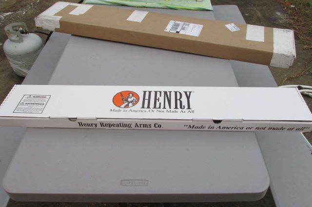

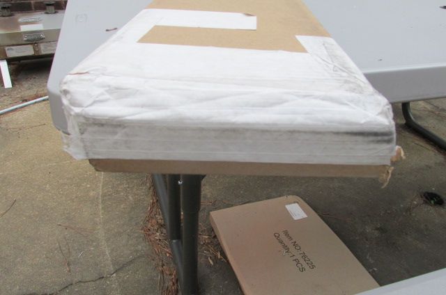

one of our Henry rifles arrived back home today .... it was shipped to us in the boxes below .... one impact point can be seen on the heavy cardboard outer box ... no sign of that impact reaching the inner Henry box .... as can be seen, they also use sections of foam insulation to fill space

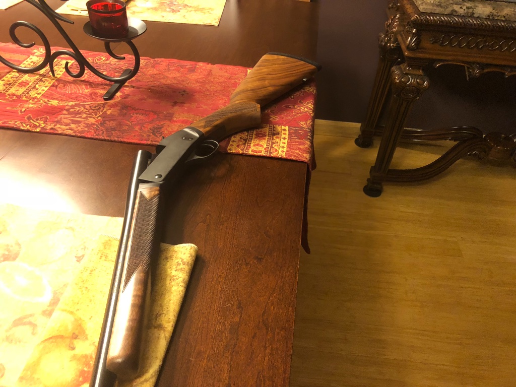

I can truly say that the way of shipping is not the cause. I have been having issues since August. Well before the holiday season. My 30-30 had a 3” crack with the box being in perfect condition. My 45-70 and 44 and 20 gauge was perfect out of box but the stock got loose during the first 25-50 shots. Henry replaced the loose stocks and my 44 cracked at the range after 100 through it. Henry replaced my 44 stock again and when I opened the box from Henry warranty repair the new stock was already cracked. The same with my 20 gauge. My 45-70 and 30-30 was just shipped back to me from Henry warranty repair so I should get them this week. I also have a 12 gauge but I haven’t shot it yet. Anthony Imperato emailed me and said he has his VP and head engineer working on this issue. All I’m doing is just shooting Winchester white box through these rifles and they are cracking even with pistol caliber rounds. When a 44 Mag Winchester white box cracks a rifle stock, something is seriously wrong. When a new stock can’t survive 2 days shipping without cracking in an undammaged box, something is seriously wrong. These pics are from a new stock when I opened the box from Henry warranty repair. The box and wrapping was in perfect shape.

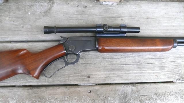

Just from that pic, I can see one potential problem. Note the direction of the grain in that wrist area. In my years of collecting Marlin and Winchester lever guns, I would now and then come across a gun with a crack in the wrist of the stock where the butt stock attached to the receiver. Not often, mind you, but often enough to see a pattern. It has since become a red flag area for me when looking at a used lever gun or other gun with two-piece stock.
We all love curl and figure in our walnut stocks, but one place you never want that is in the wrist of the stock and this goes double for guns with two piece stocks. A proper piece of walnut for a butt stock should have grain that is straight as an arrow in the wrist of the stock. This is the strongest possible configuration for this high stress area. The grain should never run crosswise in the wrist, only in line with the wrist. Stocks need to be chosen, carefully, for this feature and stocks that have too much curl or are less than straight grained in the wrist should be rejected. More than that, such a section of wood should not have been cut into a butt stock.
Here's an example of a wrist with proper grain. It's on my 1946 vintage Marlin 39A. Will probably last another 70 years without cracking.
Same for this even older WW II vintage Winchester Model 61 butt stock.
Another source of stocks cracking is wood that has been improperly dried and is still green. I have seen this happen more and more on current production guns as manufacturers try to rush things for the sake of keeping up with production. It takes a long time to properly dry a piece of wood before you start cutting. A green stock will change shape as it dries. You'll often see this in a change of bedding or an action with screws that mysteriously work loose. In severe cases, the stock will crack as it dries, on its own, without being used. Has happened to me.
Now, before everyone breaks out the flamethrowers, I am not pointing fingers at Henry. I'm just sharing something I've learned when buying old and new guns. When buying that Henry, do yourself a favor and DO check the wrist area on the stock. Don't be blinded by that beautiful curl and figure and, yes, I love that Henry uses such beautiful walnut in their stocks. Remember, that plain jane straight grained stock may not win any beauty prizes, but it will be the strongest.
