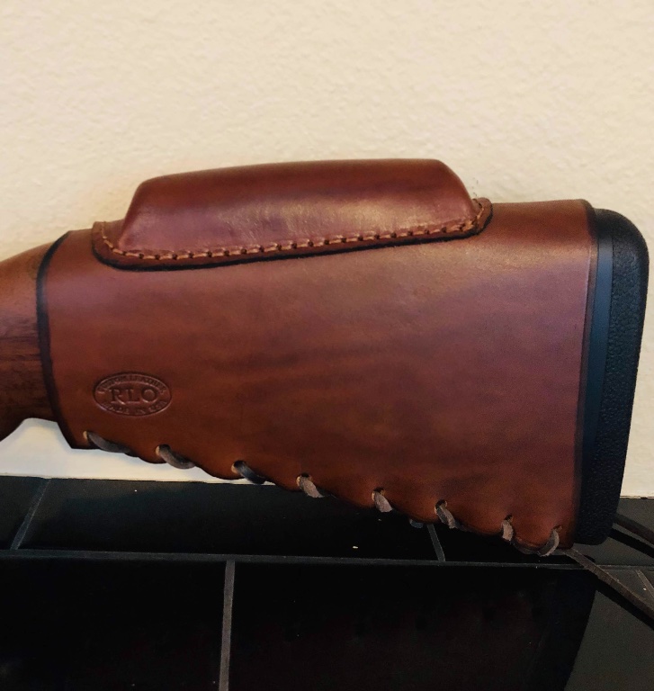

I had a goody arrive today. It is a leather stock cover with cheek riser from Rick Lowe Custom Leather. Now I can get a good cheek weld!

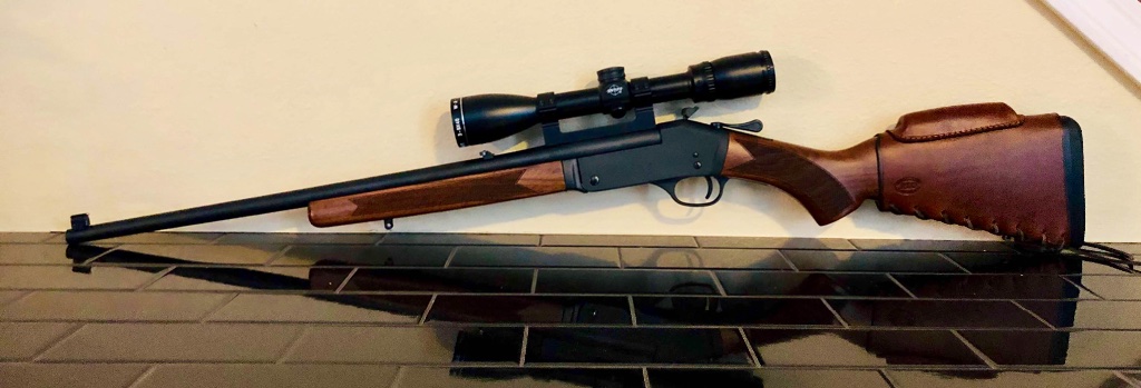

One more pic...

That's a beauty of a riser! I had to put one on my BBS 357 once I scoped it, but it isn't nearly that snazzy. Will have to check out Rick Lowe Custom Leather! Thanks for the pic!ScottCard wrote:I had a goody arrive today. It is a leather stock cover with cheek riser from Rick Lowe Custom Leather. Now I can get a good cheek weld!
