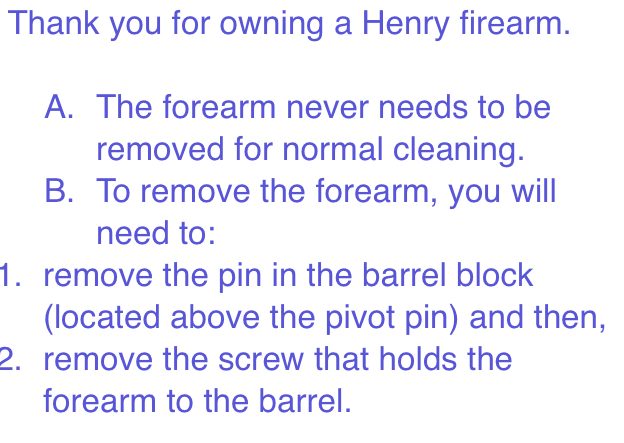

Post by brianpa » Mon May 14, 2018 7:01 pm
This is what they tell me. Don’t seem to difficult

Re: cleaning the single shot
Post by brianpa » Mon May 14, 2018 8:23 pm
OK I took the forearm off and it was not that big of a deal BUT they did not mention that there is a spring and detent ball in there. still not difficult as long as you have the right size punches and a regular gun Philips screw driver and a small gun smith hammer. I would not do this on a regular basis only when you've been in the rain and want to oil it under there or every five or ten yrs. to clean out dirt or what ever.
The pin is the one between the pivot pin and the forearm not the one closes to the chamber.
