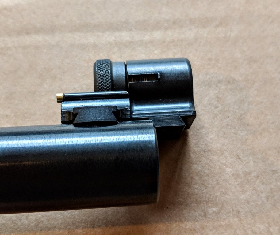

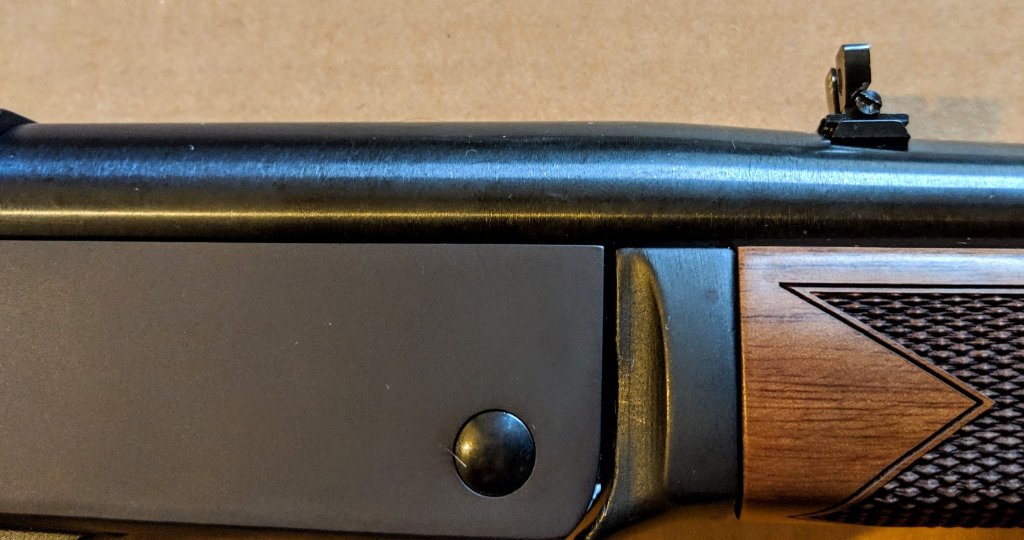

Pondering a Skinner receiver mounted aperture sight for my Henry SS-357. Will have to get something taller up front, since the receiver sight will sit higher than the factory buckhorn that sits on the tapering portion of the barrel:

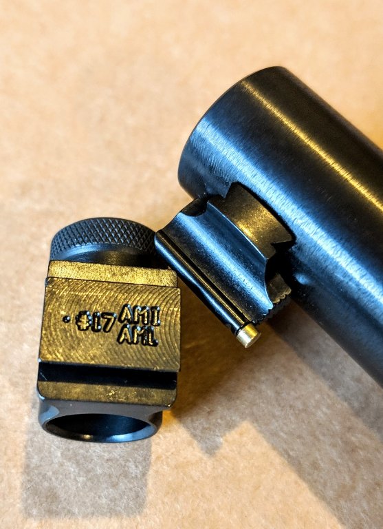

Skinner sells a ramp that will raise the factory buckhorn sight, so was leaning that direction. Then this little gem came in the mail:
IMG_20190227_161838 - Edited.jpg (91.67 KiB) Viewed 5843 times

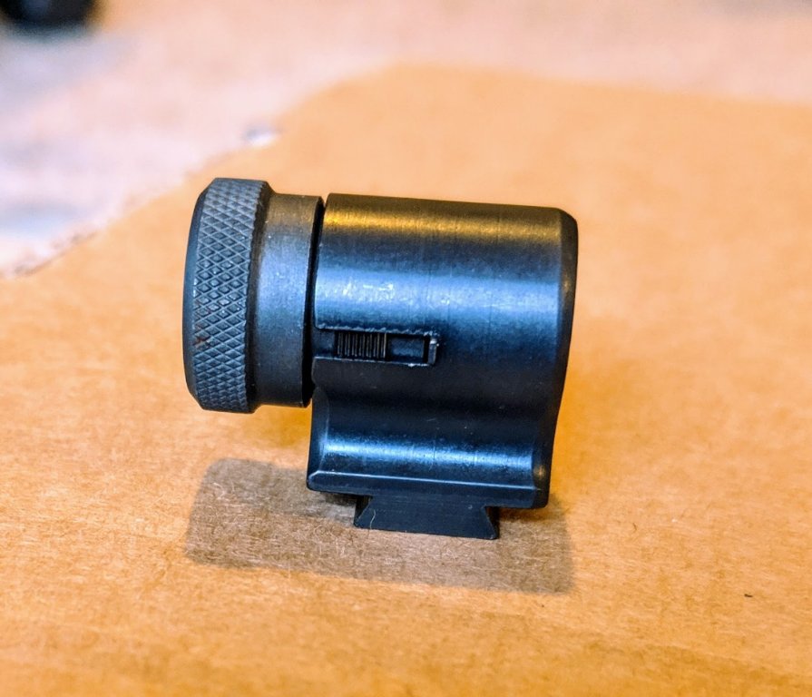

It's a Lyman 17AML that I ordered to replace the broken front sight post on a Mossberg 44US(c). Wheels started turning when I took it out of the package, wondering if it might also work on the Henry with the Skinner receiver sight. The dovetail is correct, and it does look like it'll sit higher than the factory front:

Going to press on & order the Skinner. Will leave the Lyman off the Mossberg until then, & try it on the Henry first. Will report back with results.
Lyman also makes a taller version (17ATC). It's quite a bit taller, so I'm hoping it doesn't end up that the AML is too short & the ATC too tall. May just have to go with the ramp/factory front if that's how it works out.

Thanks for that info ESquared, this one appears to be marked both AMI & AML if my eyes are seeing this right:
IMG_20190227_161856 - Edited.jpg (86.79 KiB) Viewed 5830 times
More I look at it though, don't think it's going to be quite high enough.
