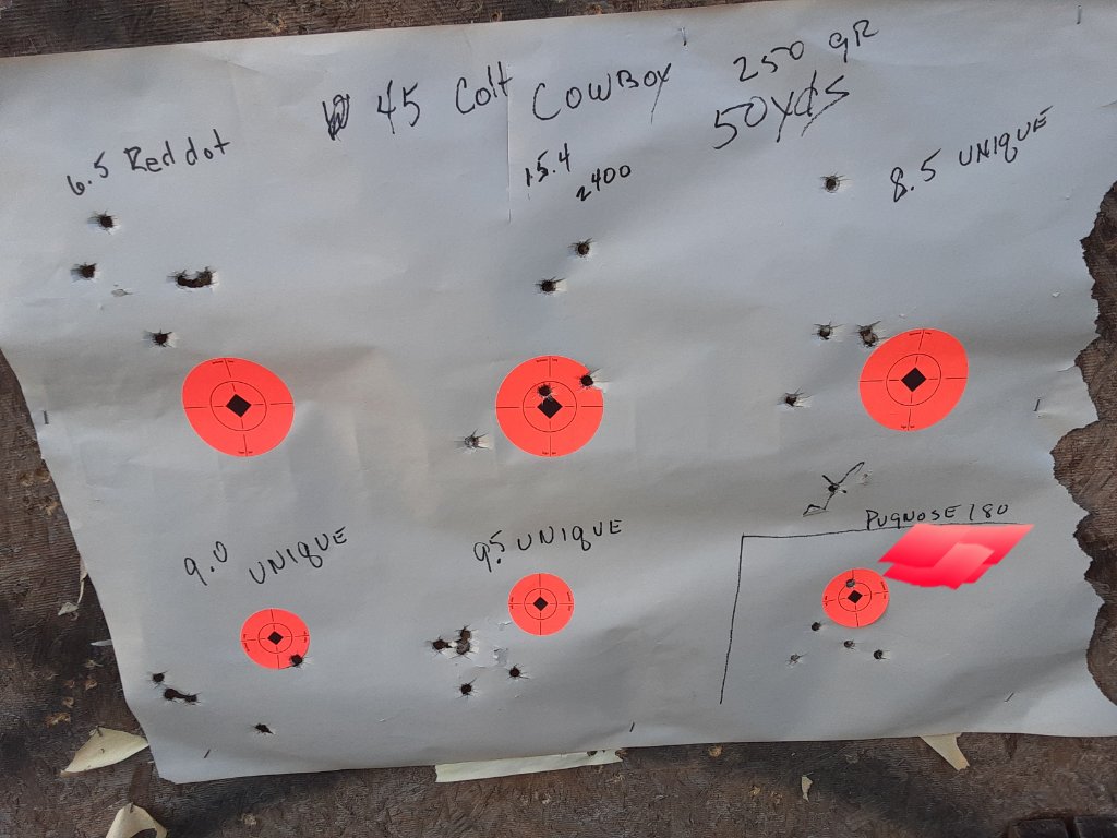

Made it home in time to try out some more 45's.
5 shot groups, at 50yds.
Played with the Rossi and the Pugnose's in between.
EDIT:(in a previous pic I wrote the wrong load on the target, but with the sharp eyes of members/friends here I am correcting that) 11.4 of 2400 and the Pugnose 357. I do apologize .
RR would have been proud, doing the one knee I was ringing that 10" at roughly 70yds.

Post by fortyshooter » Fri Feb 14, 2020 7:22 pm
That 9.5 Unique seems to keep all of them in a nice cluster. Now the Pugs...was that 9.4 of 2400 in the 357 mag case?

Post by Vaquero » Fri Feb 14, 2020 7:34 pm
Sorry forty, 11.4, but I didn't take as much time with them like I did with the 45's.

Post by Rifletom » Fri Feb 14, 2020 9:02 pm
Randy, I'm with forty here. "9.4gr Unique/180gr .357 Pugnose" Is that right?

Post by Vaquero » Fri Feb 14, 2020 9:19 pm
I'm sorry 11.4 guys 11.4 thank you.
I will fix it

Post by Rifletom » Fri Feb 14, 2020 11:18 pm
There ya go. Figured it to be a typo or some thing. We know the load. Sure do like that 9.5gr Unique in the .45 Colt. Impressive!

Post by BigAl52 » Sat Feb 15, 2020 11:32 am
Is the Unique load with 255 cast Randy. Great shooting to by the way especially while your brain is farting :lol:

Post by Vaquero » Sat Feb 15, 2020 6:05 pm
All the 45's were the 250 gr RNFP Brazos bullets.
