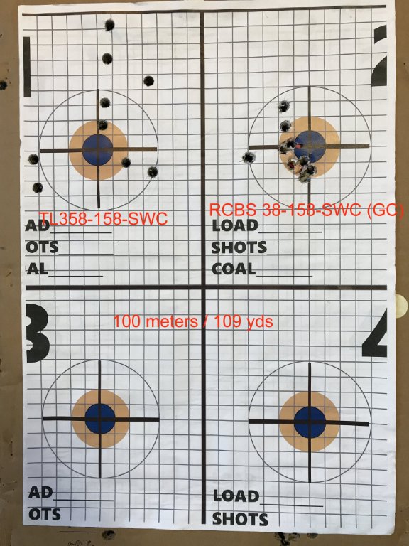

Hi all.
Finally I found a sweet cast bullet and load for my 357 Magnum Big Boy Steel. I have experimented with 5-6 cast bullet designs, and the most accurate is the RCBS 38-158-SWC (gas checked), tumble lubed with Lee Alox. Powder is 6.0 grains of Hodgdon Universal.
Left is the Lee TL358-158-SWC for comparison, right the RCBS bullet. Same load. Distance is 100 meters, 10 shot each, with scope from rest. Not bad accuracy for homecast unsorted bullets, in a pistol caliber, I would say.

not bad at all ... do you plan to continue refining your load ?

Looks good to me. I sure would load it again

I love to experiment, so will continue searching for the perfect load, yes :) .

That is some mighty good shooting. And at 100 meters! You have a very good load there indeed.

Very nice grouping from 100 meters! Lock that load down!

Nice shooting for sure, looks like you have it figured out.

I did not have good accuracy with the tumble lube design bullet.

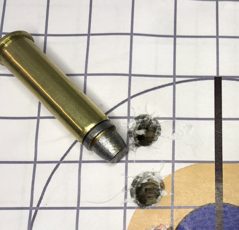

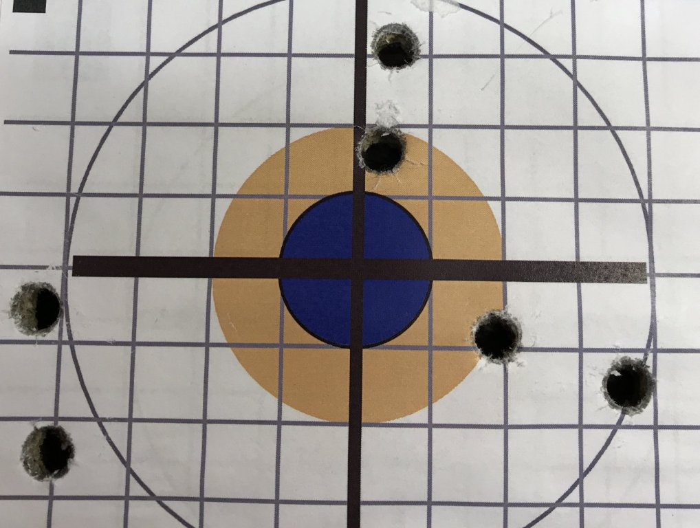

From the holes punched in the paper, the Lee bullet makes holes duplicating a full wadcutter. Can you post a picture of the two bullets you used in the test?
Excellent 100 meter shooting with the RCBS bullet.

I also noticed that, but they are both SWCs. The RCBS bullets have a sharper step and should have cut the paper cleaner, but they didn’t. Could be the target, it has many layers of old target paper glued together.
I dont have any of the LEE ones left, and I will probably not cast any more of them.

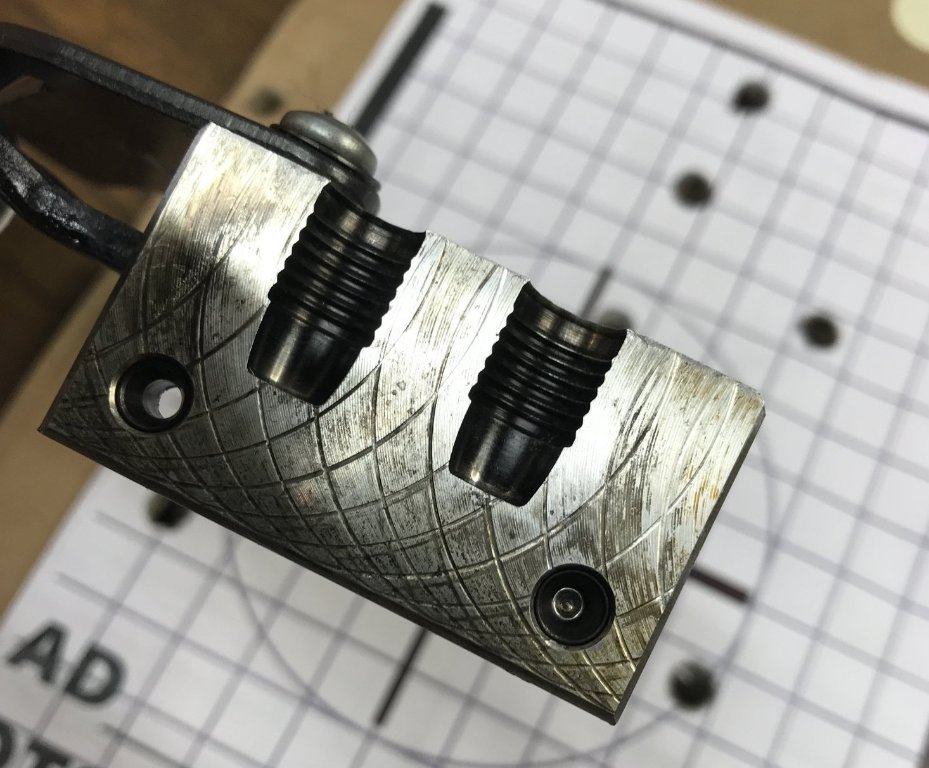

Here are some more pics of the actual target. The only explanation I have is that the Lee bullets have a larger meplat, and that their edge is a bit rounded, so they slipped through without cutting.
RCBS bullet and holes:
Lee TL358-158 mold:
Lee holes:
