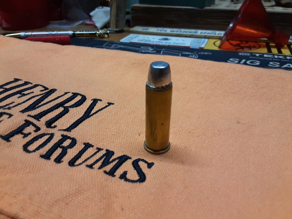

Do you have a picture of one of those 250 gr. K bullets loaded? Nice group with that load!

Hey, forty here you go, loaded just for you. :lol:
