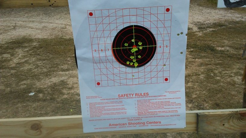

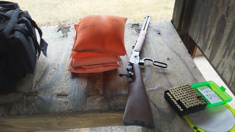

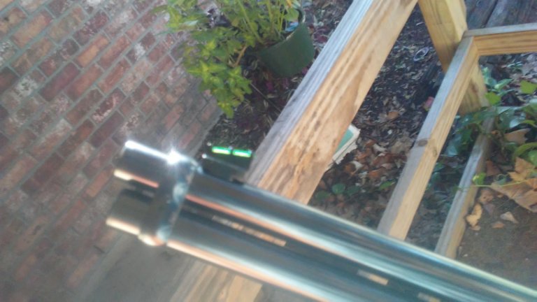

A little background first. I had a Marbles tang site installed on the Winchester a while back and couldn't get the rifle where it wasn't hitting about 8 inches high at 50 yards. I emailed Marbles and Troy was very nice and suggested that I send the site back and let them shorten the stem. I was actually trying to get some advise on what height of sight I should get. He stated I needed to get at least .570 to get where I need but "....that would be too high." I thought before I send it back I'll just try a taller front sight. I got a .565 sight from Rangerpoint and installed it. My first shots were going way right (You can see this on the white of the target.) so I made note that I need to tap the front sight a couple of times a bit more to the left. Not taking my brass hammer with me I was left to adjust the windage on the Marbles. As you can see I got it fairly well placed at 50 yards. I went a bit too low before bringing it back to where I needed it. I was happy with the results for now that I decided I would take my brass hammer out with me the next time and move the front to the left a bit and re-zero.

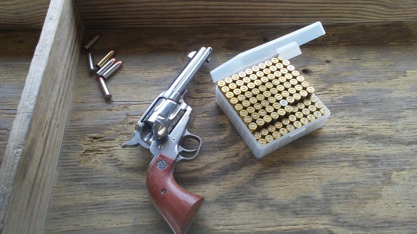

I then went to the steel targets to have some fun with the Vaquero. I can tell you all the other shooters were coming over to me to see what I was shooting. Made me a bit proud to say the least.

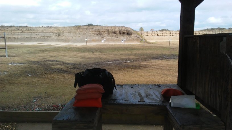

well done .... well done indeed .... that is a nice looking range

I need to make a correction: The front sight needs to be drifted more to the right to bring POI to the LEFT. FORS.....Front Opposite, Rear Same. Just one of those "DUH" moments.

Yeah, I like it. All the range people are really friendly. They get a lot more business running their clay tournaments (Sporting, Skeet, Trap). I used to shoot on a skeet league there many moons ago but got out of it. Sold my Browning Citori 725 Skeet shotgun and reloaders. Wish I would have kept it now. It's selling used for over twice the price I sold it for.

Nice Range Jake and great shooting. Is that 45 colt
Re: Winchester 1892 and Vaquero
Post by Shakey Jake » Wed Nov 20, 2019 6:37 pm
Wed Nov 20, 2019 6:07 pm
It's a .357
