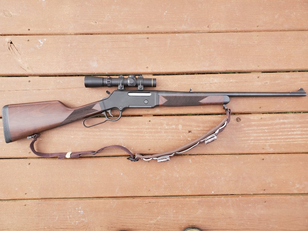

Well, I am fairly pleased. After some scope mounting shenanigans, I finally got a chance to get out and send a few down range today.

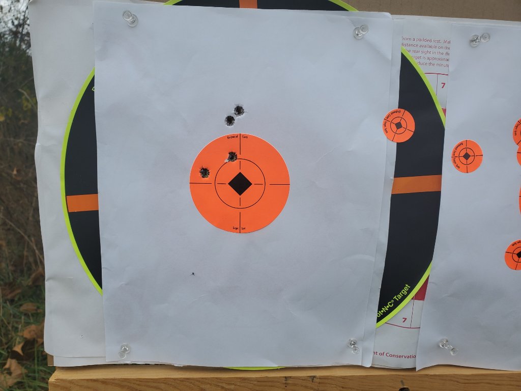

100 yards, (12 sighters; nine at 50, and three more at 100) with about 5 mph of right to left crosswind, this is the first and only group I shot after being satisfied with the sight in. While not stellar results, consider that I'm shooting a Leupold 4x Dangerous Game scope, with heavy, European style crosshairs that almost completely obscure the 3" diameter bullseye at 100 yards. Shooting PPU .308 Match, 168gr HPBT's. Temp was about 61° and cloudy.
The only problem I had was that the locking lugs took a pretty hefty slam from the lever to fully engage. Seemed to get a little better as I shot, so probably just some break-in needed.

That is a nice looking rifle!
