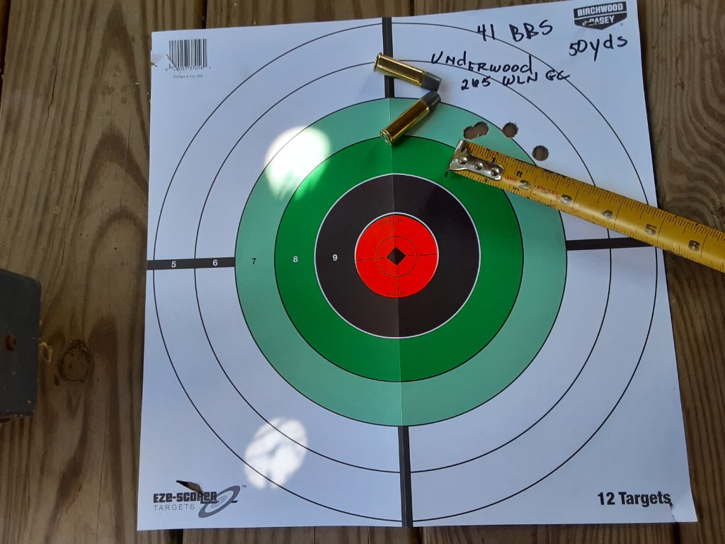

Sight in with Underwood 210gr XTP @ 50 yds
Re: BBSC .41 mag Chrono results
Post by BigAl52 » Sun Sep 29, 2019 12:01 pm
Dont remember Gene. Scoped or iron sights.
GunnyGene
Posts: 3005
Location: Monroe County, MS
Post by GunnyGene » Sun Sep 29, 2019 12:43 pm
Nikon Buckmaster. I can't see good with irons. Do what ya' gotta do to put meat in the freezer. :)
Post by BigAl52 » Sun Sep 29, 2019 12:55 pm
No I get it Gene. Just turned 67 and Im still able to do the irons and feel lucky to be able to. But I do have a few red dots on other guns and have thot about putting some on some of my levers.

Yep. Bullet weights and G1 BC's are per the Hornady spec., and barrel length per Henry. Or are you talking about my 2nd group compared to yours? ;)
