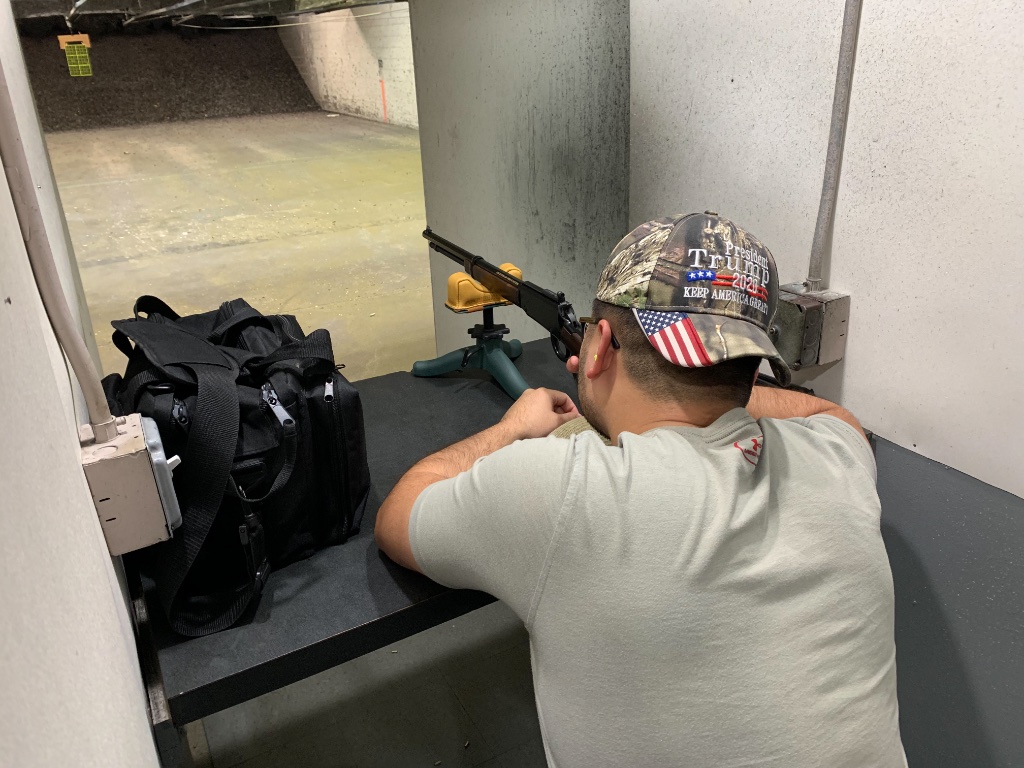

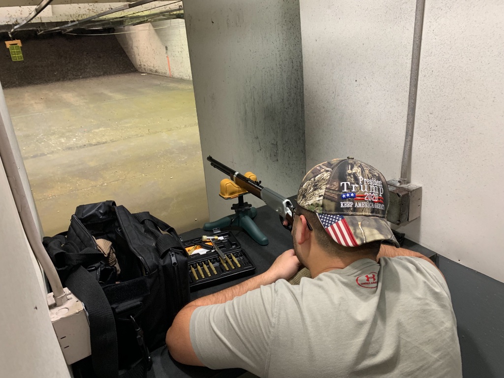

I really like the SGC .22lr, but at 25 yards it was shooting 3 1/2" high with the stock front sight (.4470" according to my micrometer), and rear peep sight bottomed out. So I ordered a .530" front sight from Skinner, and took it to the indoor range a couple miles from the house. One round up with the rear sight and it's shooting bullseye at 25 yards rested.

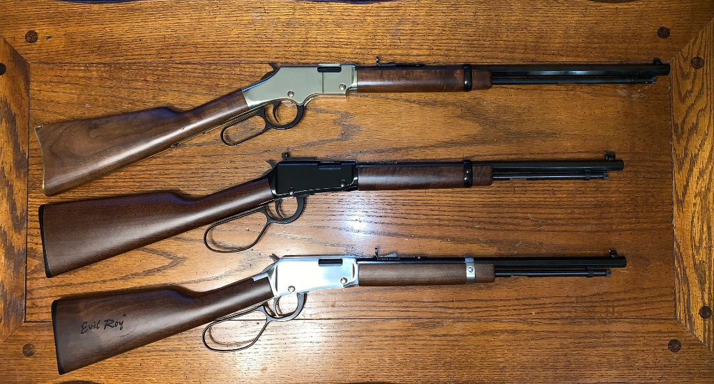

Before we actually got to shooting though, I had to see what the shop had on the rack...wouldn't you know, they had a new Evil Roy carbine .22lr sitting there...and I just had to have it. My "Old Eyes" struggled with the buckhorn rear sight, but I got it dialed in at 25 yards rested, and proceeded put ten rounds in the diamond standing at 15 yards.
*dude in the pictures is my daughter's fiancé...he's a good kid.

Three in the family now; Cowkid2's Golden Boy 22lr, my SGC 22lr, and the new Evil Roy 22lr.

If you notice, I have a set of Wheeler brass punches (second picture in the OP), I keep them in my range bag now...have to be prepared, learned that lesson sighting in Cowkid2's Golden Boy...and not having them along.
