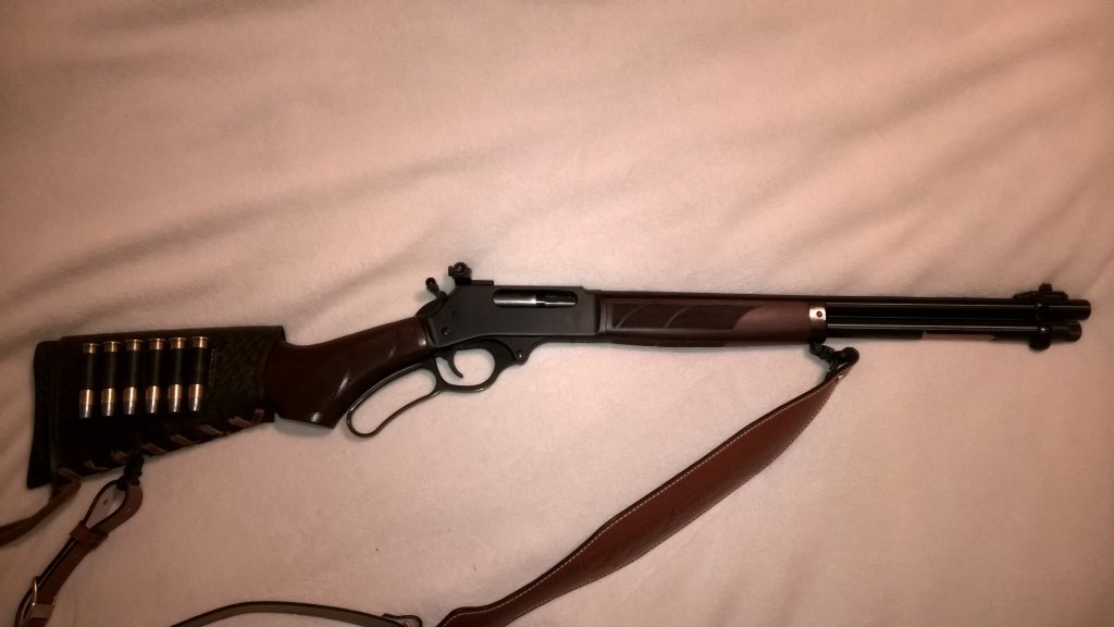

New H015 45-70. Shooting Remington core lokt 405gr.
I wanted to start at 50yds, and eventually move to 100.
Never made it to 100. At 50 (off a solid rest), it is grouping awesome. Holes almost touching, and got the windage dialed in great.
Problem came with the elevation. It was shooting way low, so I moved the rear sight up to adjust. Then I ran out of adjustment and I'm still 2.5" low at 50yds.
Not sure what to do, so I called Henry. The guy I spoke to was helpful. Turns out my front bead is the shortest one Henry makes. Only thing to do is send gun in. Not thrilled w that idea unless I absolutely have to.
Soooo, I called Skinner. Awesome dude named Rob had me measure front post, did some calculations, and hooked me up with a shorter one. On it's way now.
Not upset with Henry, or discouraged by this.
Things happen, and new guns have bugs to work out.
Any input appreciated (other than trying different ammo, it is grouping real nice).

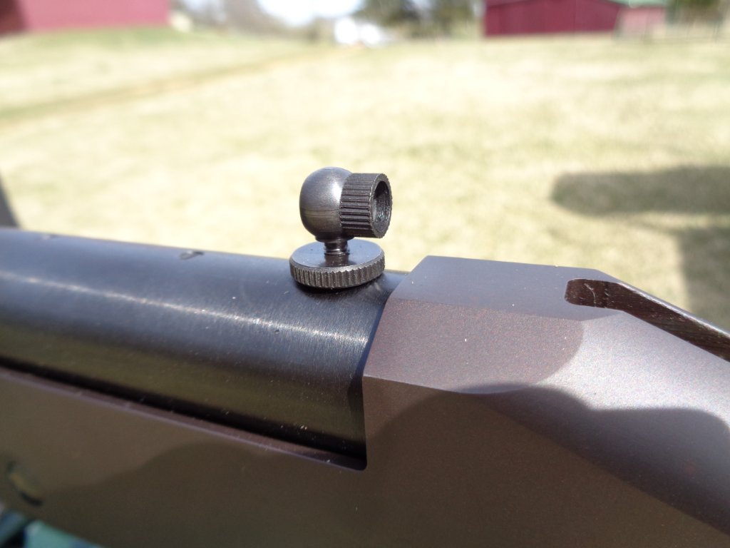

I have one of the early Rice Lake H010 .45-70's. I had the same problem with the ghost ring sight. It didn't have enough adjustment. I removed the ghost ring and installed a Williams FP336 receiver sight. Worked great!

Don't think you could find a Williams receiver sight that fits but I would think about finding a better rear sight system.

[quote=Ojaileveraction post_id=102414 time=1563406192 user_id=2021]
The FP336 Williams sight does work on the early H010's... I am using one! Not sure if it works on later versions but the same screws that held the ghost ring on line up with the FP. It has precise click adjustments just like a scope. Kinda hard to see in this pic but it's there

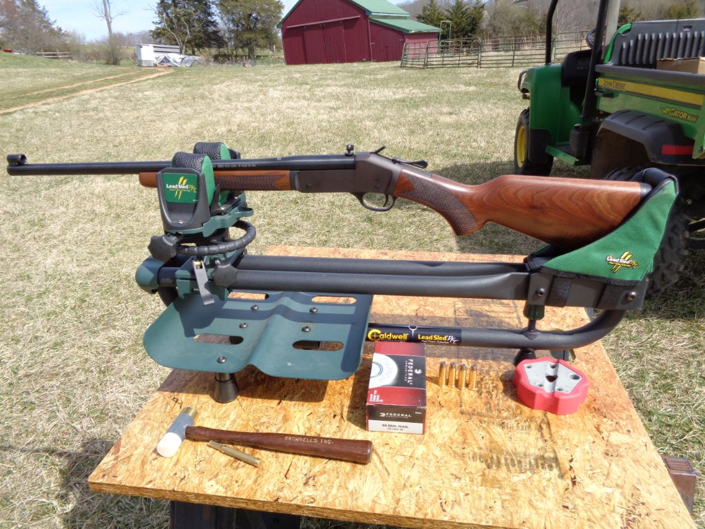

Skinner Low-Pro rear/Lyman Globe 17A front on a Henry 44Mag Single Shot
