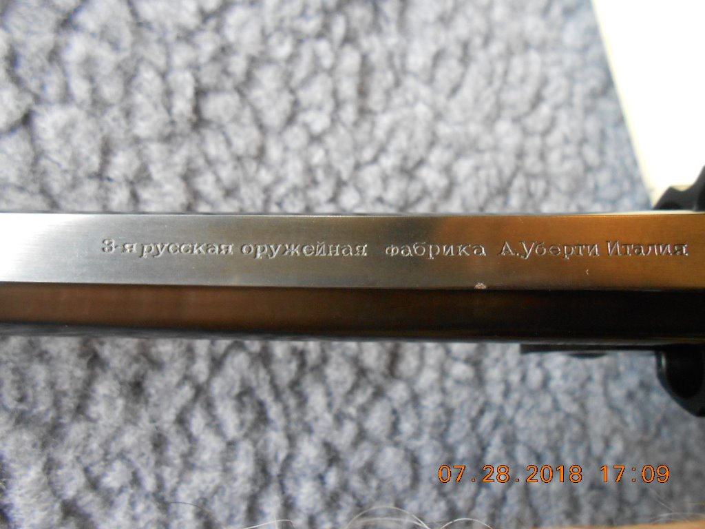

I had a better than good day at the range shooting my 1874 Russian #3 top break in 45 Colt. :D
Cyrillic engraving_2563.JPG (163.61 KiB) Viewed 3274 times

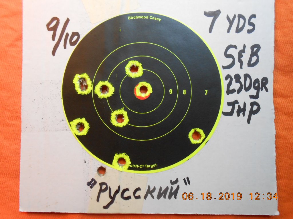

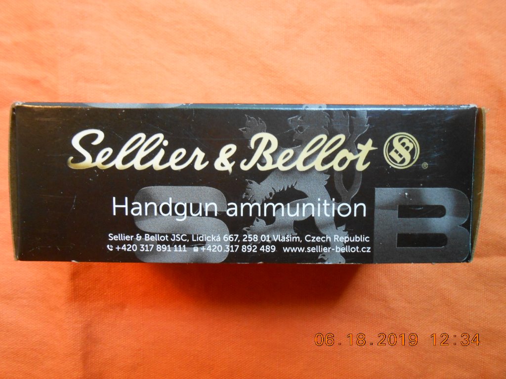

Ammo. First time I've tried the S&B ammo (shot 40 rounds), and the revolver and I both liked it.
Shooting Stance. Off hand, one-handed. A finely-balanced revolver, and a solid grip aided by that handy-dandy trigger spur.

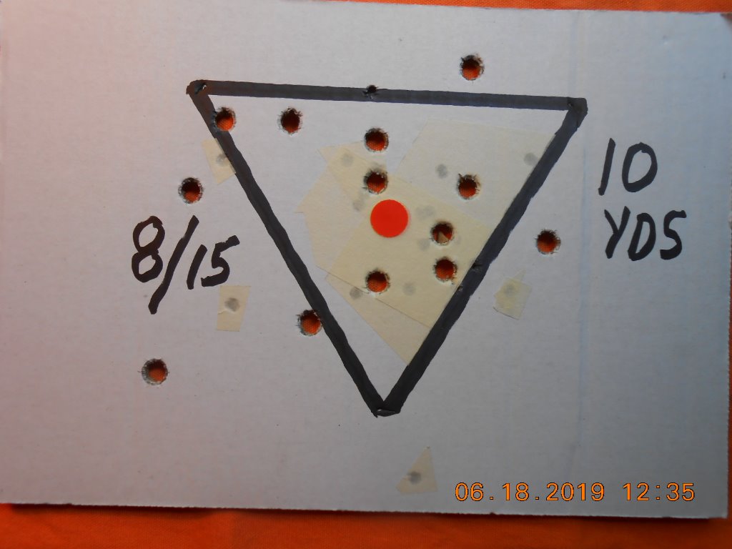

Targets. The rest of the Range Report story.
Five-inch splash at seven yards. Two 5-round groups to warm up.
Six and 1/2-inch inverted triangle at 10 yards. Eight POIs in target is a result I'm good with, especially with all the "new stuff" happening today.

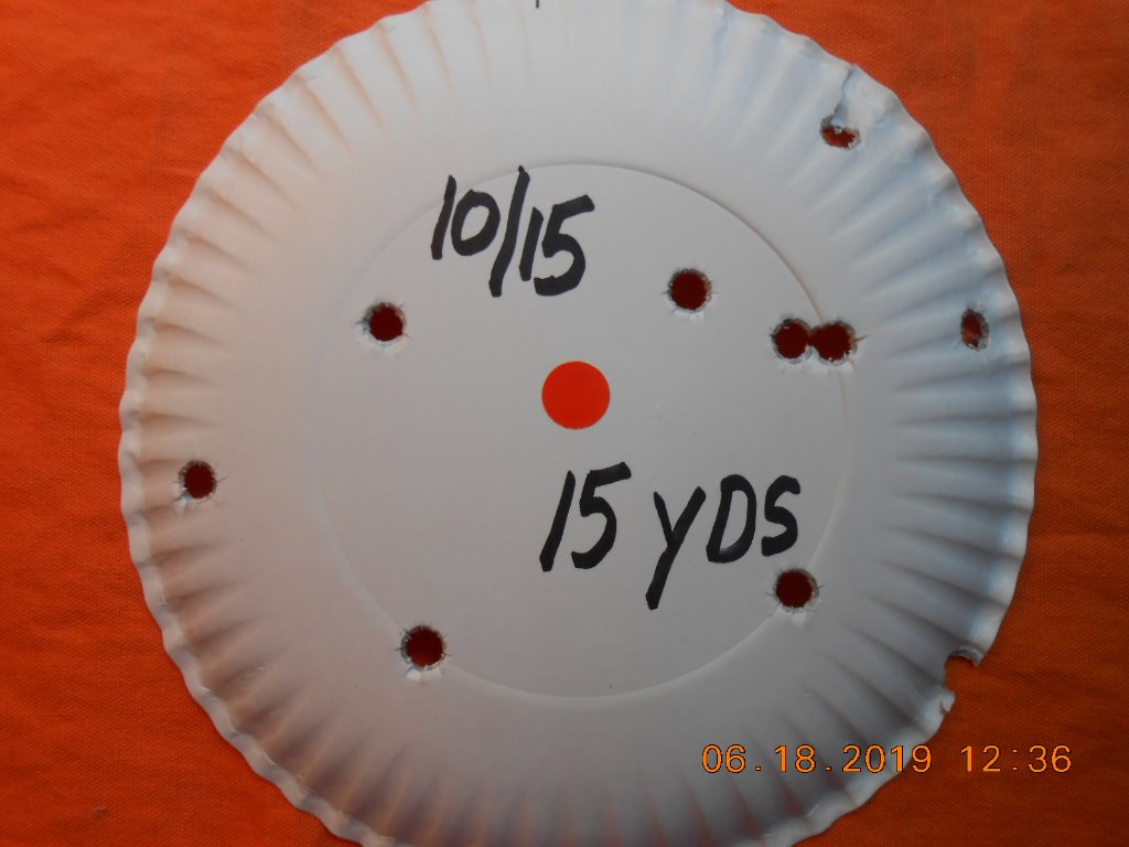

Nine inch paper plate at 15 yards. My goal was POI placement in the 5" smaller circle. I landed 10 rounds in plate, with 6 POIs in the goal area. Although this easily can be considered a "so-so" target result, it is the best I've ever shot the Russian at 15 yards. This was the most fun and encouraging part of my range time. The lighting at the indoor range was dim at 20 and 25 yards (max), but I hope to get to that distance some day. For now, more time working on the 15-yard distance.

Solid shooting for sure. Great job. S&B is nice ammo.

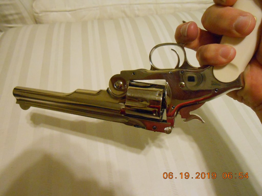

Here are some photos somewhat showing the ejection/unloading sequence. I have a video tool on my Nikon camera, but no way to hold the camera while using two hands. Your imagination will have to take over.

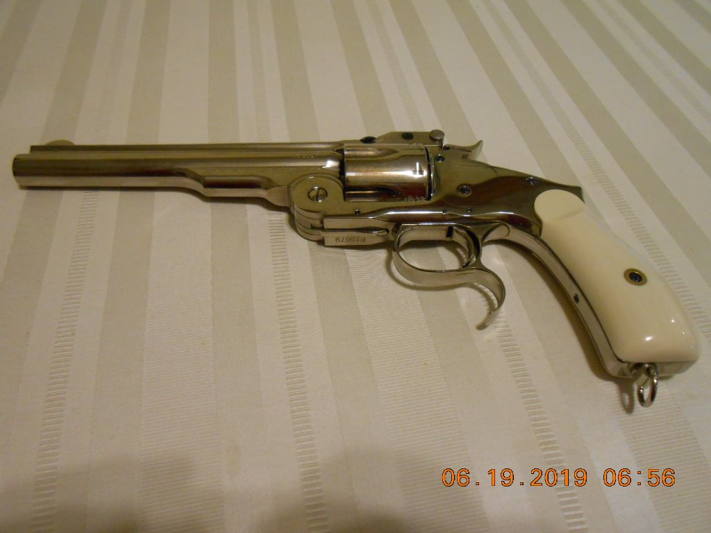

Silver Russian "at rest."

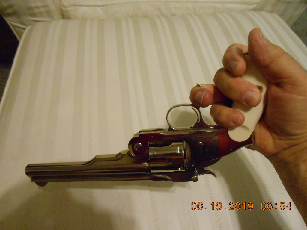

New brass ejection hold. Right hand is shooting hand. Top of frame now pointing to ground. Note my fourth finger holding the trigger spur. Easy to hold using that extra component of this Schofield model.

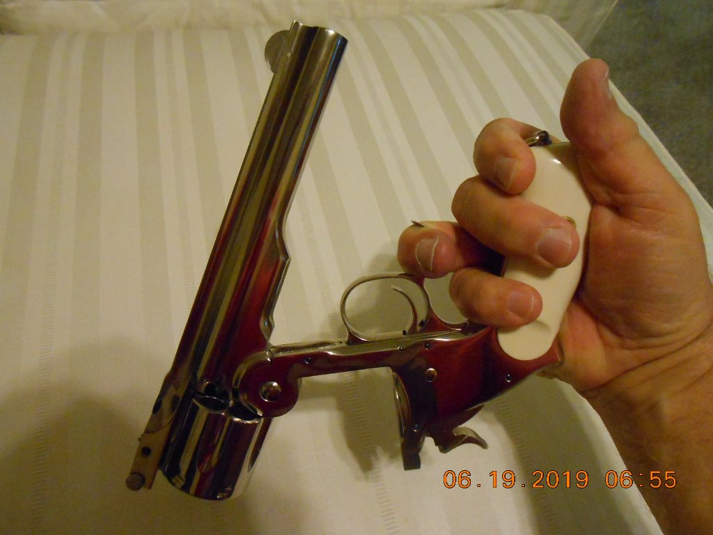

Revolver barrel lock opened. With my left hand, I "unlocked" the barrel cross bolt from the frame. You can see the bolt has a checkered head and is positioned where the barrel separates from the frame. I then grip the loosened barrel with my left hand, and break it open with the ejector star pointing downward.
Here is where your imagination works best. My left hand is wrapped around the barrel just as my right hand is wrapped around the grip and holding the trigger spur. I hold the cylinder over a small plastic bucket to catch the brass, which works quite easily.
Ergo. So far no spent brass has gotten caught under the ejector star.

got it indeed, thanks for the pictures and comments .... I can't help but wonder if incorporating the trigger spur into the revolver's design wasn't for use in reloading ..... hope you'll bring at least one to the gathering, I'd love to see it in person

Interesting thot, Jim. It could very well have been that way since this top break was used primarily by cavalry. The non-shooting hand could have still held the horse's reins while ejecting brass. Or possibly the top of a leg could have be used as the non-shooting hand functioned to "break open" the revolver.

since you have learned that being held in the position shown is a key to smooth ejection from the cylinder, it does seem logical
