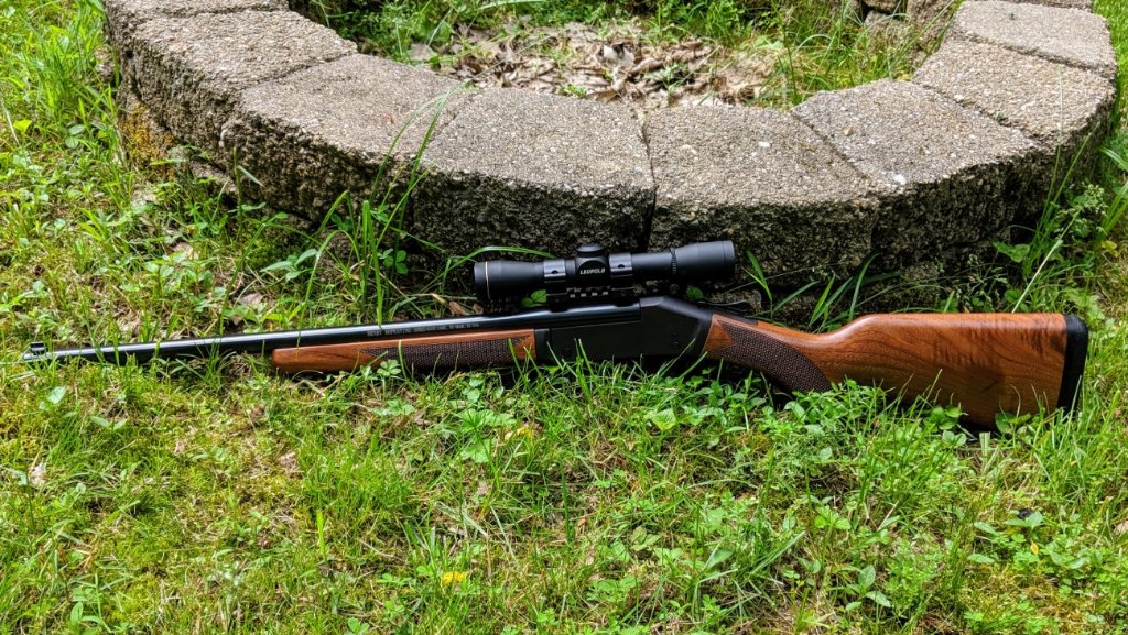

This trim little beauty is really growing on me. No group photos to show, just offhand shooting at some cans and a few decent sized shards from clay pigeons past. Note to self- bring bug spray next time!

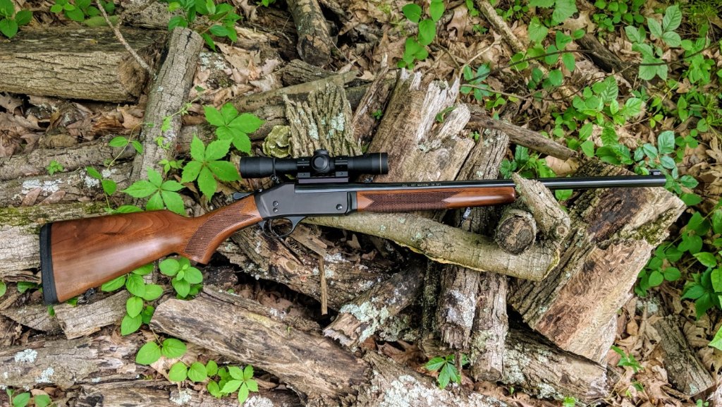

Did get a couple hero shots of the rifle.

Beautiful and thanks for the data and the recipe. Seems like a great combo and the rifle/scope set-up looks great!
Thanks for sharing!

A little beauty it is!

Very nice looking setup!

Nice looking gun Wolfman but how did those rounds shoot?
