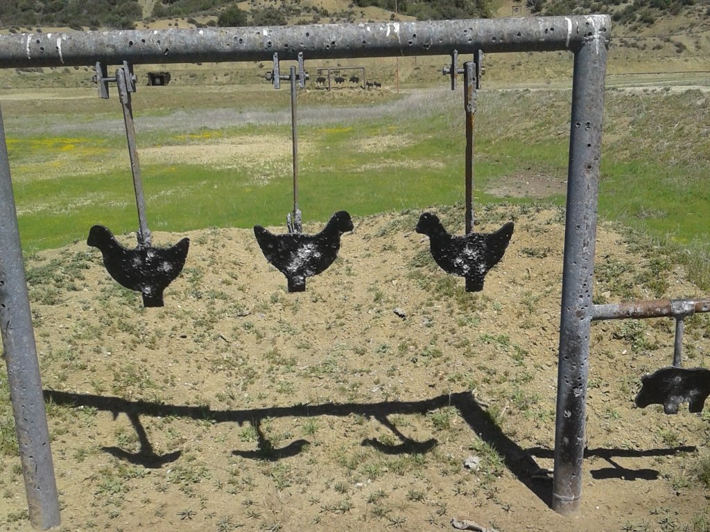

Post by Ojaileveraction » Tue Apr 09, 2019 5:30 pm
At the range today and I do believe I've found my load for Pistol Caliber Silhouette .
The 50 meter swingers
158 Barry's plated over 9.3 grains 2400.
1150fps

tractortad wrote:Nice - looks like a good plinking round - is that Berry's .38/.357 158g FP-TP?
RN. A little long but the cycle.
Going about as fast as a 22lr.

Berry's makes a very good bullet in my opinion and your groups on the steel are impressive.
I have a load I developed with Hodgdon CFE powder and the Berry's 158g F.P.T.P. for my Winchester 1866 chambered in .38 Special. This morning a 50 meter 10 shot group measured 1-1/4" W x 2" H and chronographed at 971 fps.
The Berry's 125g Target Hollow Point grouped better and chronographed at 1048 fps.
I may have to pick up some 2400 and see if I can't shrink the groups.
