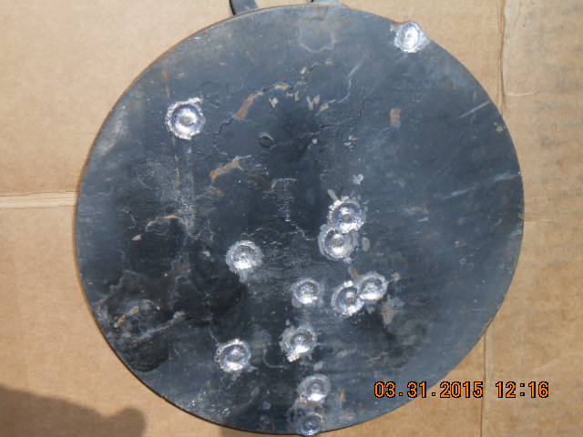

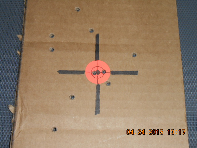

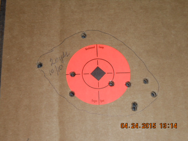

Here is my experience with the Henry .22WMR I had a few years ago.
I shot these ammo brands without a glitch, and no keyholing:
~Armscor 40gr JHP
~CCI Gamepoint 40gr JSP
~CCI maxi-mag 40g JHP
~Hornady V-Max 30gr
~Speer Gold Dot 40gr GDHP-SB
~Win Super X 40gr JHP
I did a lot of my shooting at black steel targets (preferred). My target distances ranged from 25 yards out to 60 yards. The Henry was highly accurate, and the "clangs" were solid.
I rarely shot paper targets; instead I used homemade cardboard ones mounted either on a shooting board, or tacked up on a tree trunk. Cannot remember any keyholing here either.
My Henry WMR was a very good and accurate rifle. I shot +500 rounds in the first 9 months or so....no probs.

What kind of targets are you using? Try the cardboard as PT7 has done, just using a marker to make your target spot. Even a thin piece of plywood will work at 10 yards. Paper is notorious for tearing, unevenly, and can give you false positives for key holing. Worth a try before going to all the trouble of sending the rifle, back. Honestly, though, if you're getting 1" groups at 100 yards with any 22 mag ammo, be hard to imagine that it's a gun issue. That's excellent 22 mag accuracy, even for a bolt gun.
