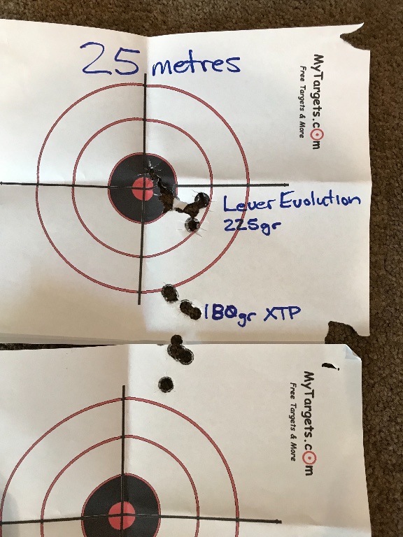

I wanted to try several different types of .44 so as well as purchasing several boxes of Hornady 225gr LeverEvolution, I have loaded Hornady 180gr XTP with 29.5gr of W296 and some Berry's 240gr hollow point with 8.5gr of AP70N (Unique).
Starting out with iron sights at 25m I first shot the LeverEvolution. It fed well, had a nice firm but manageable recoil and hit the target slightly to the right (see pic). The sights were nearly spot on for this ammo at 25m with the buckhorn on it's second notch from the bottom. Great start and big smiles all round. Note, I'm not shooting for ultimate accuracy at any point yet, just trying to come to grips with feeding, sighting and general handling.
Top target LeverEvolution

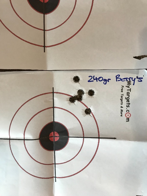

I then moved to the soft shooting 240gr Berry's to see, if any, what the point of impact change would be? These also feed well and were pussy cats to shoot. Very satisfying and fun. I could shoot these all day long. Without trying hard, they grouped reasonably well but what was incredible was the point of impact change. I thought they would shoot low being slower and heavier, but the shot high and to the right. Guess a factor of how they leave the barrel.
Berry's 240gr Hollow points.

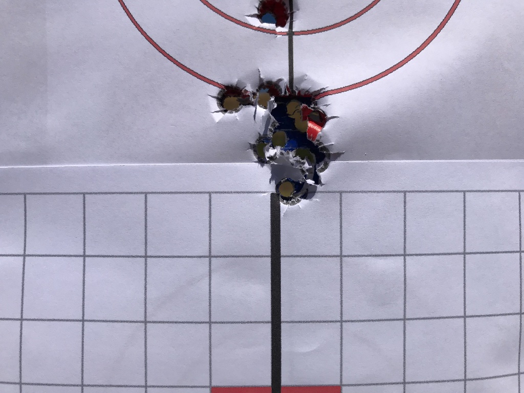

Next the magnum loads of 180gr Hornady XTP JHP's. These really wake you up with nasty recoil and load kaboom!! I used an H110 starting load data because there was no data for W296. The powder I used was a locally bottled powder called Belmont Magnum pistol powder and the only available load data was for it was 240gr. Belmont powder is just relabelled W296 which some of you might know as a powder you need to respect due to a nasty characteristic of secondary ignition due to incomplete combustion. You must use magnum primers, not use light loads that allow for too much air space in the loaded cartridge and a good positive crimp to keep the projectile in place during the ignition cycle....I loaded and carefully fired one round first due to the risks around this powder and the fact I substituted a load data. On inspection of the primer, this is in fact a fast and hot round even at starting loads.
Out of the three selections of ammo, this was the most unpleasant to shoot and obviously the one with the highest energy. This stuff hits hard and as you can see from the photo shot the highest compared to the LeverEvolution. I think because the tactile feedback of shooting the 180's was so different from the other two, the flinch factor resulted in slightly larger groups which tightened up when I focused harder during the next experiment at 50m.
Hornady XTP 180gr 29.5gr W296 (bottom group)

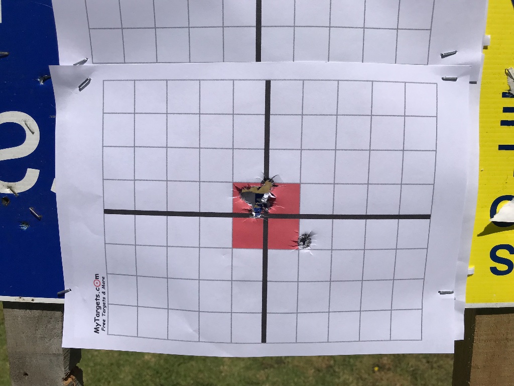

Now I roughly knew what I was dealing with, I wanted to see what sort of accuracy I could get at 50m with a red dot sight, so I installed the Henry rail and mounted my Vortex Crossfire which is a budget RD stolen from my AR-15. I quickly sighted it in with LeverEvolution (3rds) a continued with it for more critical assessment. It did really well at producing a nice tight group with one flyer. I was pleasantly surprised at how a chunky pistol slug performs at 50m.
LeverEvolution 50m

I didn't load many Berry's so didn't include a 50 test on these but will next time as I really liked the way they shoot, but did fire 40rds total of the 180gr XTP's. Here's a critical group at 50m. Overly not too bad but they do hurt if you want to shoot these all day :D Note again how high they shoot compared to the LeverEvolutions.
Horady XTP 180gr 50m

Great report! You're delving into the mysteries of reloading from where I sit. Trying to isolate the variables and figure out why POIs change from one projectile to another, different powders/powder weights. Fascinating stuff, but mind-boggling at times, as it doesn't take much of a tweak to change things.
Lots of juggling of variables, but fun!
