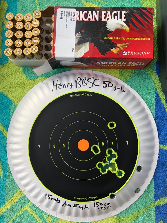

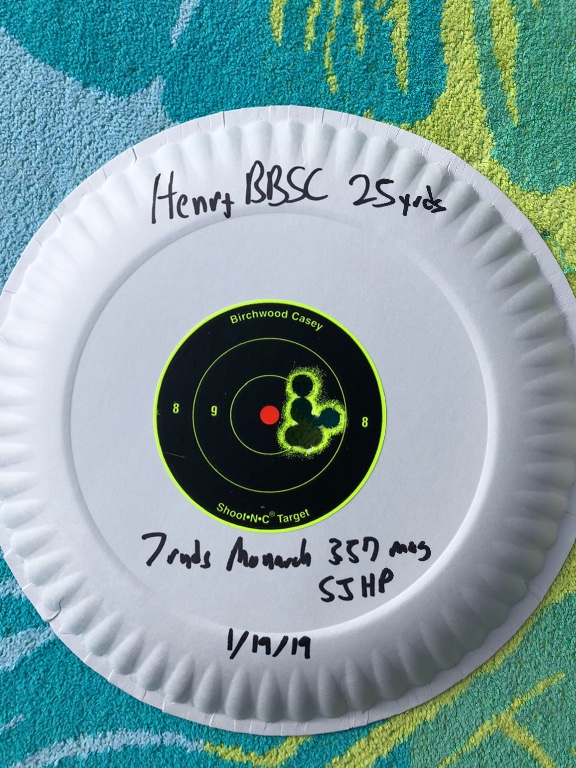

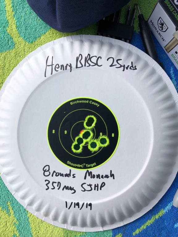

I put another 75 rounds down range today with the BBS 357 magnum carbine. I had to sight it in again because I flipped the rear sight insert around to the plain black side. The white diamond is not painted on in line with the notch. That was very confusing to my eye so I flipped it. Long story short, I made a few adjustments and got it pretty close at 25 yards. I have to cover the bullseye with the brass bead to hit where I want. It’s still favoring slightly to the right. The rifle did well with one exception. The last round seems to nosedive and hang up most of the time. This happened no matter how many rounds I loaded. I tried 8,7,5 and 3 rounds in the magazine. It hung up maybe 50-75% of the time but only on the last round. Could this be an issue with the mag tube? Any ideas?
At any rate, I had a great time shooting and ended up with a couple of really good (for me) targets at 25 yards. The brass bead completely covers the 3” sticker at 25 yards and the 6” sticker at 50 yards. That bead was not meant for precision shooting.

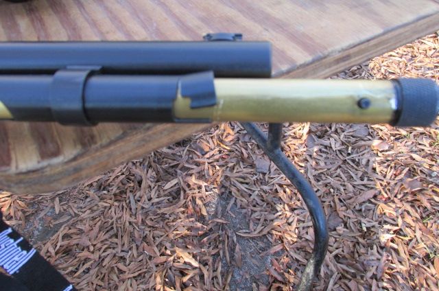

I had the same issue with our BBS 44 Mag .... I sent it back to Henry, they replaced the extractor that pulls the bullet out of the chamber and the spring ejector on the other side that kicks the shell out of the ejection port .... for me, those were the logical parts to replace .... the next time out after getting it back from Henry, the outer magazine tube failed (picture below) .... in looking at the barrel attached ring that secured the outer tube, it appeared to me that the outer tube had moved forward slightly, the angle of the picture doesn't show it .... in addition the O-ring on the inner tube was gone .... shipped it back to Henry .... we just got it back and fired 150 rounds .... rifle performed flawlessly .... I've done a great deal of thinking about it and have come up with several possibilities but no firm conclusions .... right now I believe that the failure in the outer tube and the O-ring missing contributed (if not caused) the original ejection issue .... why :?: , I really can't answer .... coincidence :?: , possibly
Wow! That’s a nasty looking failure! The issue with mine is not extracting or ejecting. The last round wants to nose dive and not chamber. It happens maybe 50-75% of the time. It comes up with the lifter but I have to shake the rifle a bit to get it to chamber. I don’t understand why only the last round would do that. That’s why I thought maybe it had something to do with the inner mag tube or follower. They both look fine, though. I’m hoping that issue will go away with more use. I really don’t want to have to send it back to Henry if I don’t need to. I’ll give it more time and rounds down range before I make that decision.
Regarding the splitting mag tube... My carbine has a thicker machined steel support bracket which has the locking slot cut into it.
Looks like it takes the pressure of the spring loaded tube rather than just the slot in the thin wall mag tube.
Is this an improvement that was made or just the way the 16.5 inch barrel rifles are made?
Is this an improvement that was made or just the way the 16.5 inch barrel rifles are made?[/quote]
My BBS has the same support bracket. It is the full 20" barrel.
