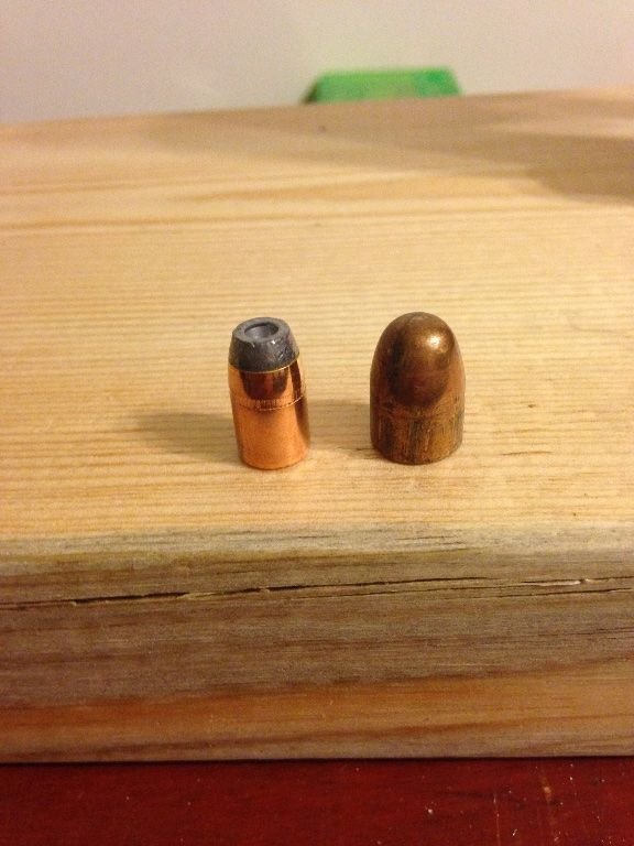

Hey you heavy metal shooters. This is the difference between my 357 and your howitzers. Dang!
