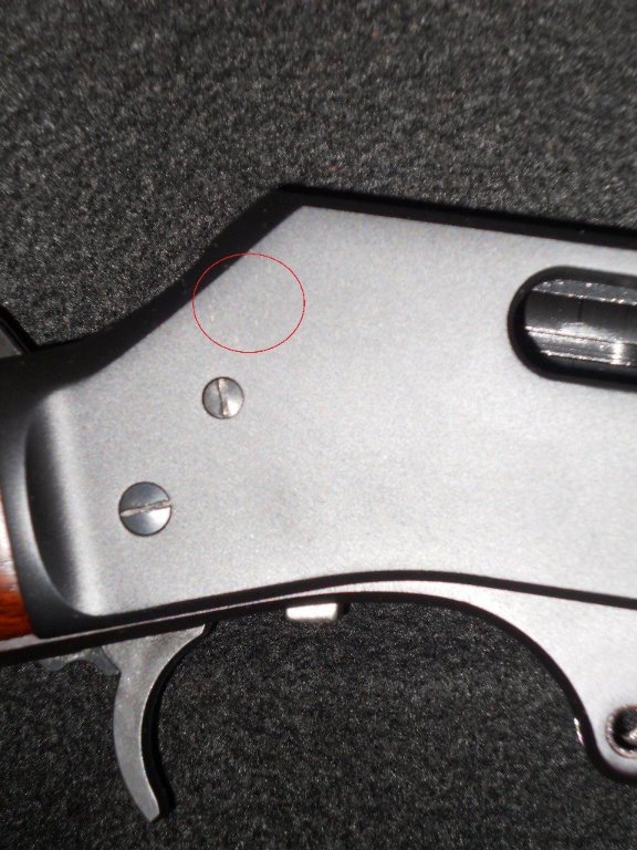

Thanks. No, they fly out. At first, they would fall out. Then, I started working the action more firmly. But, some cases hit the side of the receiver as they fly out.

This may help. They are hitting the back part of the receiver as they are ejected:

So the cases are coming out of the ejection port in some manner that causes them pivot around and whack the outside of the receiver near the hammer?

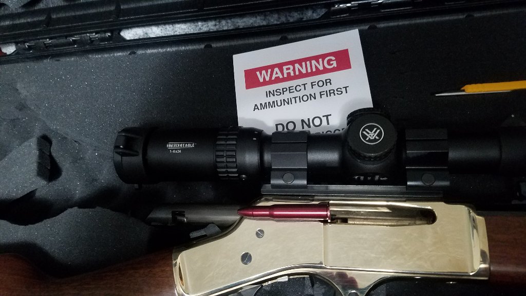

I cycled my H009 lever real slowly with a snapcap case in the chamber to get an idea of what might be happening. What I saw was as the bolt draws back the hook on the end of the ejector tab draws the case by the rim out of the chamber. When the bolt is nearly all the way back the ejector spring flicks the body of the case out of the ejection port. At the time the spring kicks in, the case rim is still behind the ejector hook. As the case rim rotates around the end of the hook it is supposed to come free of the hook resulting in the case being ejected out and away from the rifle. Now by happen stance I happened to be holding my rifle on it's side with the ejection port pointing up. In this rifle orientation the snapcap case rim pivoted around the ejector tab hook with the snapcap case swinging around and bouncing off of the receiver behind the ejection port near the hammer. I staged the picture below to show where the snapcap was hitting before it bounced away. Another observation on my behavior. When I'm sitting at a shooting bench, I can't fully cycle the lever without turning the rifle on it's side as lever cycling is impeded by the bench top. Does this sound like what you are experiencing?

Thanks for your time and insight. I don't pay much attention to the orientation of the rifle other than being pointed down range. I do take it off my shoulder to cycle while at a bench. I don't think I tilt it to the side though. I will have to pay closer attention to that now.
I was keeping it on my shoulder. But, the cases would get stuck or fall out of the ejection port. I started removing it from to shoulder to cycle more firmly. I have not noticed the cases nicking the receiver of my Marlin. So, I have not thought much about the impact other than speed of re-shouldering the rifle for sight alignment. But, I will test your theory. Thanks!
