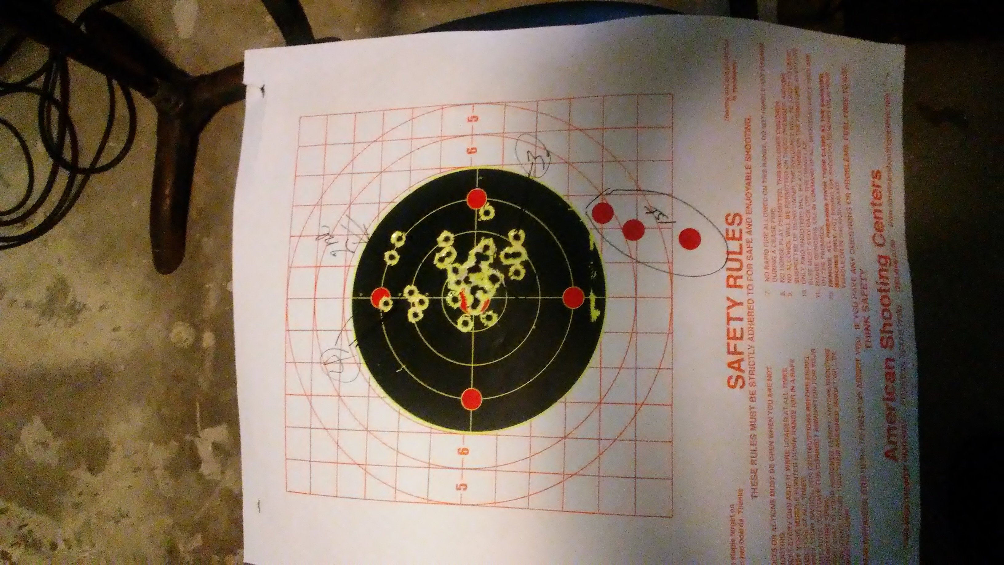

Okay, the range is finally open even though it's on a limited basis. They really got flooded out and the clubhouse is still closed because the insurance inspectors haven't gotten around to them yet. Anyway, went out today and shot the Henry for the first time. The purpose of the trip was to sight in the scope and to see what different loads shot like. I'll attach a picture of the target. My first three hit low. I then over adjusted the scope and went high with two shots to the right. There was an 8 mph crosswind I was trying to compensate for. The group of 3 was really nice and compact but low and right by a bit ( once again, going a bit too far). My fourth group was high but tight again by a couple of inches. I finally settled down and tore up the center ring with a few drifting a bit right. I used loads that I normally use for pistol with the first 3 groups of 3 using PowerPistol. The rest were loaded with Accurate No 9. All loads were with 100 gr Hornady XTP and Federal 200 small pistol magnum primers. I'll get it dialed it better the next time out. I really enjoyed shooting the Henry. It was a HOOT to say the least.

Post by BobGinVA » Fri Oct 13, 2017 8:50 am
Regarding a couple of things...1st, small pistol magnum primers are identical to small rifle primers...this is no difference. 2nd, the pics showing a few below and a few above the "group" is likely the shooter...if it starts low and goes high every time then its the rifle, but if its indiscriminate as to whether it goes up or down or centered, its probably your sandbag rest or akin to that...I have a BBS 357 20" that I shoot in lever gun silh. It started by shooting lower as the barrel heated up ....consistently...I removed the forend screws and adjusted the forend cap a couple of times...I got lucky..it now, for some reason, stays at the same point of impact no matter how hot the barrel gets...I suggest you "shoot in" your rifle (ie. at least 300 rounds), before you start looking for gremlins...good luck. Bob in VA

Post by Shakey Jake » Fri Oct 13, 2017 10:01 am
The rounds used were already made before I got the Henry. I use small magnum pistol as per the Speer loading data for .327 magnum. I see no reason to purchase additional primers, if that is what is suggested, since I have 1000+ already on hand. The scope had been bore sighted to get on the paper. I was "dialing in" to get on target. Thank you for your suggestions.

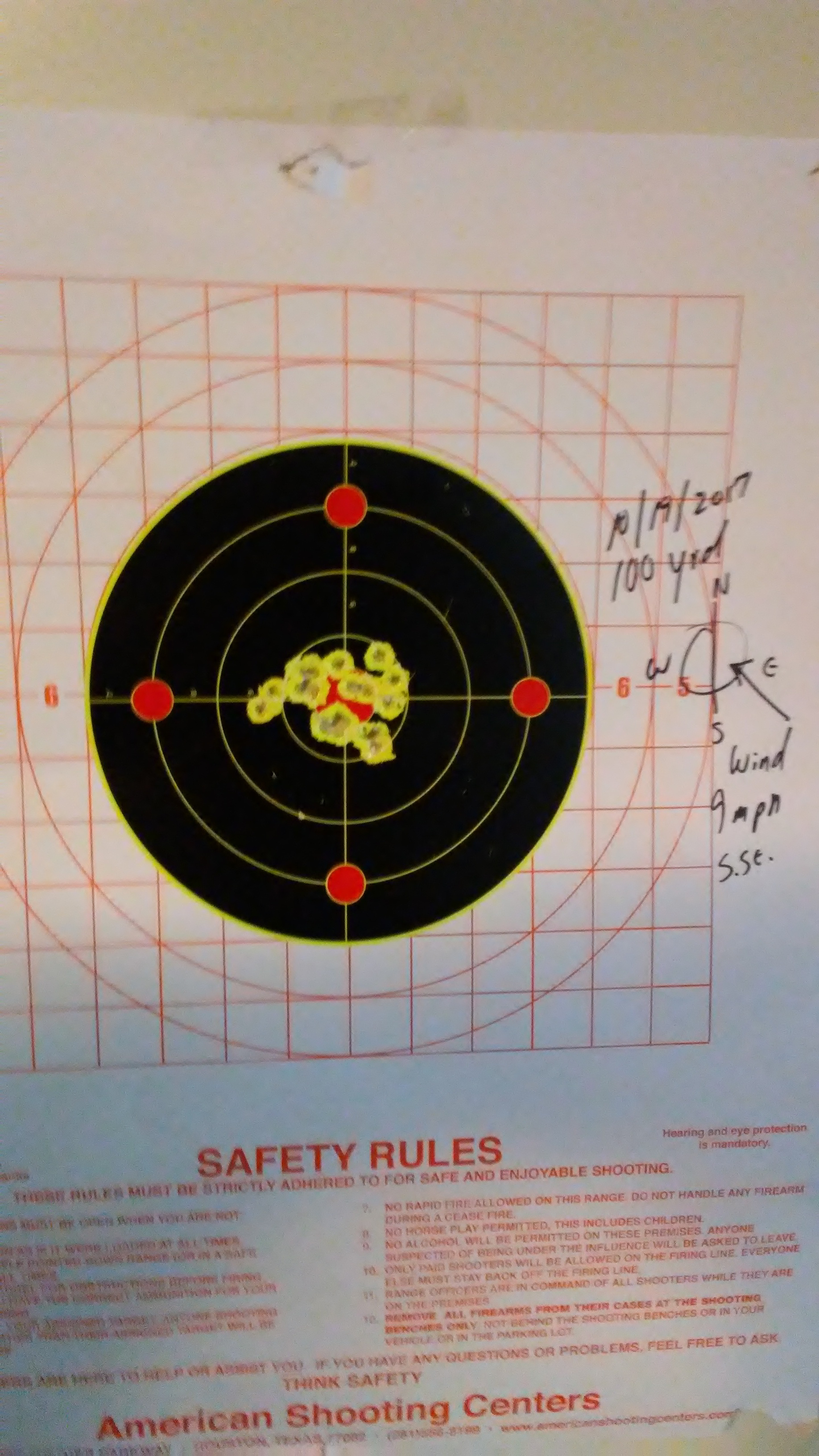

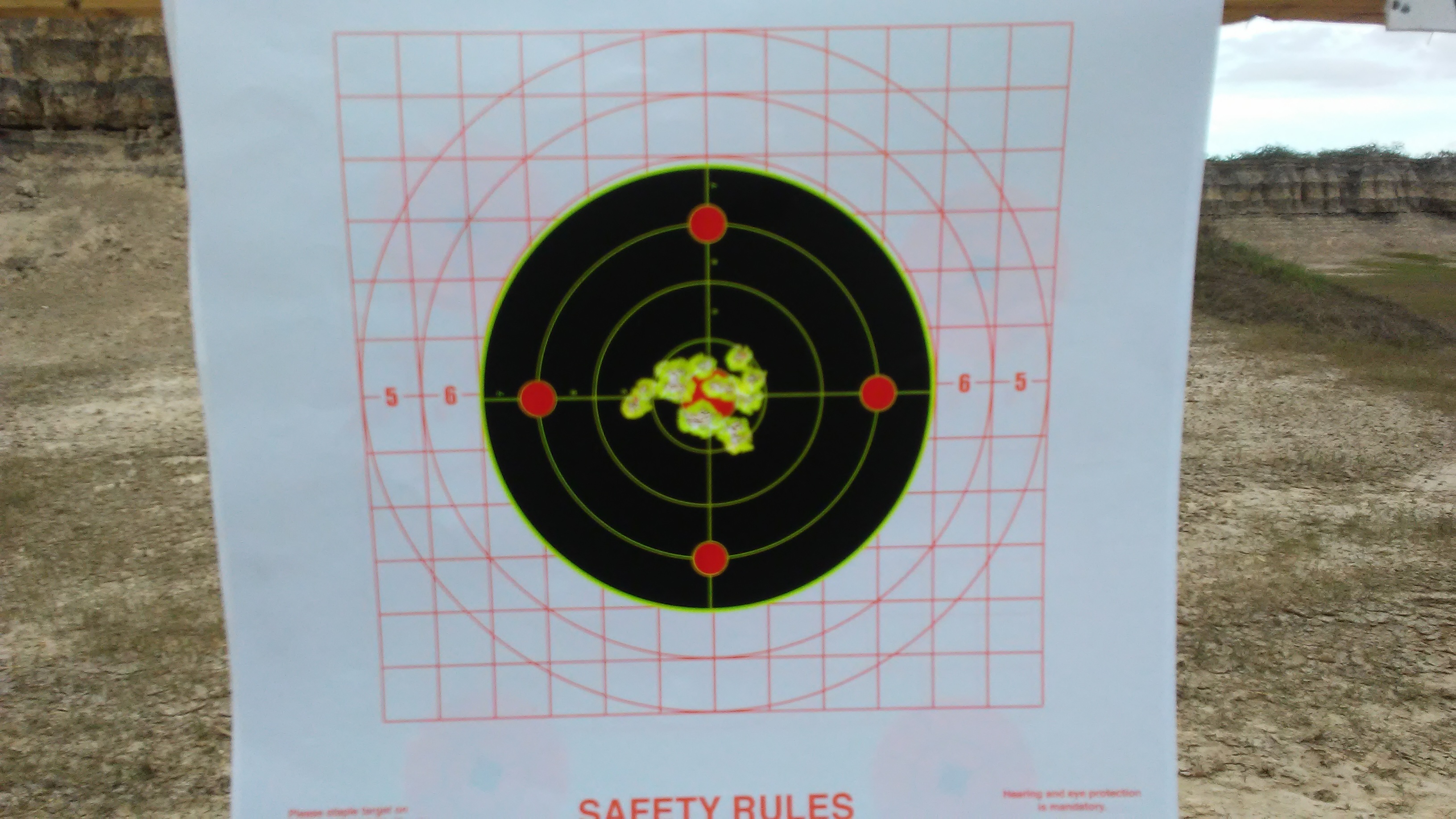

Round 2. Hope BobGinVa can help me out here.

Post by JEBar » Thu Oct 19, 2017 8:09 pm
Shakey Jake wrote:Round 2.
Round 2 looks mighty good to me .... if I shot a 100 yard outdoor target like that, ain't no way I'd mess with the scope, ammo, or anything else

Post by Shakey Jake » Thu Oct 19, 2017 8:16 pm
Just to be "honest" this is the last 20 shots of 50. I was dialing the sight (Burris E-3 2X7) in. The first 30 weren't bad either but I'm happy and will keep it where it is.
