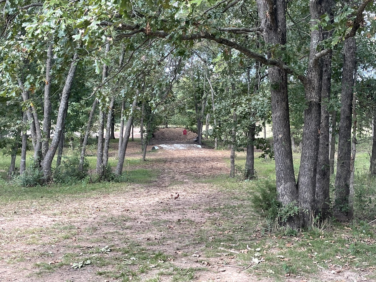

It has been my plan for a good while to add a 25 yard range to my range at the farm. From the range house steps, the range I built had about 80 yards to the berm. In the pic below, I had just trimmed away most of the overhang, and sitting in front of the steps it's a nice shot for a rifle.
trimmed back trees.jpg (801.01 KiB) Viewed 2393 times
I had laid out the plan to add a 25 yard range, but turning ninety degrees to the right, it was just a matter of finding the time, and then making arrangements to purchase the RR Ties or Landscape Timbers to build the retention wall for the dirt to create THAT berm. Then, Miss Tina suggested we use the Corner Post brackets we had purchased to modify the fence lines on the main fencing, since we had gotten rid of the livestock and no longer needed to repair the fences. :roll: Hmmm, She said we could fill in the space with cattle panels and add pallets. I said that the panels only need to support the dirt until it turned to concrete. (It happens here in Oklahoma) We could use tarps, excellent idea. By the time the tarps rotted, the dirt would be fine. It was just a Handgun Range. :twisted:

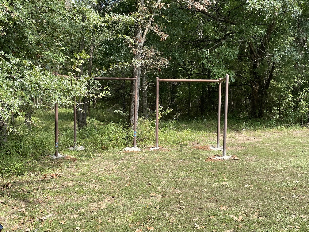

While I had my guy here for the other projects, I had him drill the holes with the Tractor Auger....
01 drilling the holes.jpg (567.41 KiB) Viewed 2393 times

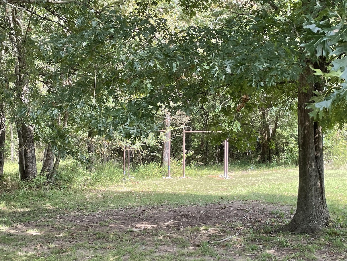

Once that was done, we could set the brackets and concrete the legs.
02 fence brackets set.jpg (584.34 KiB) Viewed 2393 times
A long view of the brackets....
03 Brackets from a distance.jpg (743.77 KiB) Viewed 2393 times

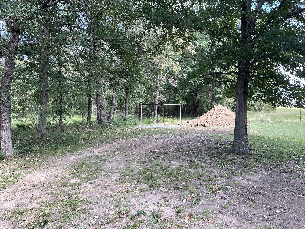

My next step was to trim back the trees on the short range, they had been hanging down around the brackets, as well as hanging down in the sight line from the range house view down the twenty five yards.
04 trimmed back trees.jpg (583.41 KiB) Viewed 2387 times

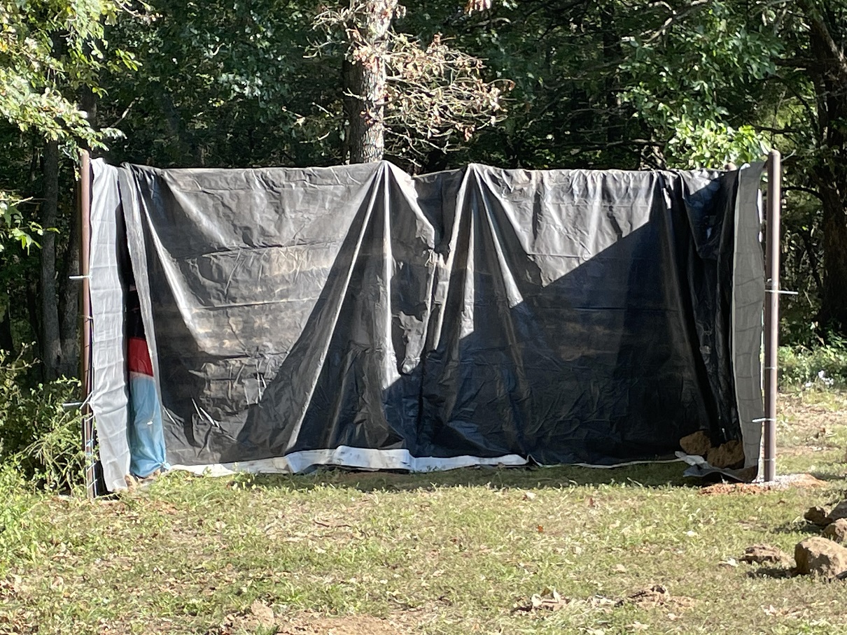

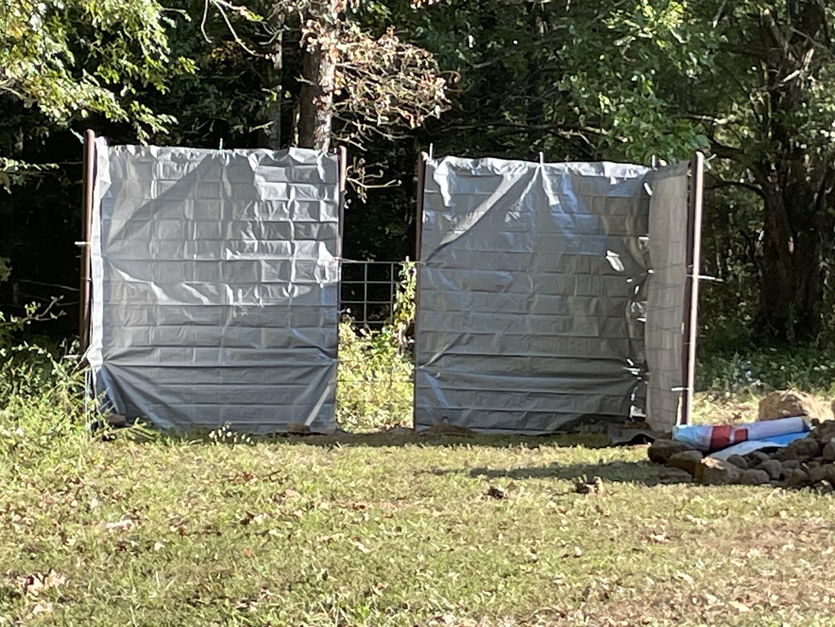

Once that was done, Miss T and I wired Cattle Panels in place to support the tarps once they went up. Once done, the first layer of tarps were zip tied into place. They only needed to be held in place until the dirt was moved. The weight of the dirt would hold them. I still used heavy duty zip ties.
05 First layer of tarps.jpg (528.21 KiB) Viewed 2387 times
Next we used special tarp you can order online. It's the tarps used on Billboards. Once they come down, you can buy them fairly cheap. BIG tarps, with the ads still painted on one side. The back sides are usually black, gray, or white. This went over the tarps we put up, mainly concerned with the back of the berm, where most of the weight would be pushing. Up she goes.
06 Heavy Tarp.jpg (591.47 KiB) Viewed 2387 times

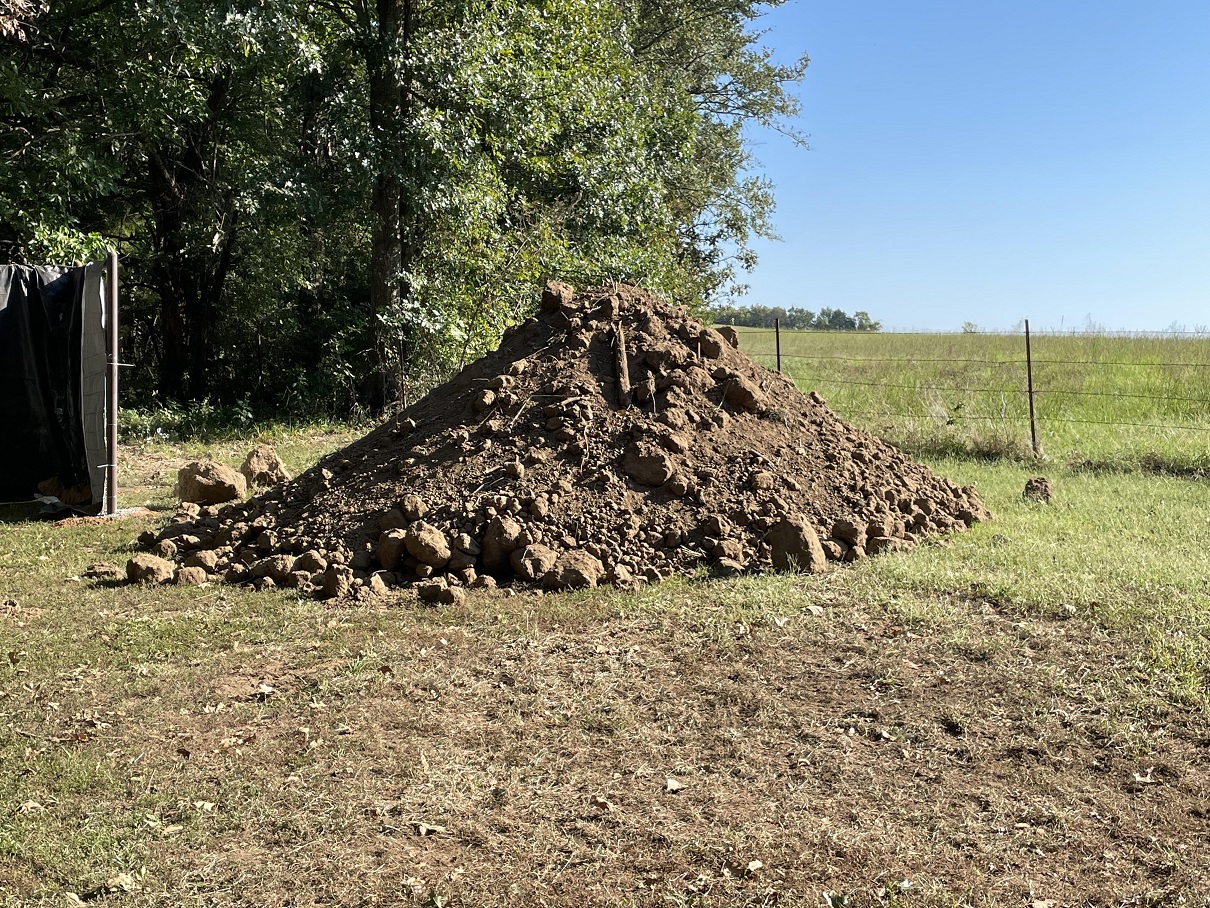

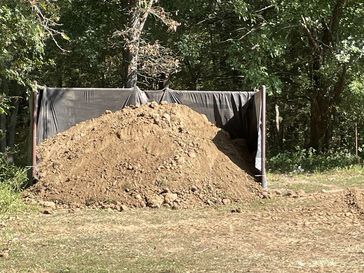

Now it was time to get busy. There was a pile of Dirt that my guy had moved with the Backhoe using that big 5 yard bucket. I had him set it right next to the area where the berm would be, and I wouldn't have far to move it.
07 Dirt Pile to Move.jpg (761.47 KiB) Viewed 2387 times

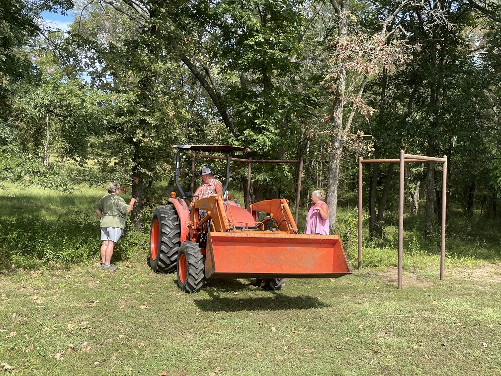

Using our small Kabota L2501 and the Front Loader, I got busy. Gimpy can run a tractor. :lol: I actually enjoy working with the loader, and in a couple hours, I had moved that entire dirt pile then spread the last bit to smooth out the area where I had worked, hiding the ruts.
08 Dirt Moved.jpg (570.73 KiB) Viewed 2387 times
The Brackets are mostly filled, I have a working berm for the pistol range. I will certainly move more dirt later, but I can shoot on this. :)

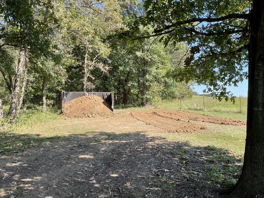

Posts: 7518

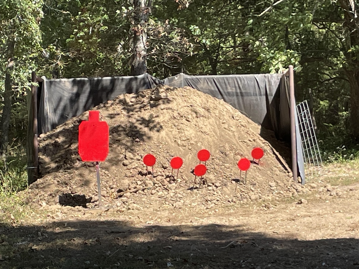

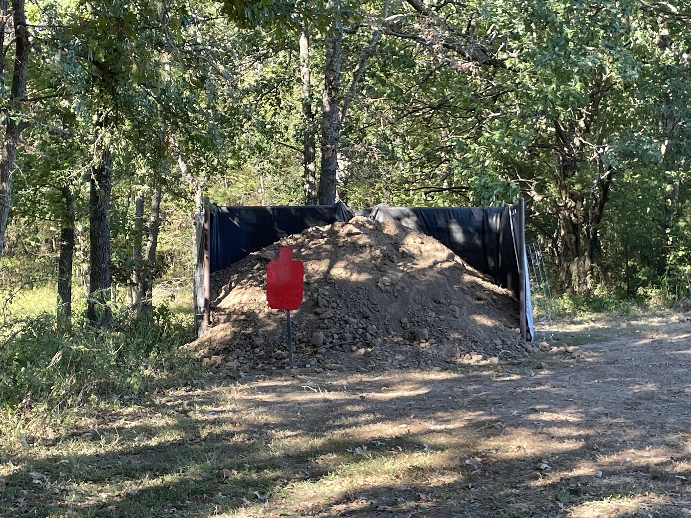

Re: The new Short Range
Post by BrokenolMarine » Sat Oct 04, 2025 11:20 pm
A pic of the pistol range after working it with the tractor, extra dirt added, worked the dirt that was there as well. I also moved the Iron Beotch up from the Rifle Range, and put five coats of new paint on her. She's a reactive steel B-27 target. Fun to shoot, mounted on a solid base, she rings and moves when hit, but doesn't fall. I intend to add some low mounted steel places and swingers as well. Will still be able to shoot "Cardboard" above the steel plates. Should get the steel in place tomorrow or Monday.
10 touched up.jpg (938.28 KiB) Viewed 1584 times
Also on the to do list are some wings to the sides to protect against splashes and / or ricochets.
