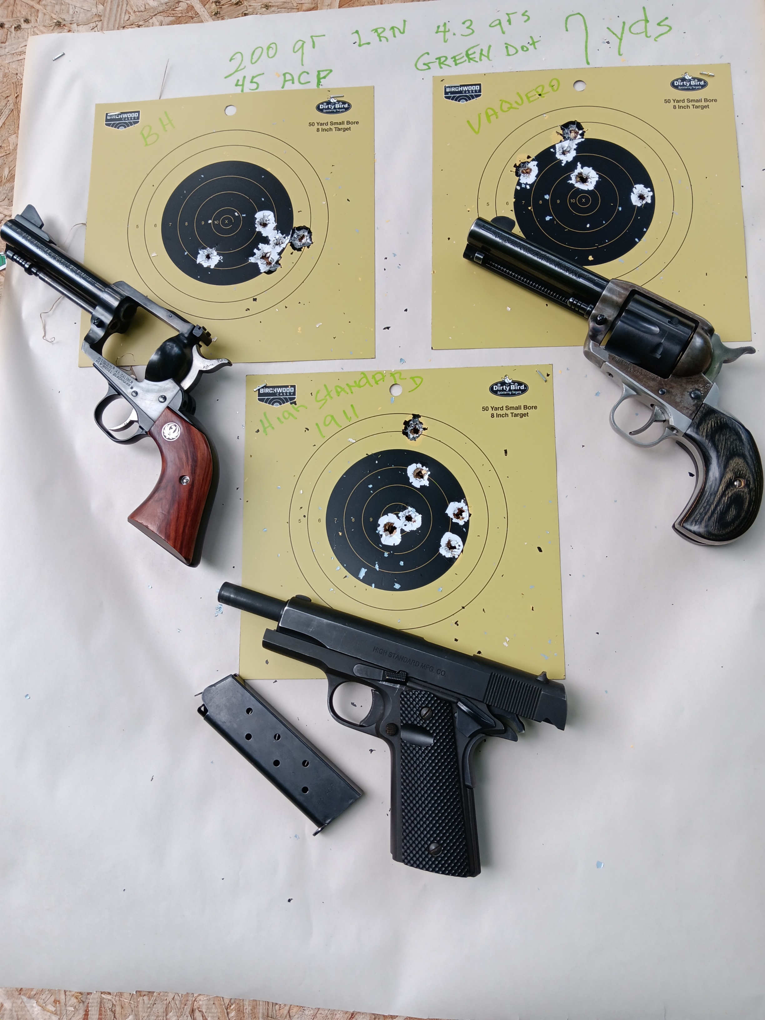

Last weekend I was moving some stuff around under the bench and came across a big handful of 200 gr rn 45 bullets that came from Mb co. I decided to stuff in some 45 acp brass.
Half with 4.0 grs of Red dot and the others with 4.3 grs of Green dot.
So just a short while ago I went down to the barn and try 'em out.
I have a Ruger Blackhawk convertible and the acp cylinder works as well in the Vaquero as it does in the BH.
I also brought along the High Standard 1911 for good measure. Both loadings worked fine in the 1911 with no hiccups.
Roughly 7 yds. The GD load was slightly milder than the RD, but both were quite mild. Like something you could literally shoot all day.

Thanks guys, I didn't know what to expect and was surprised.
Al, I haven't seen any around here in a while of any flavor.
I've had a couple of the 357/9mm.
Tom, I didn't realize they made those, that'd be neat.
Gene, I bought the grip frame from Midway and swapped it out my self.
It's a little proud on the left, but I'm not Forty. ;) :D
I like it other than that, it doesn't really bother me much as it's a shooter not a show piece. :lol:

Well if you can't find Red Dot the Green looks to shoot about the same. Good test Randy!
