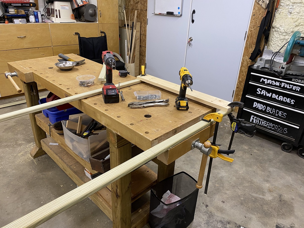

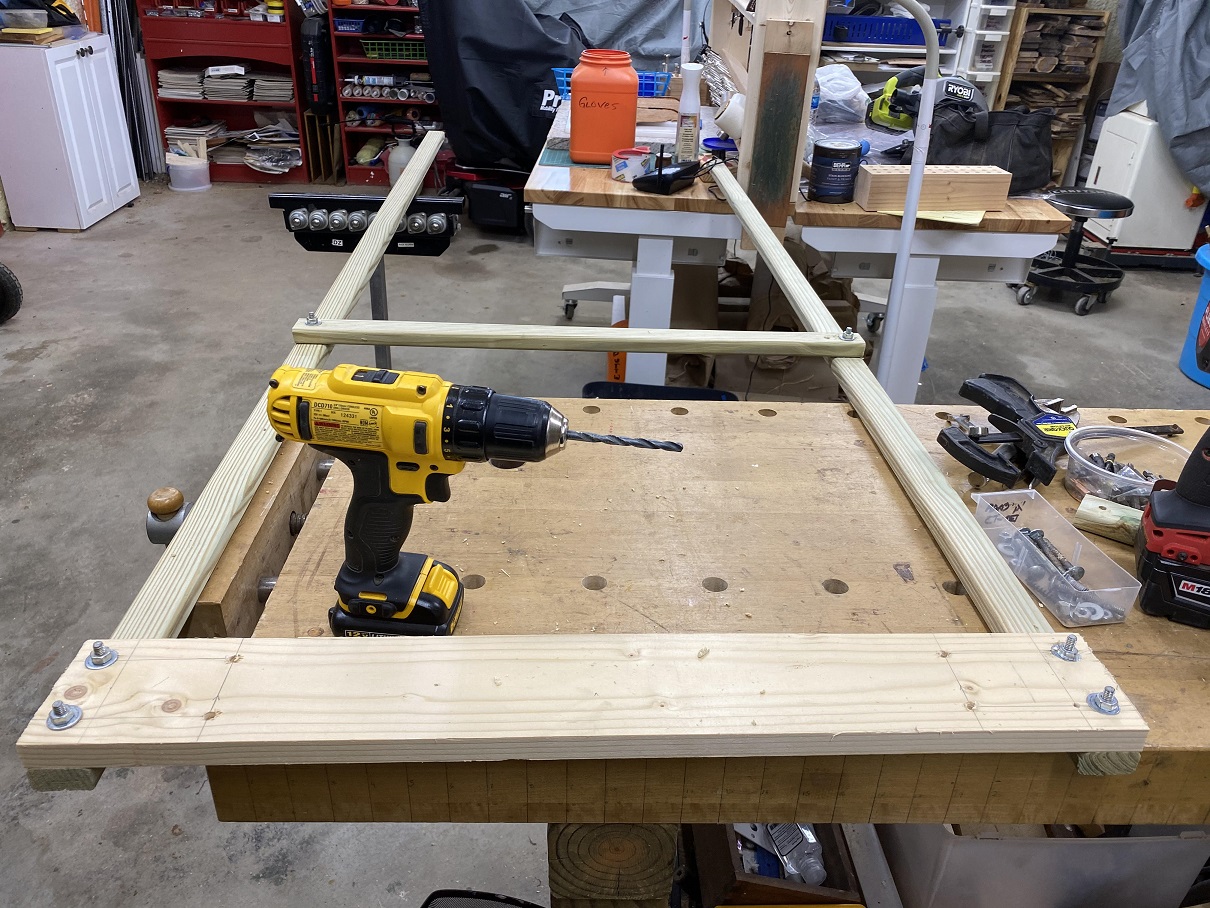

The first step in the build is to drill your 1/4" holes for the carriage bolts. I marked the ends of the furring strip cross members 3/4" in and 3/4" down and drilled the holes. Note that I inserted a carriage bolt in the first hole after drilling to insure the pieces didn't move when I drilled the second pair.
01 cross members.jpg (469.24 KiB) Viewed 952 times

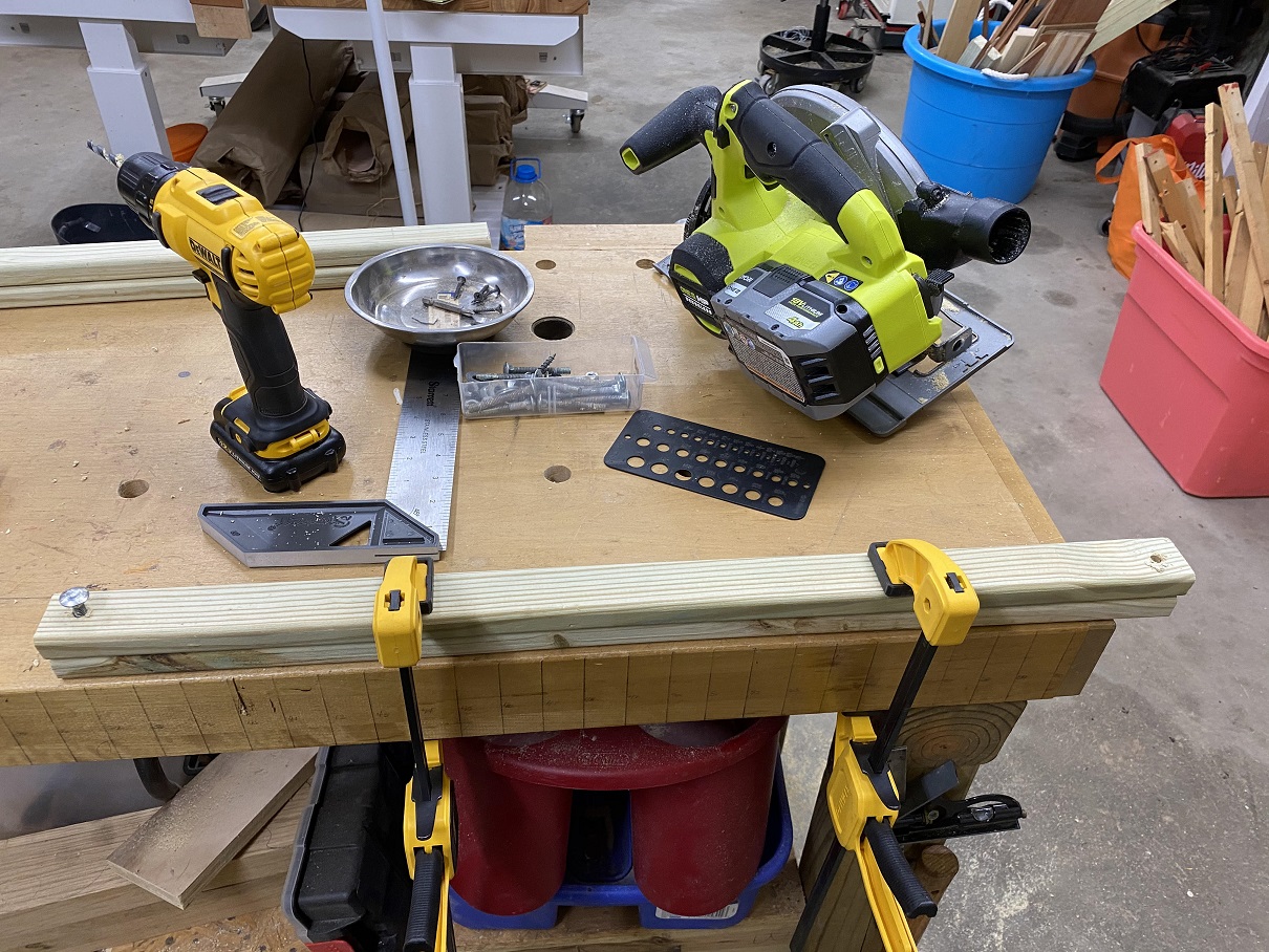

Mark the ends of your 1 x 4 3/4" in and 3/4" off the top and bottom. These are the location of the holes for the sides to attach. Drill these holes as well.
On your side rails, measure up from the bottom 24" and mark both rails at that location. This will be the bottom edge of the center rail. We have NOT tried to drill matching holes in the side rails. We will begin the assembly with the 1 x4 bottom rail as it will insure stability with the double bolts on each side.

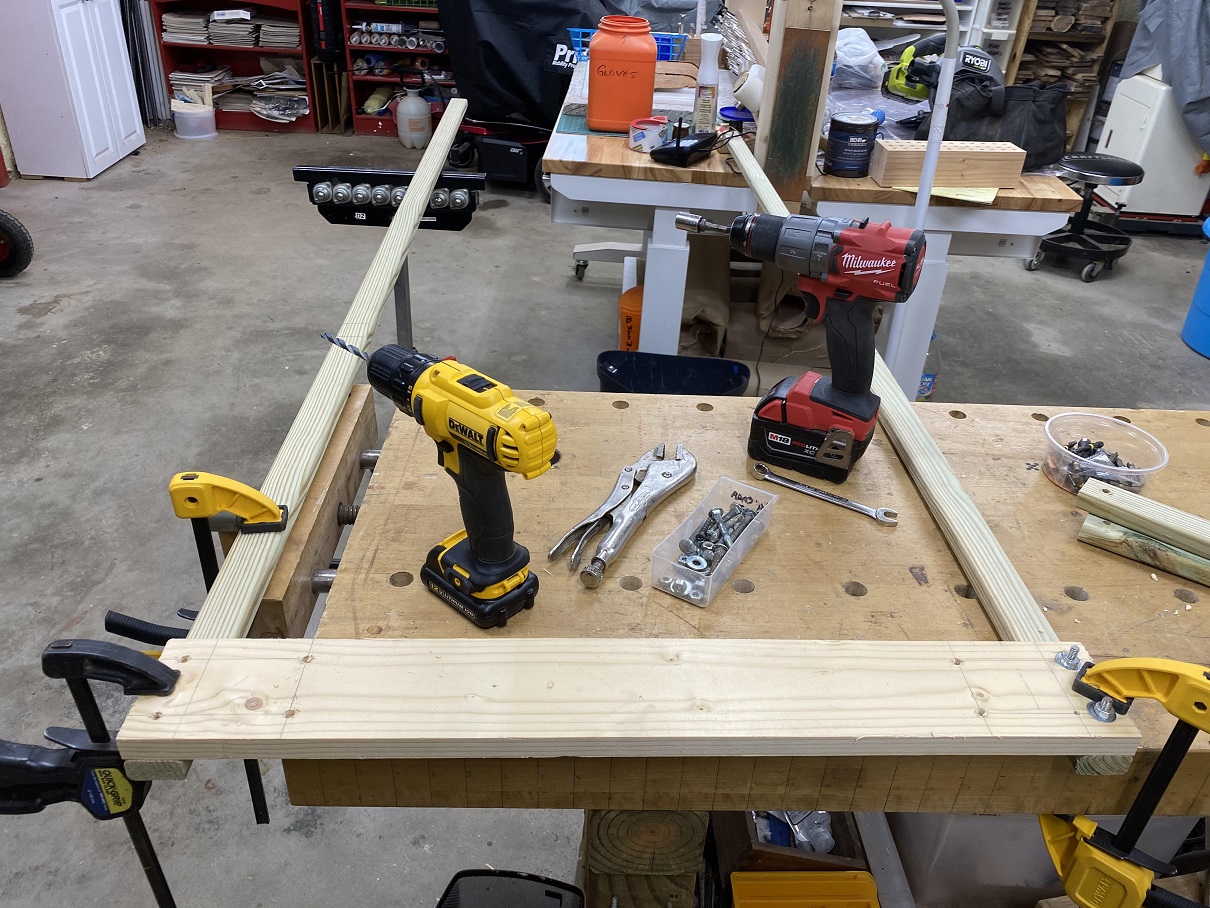

Line up the side rail under the crossmember and clamp. Insure the rail and crossmember are square. Drill the side rail hole using the crossmember as a guide and drill the upper hole first insuring the components don't move. Insert a carriage bolt down thru the hole and place a washer and nut on the bolt and tighten. Drill the second hole and repeat.
* IN these pictures the carriage bolts are incorrectly installed, they should be installed DOWN thru the 1x4 with the washer and nuts on the underside. Installed as seen they will interfere with the target laying flat. (Here on the base isn't critical, but on the center and upper crossmembers, it makes a difference. I had to go back and reverse mine. DUH.) :oops:

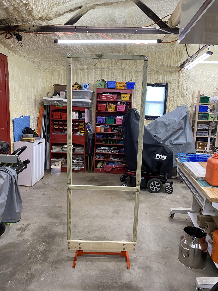

Once the lower 1 x 4 crossmember is installed... clamp and install the center crossmember. The carriage bolts go DOWN thru the crossmember into the side rails. (DUH) Move up and install the upper crossmember as well.
04 attaching cross members.jpg (436.7 KiB) Viewed 952 times

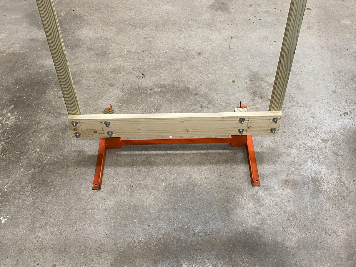

As you see here on the base, the feet are installed with double bolts in each leg for stability as well. You can see how they fit into the welded base. It makes for a stable arrangement. (The feet measure 6-1/2" when you cut them, 3-1/2" are the width of the 1x4; the feet protrude 3" to match the depth of the slots in the base.)

In this picture you can see that I have reversed the carriage bolts in the frame and the target will lay flat as it should. I didn't bother with the lower bolts as they don't affect the target backer position, but if I built another frame I would insure all the bolts faced the same way. I'm anal like that.
06 filler.jpg (517.05 KiB) Viewed 952 times

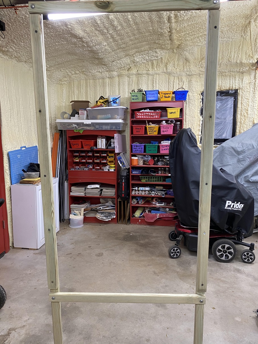

This picture of the completed frame still shows the reversed bolts, but you can see the completed frame anyway... You get the idea.
07 2nd b27 frame done.jpg (519.65 KiB) Viewed 952 times

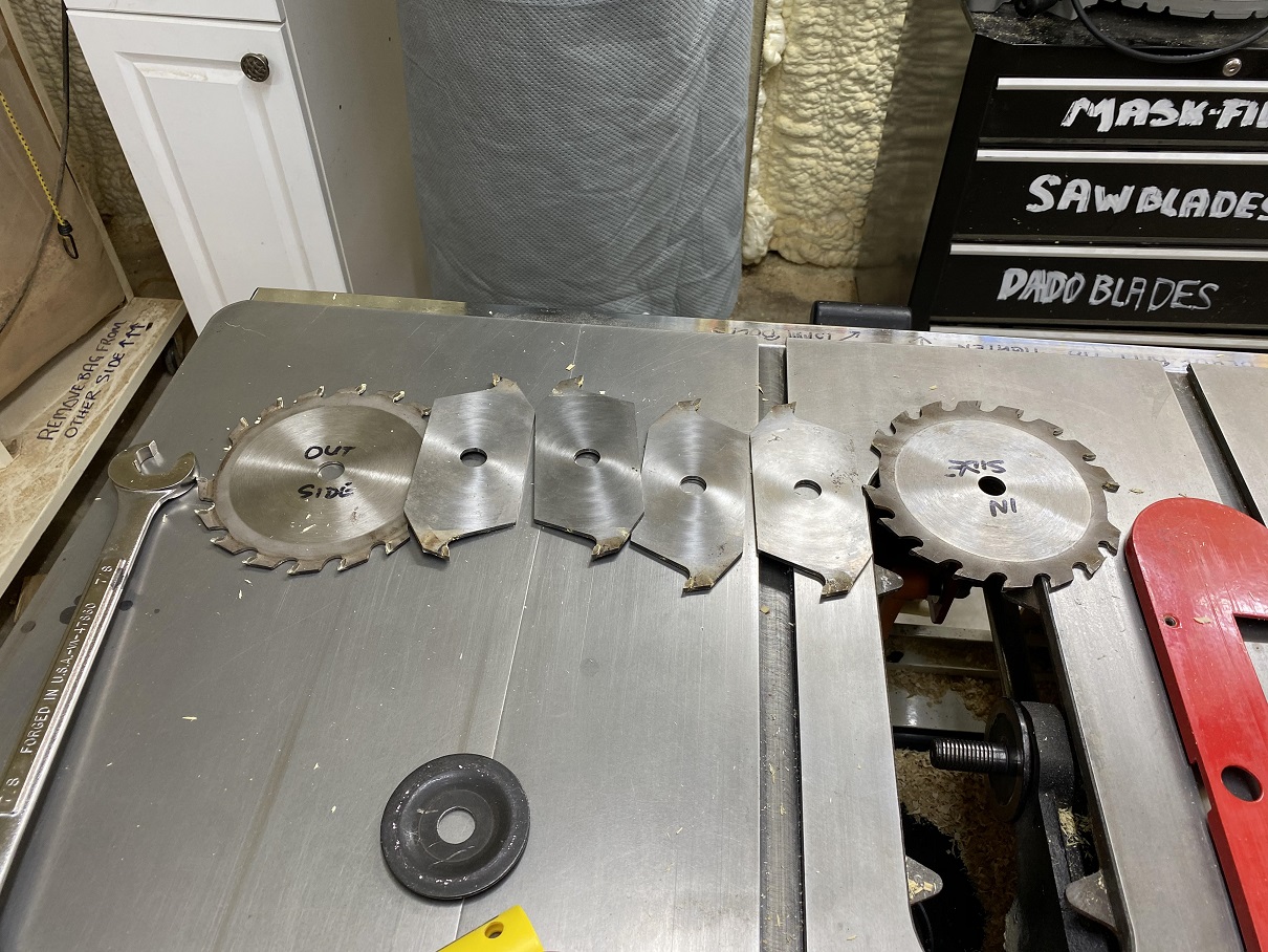

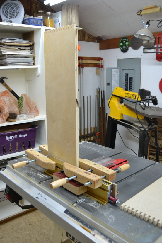

There are just two sets in there, but BOTH were fairly expensive and I didn't want them getting knocked off a shelf or visitors messing with the boxes. One set is "Stackable" to cut dadoes from 1/4" to 3/4" wide. The other set was purchased to go with a finger joint tool Miss Tina gave me for my birthday one year... for making boxes and drawers. it cuts perfectly FLAT dadoes. The resulting joints are beautiful.
The "Box" or "Finger Joint" tool slides on the table saw and works well once you learn the setup and technique. I made all the drawers in a huge cabinet with it, plus a number of other drawers over the years.
The tool is called the ibox. Here I am cutting the Front of the drawers for a large cabinet.

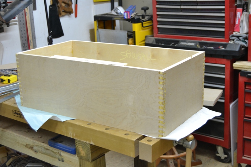

Gluing up the drawers

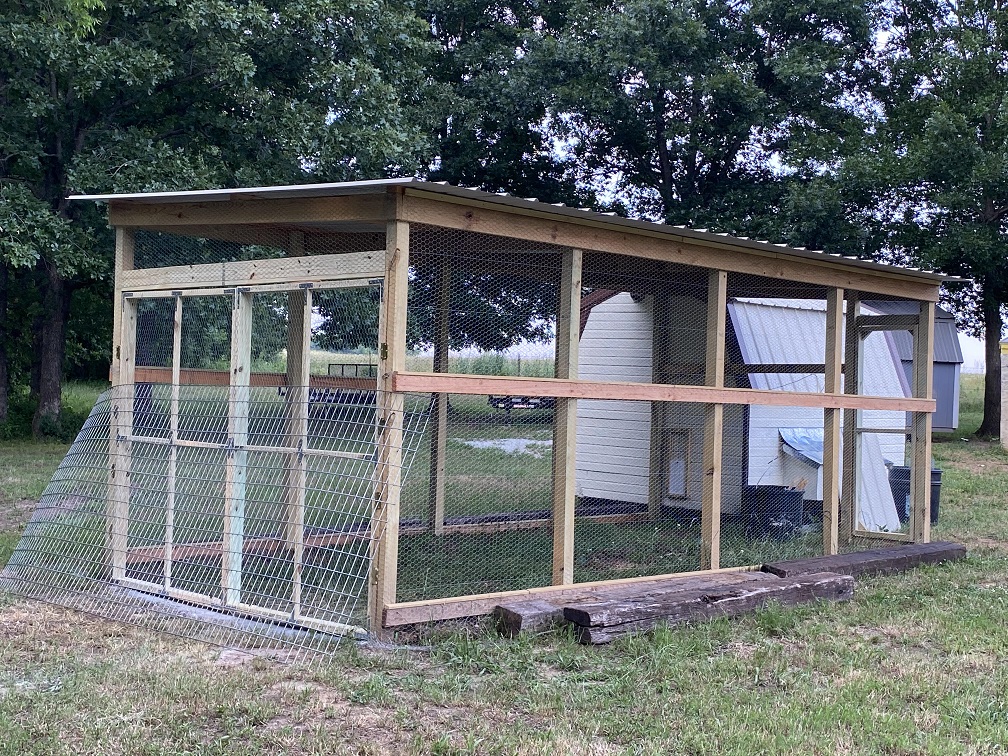

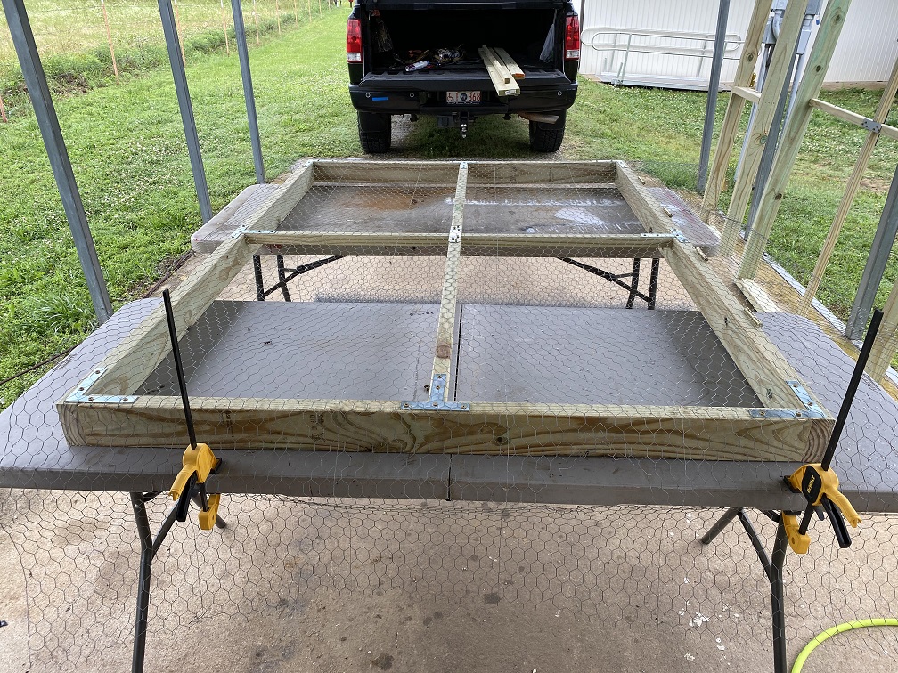

The Stackable dado blades, last used making the gate frame on Miss Tina's run for the new coop. I used it to dado the inserts for the gates so they would be stronger.
The two gates span an area ten foot wide and nearly eight foot tall. We wanted to be able to drive the tractor in thru the open gates to clean out the run a couple times a year or add limestone or earth. Makes life easier for Miss T.
