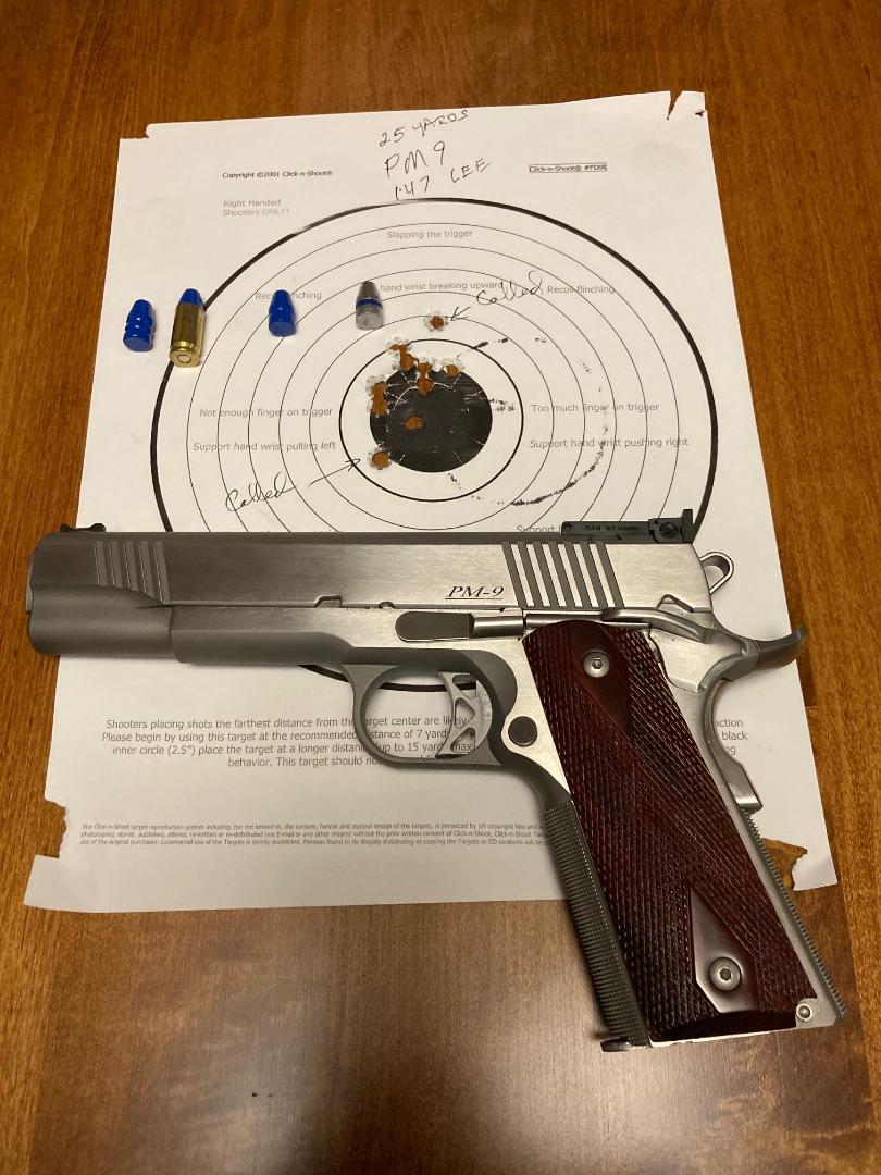

I've got a pair of Dan Wesson Pointman 1911's. The PM 45 has been spooky accurate from day one with both jacketed and cast bullets using some of the old time proven .45 recipes. The 9mm shoots in the one inch or less category with jacketed bullets but I've been struggling to match that accuracy with cast bullet loads. I had high hopes for the RCBS 124 TC (uncoated with blue lube) but so far not so good. I've long been a fan of the 120 Lee TC and it's my go-to bullet in the Homesteader carbine. Now Lee took the same bullet and added a driving band which brings it to 147 grains. I casted up a few and sized some .356" and the rest .357". The barrel slugs at just under .355". Coated with Signal Blue powder and loaded over 4 grains of BE86. Bingo!
The 147 is the on the left side.
This is 10 shots at 25 from a wrist rest with 5 of each diameter. It was sweltering hot with not much air moving on that end of our outdoor range. The heat and a wobbly old man at the controls account for the called flyers. With a good rest and a better shot I believe this load would do well under an inch. The .356" were trying to ragged hole. The rest of the 147 gr. loads were used up spanking the plate rack. :D
