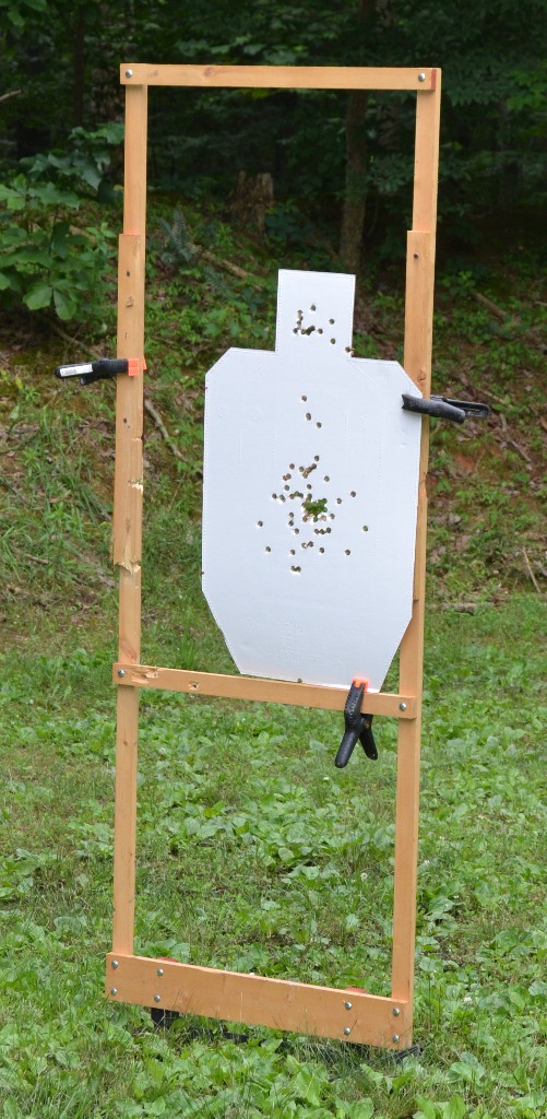

Too hot to shoot, so I jumped in the shop where the AC was running and knocked out some new target frames for the range. I have been using the steel bases that the wood frames fit into and I have six or eight... but slowly but surely over the last ten years or so, Students have shot up the wooden frames. I have, I think, three left. They are sized for the LE Qualification targets, the B27. So they are fairly large, heavily built to stand up to the abuse they have taken over the years, and have lasted. The targets I shoot these days are usually the Q, or "Bottle" target as it's sometimes known. If not those, I just stick up some cardboard and staple a paper plate or piece of typing paper on the dang thing. I do have B27 repair centers, but they don't need that big frame either.
For those who don't know, this is/was the standard LE Qualification target in use when I was teaching and the target used for PPC competition. The old B27. We know one another well.
revolver and speedloaders.jpg (202.32 KiB) Viewed 1533 times
Here, on the home range in VA, I had set up to teach a new Game Warden in preparation for his trip to the academy. He was new to shooting and we started on the Q target. You can see how they didn't really fit the B27 frames. After three days of coaching, he was a lot more confident in his ability to pass the shooting portion of the academy. He listened well and shot well enough that after the additional training at the academy, shot "Sharpshooter." Not bad for never having held a firearm before our time on the range. (He was from New York City.) :roll:

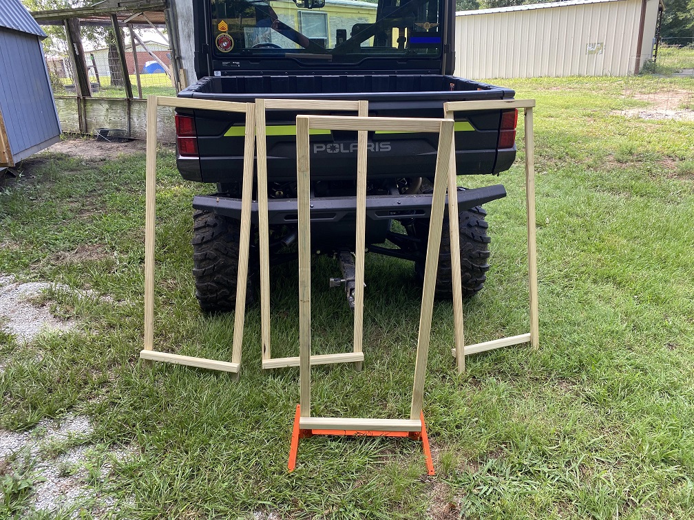

I laid out, then cut and assembled four new frames sized exactly for the width of the Q targets. I used the leftover furring strips from previous projects, and some leftover 2x2s from a couple projects. Cost for the new frames? $0. I'll knock out a couple B27 frames to replace the shot up two that are remaining when they finally fail completely, salvaging the hardware. These new frames are nice, weigh in about 1/3 what the old ones do. In the next Range Report, you will see the them in use.
I set up four so I can set up for two shooters to shoot two targets at once.... I don't see more than two shooters on my home line in the future.
230625 new Q target frames.jpg (504.95 KiB) Viewed 1533 times

I had knocked out the 4 frames, and assembled them with the brad nailer and got to thinking that ... maybe the impacts from all the rounds would loosen them up. So I pulled those four frames and the two remaining B27 frames back up to the shop, along with the big collection of cardboard still waiting to be cut to targets, since it was so hot outside. Sounded like inside work.

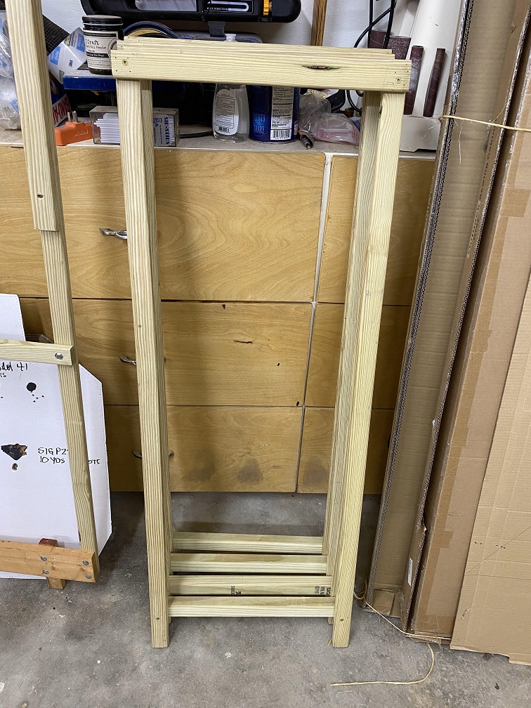

The IDPA frames:
01 IPSC frames.jpg (394.97 KiB) Viewed 1486 times

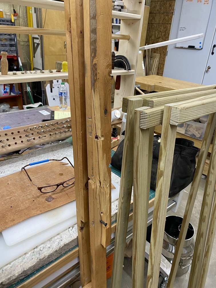

The damaged B27 frames in need of repair:
02 b27 damage.jpg (339.99 KiB) Viewed 1486 times

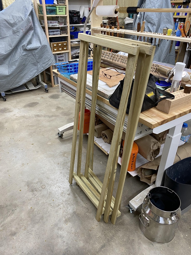

I started my repairs by adding a screw to each corner of the IDPA frames to strengthen the joints made by the brad nailer. I used 1-1/2 screws that went almost all the way thru on the top and nearly thru on the bottom. You could feel it pull them tighter. :P You can see the torx head in the corners in the pic.

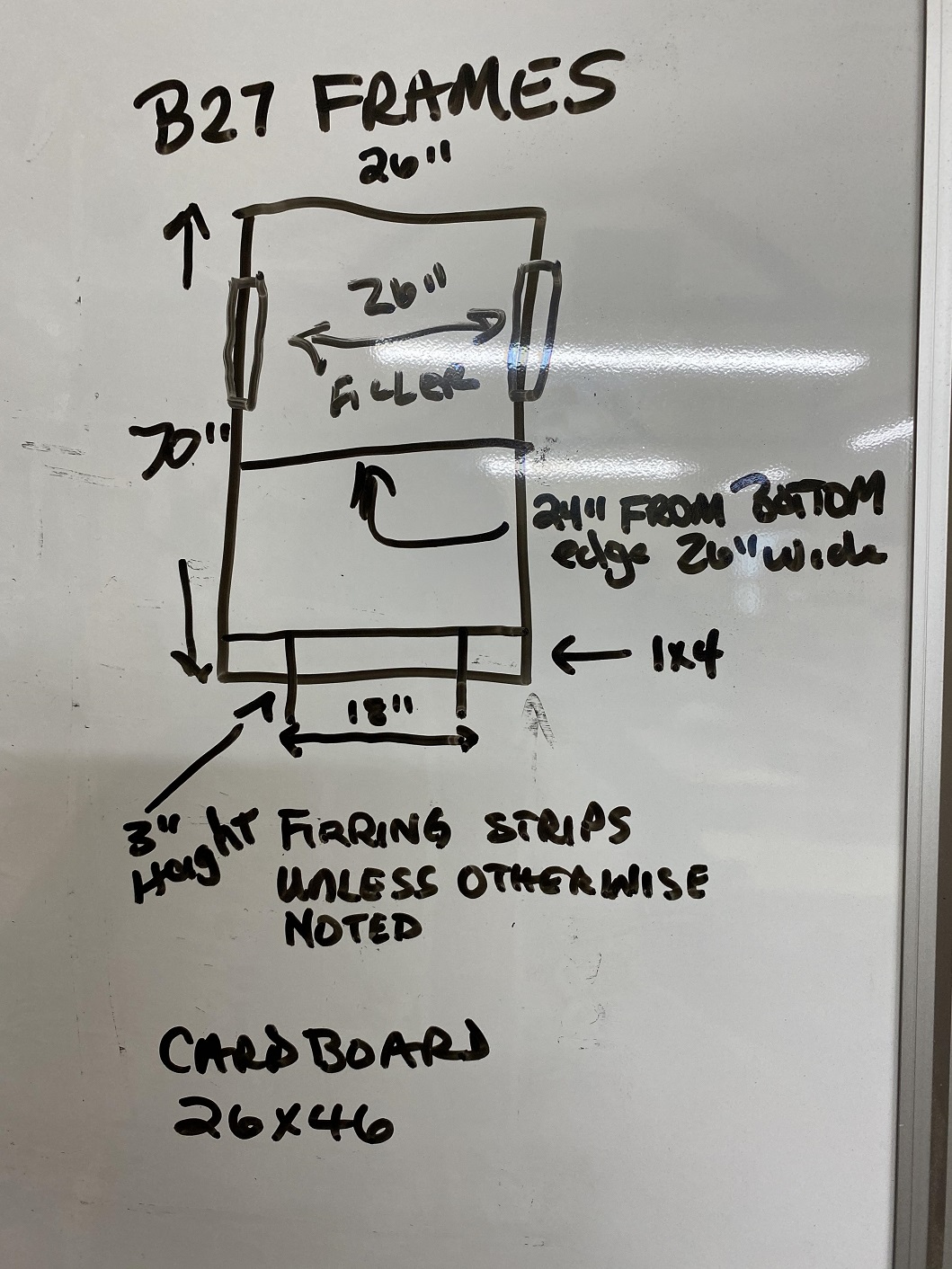

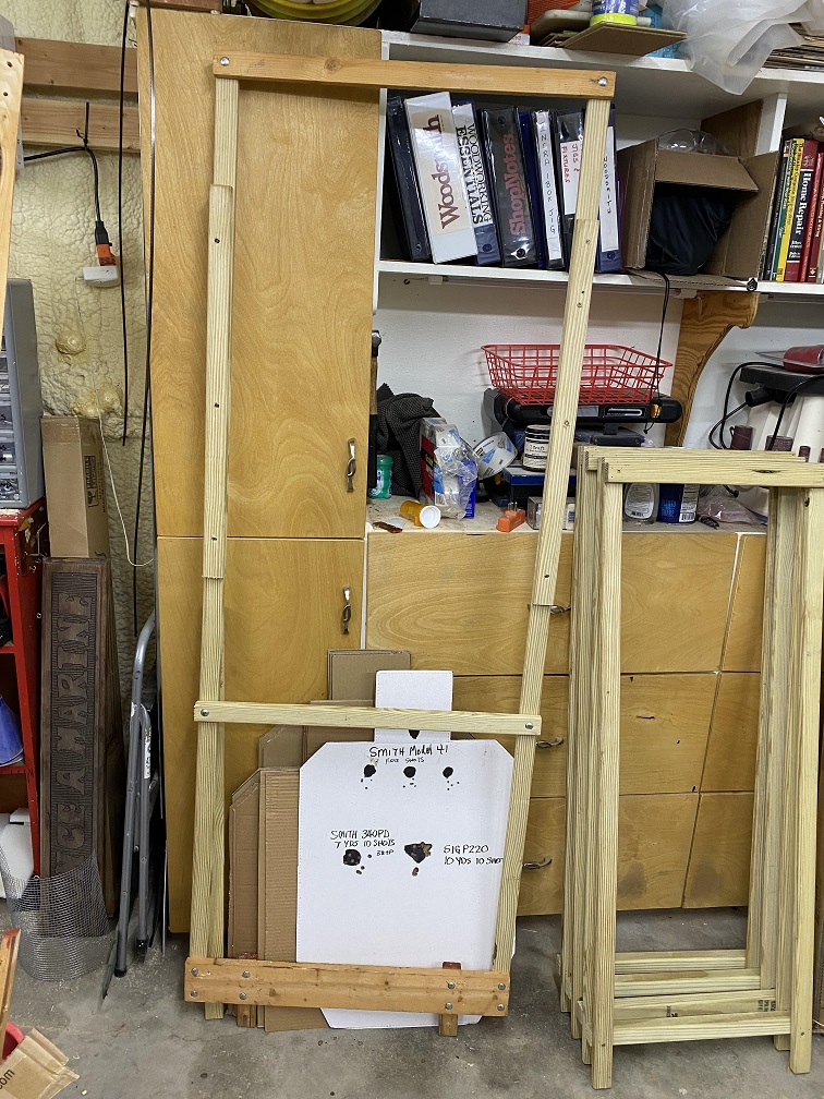

I checked both the remaining B27 frames and one of the two only needed the two 70" vertical sides replaced, and the center crossbar. I'd also be replacing the 26" vertical spacers on both sides that went under the edge of the target backing above the crossbar, which had been shot badly. Before starting, I made careful measurements and noted them on the dry erase board.
05 b27 diagram.jpg (401.15 KiB) Viewed 1486 times
I then disassembled one side at a time, and used the vertical side as a drill template to drill the new 70" side rail. Fit well and went smoothly. I reinstalled the side rails but left off the cross member until I could cut a replacement. Then it was installed as well, using the removed crossmember as it's template.

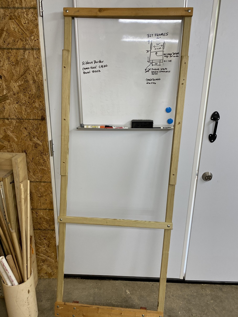

The repaired B27 frame:
06 repaired b27.jpg (315.47 KiB) Viewed 1486 times
The second frame was too badly damaged for repair, and I disassembled it completely saving the hardware. Next home depot run I'll pick up additional furring strips and build a second frame so Miss T and I can both shoot at the same time if need be. SHE won't be shooting at B27 qualification targets, but we have a large collection of movie posters to staple up and bang away at.

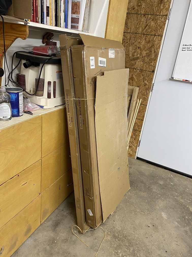

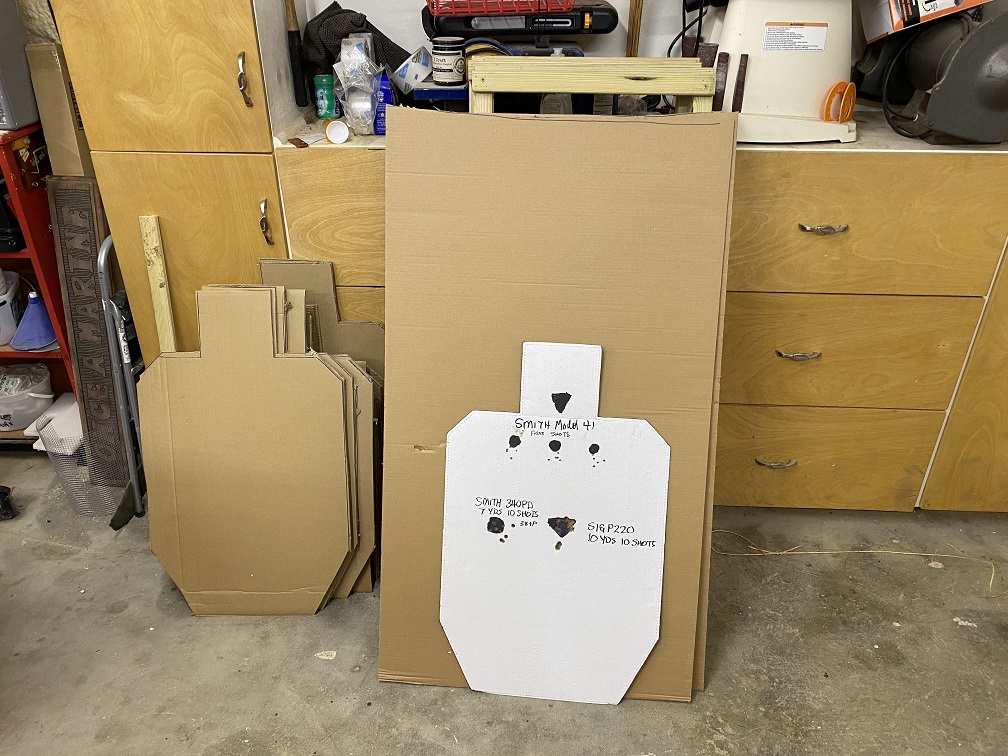

I next went to work on the cardboard supply, using an previously shot IDPA target as a template to mark the large pieces of cardboard for cutting. New blade in the razor knife and off I went.
07 cardboard supply.jpg (328.65 KiB) Viewed 1486 times

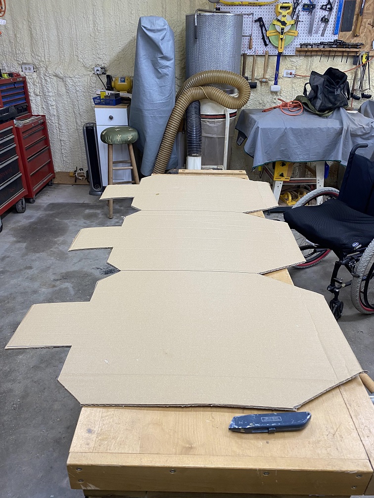

Mark up each large piece with the cutting diagram, and start cutting.
08 cutting out.jpg (341.82 KiB) Viewed 1486 times
After an hour or so of work, I had 28 IDPA head and shoulders targets... and four large B27 Backers cut out. Worth my time? We would have had to haul off the cardboard, or burn it. Fifty of the targets run about $0.75 each. I'd rather reuse the cardboard when I can.
