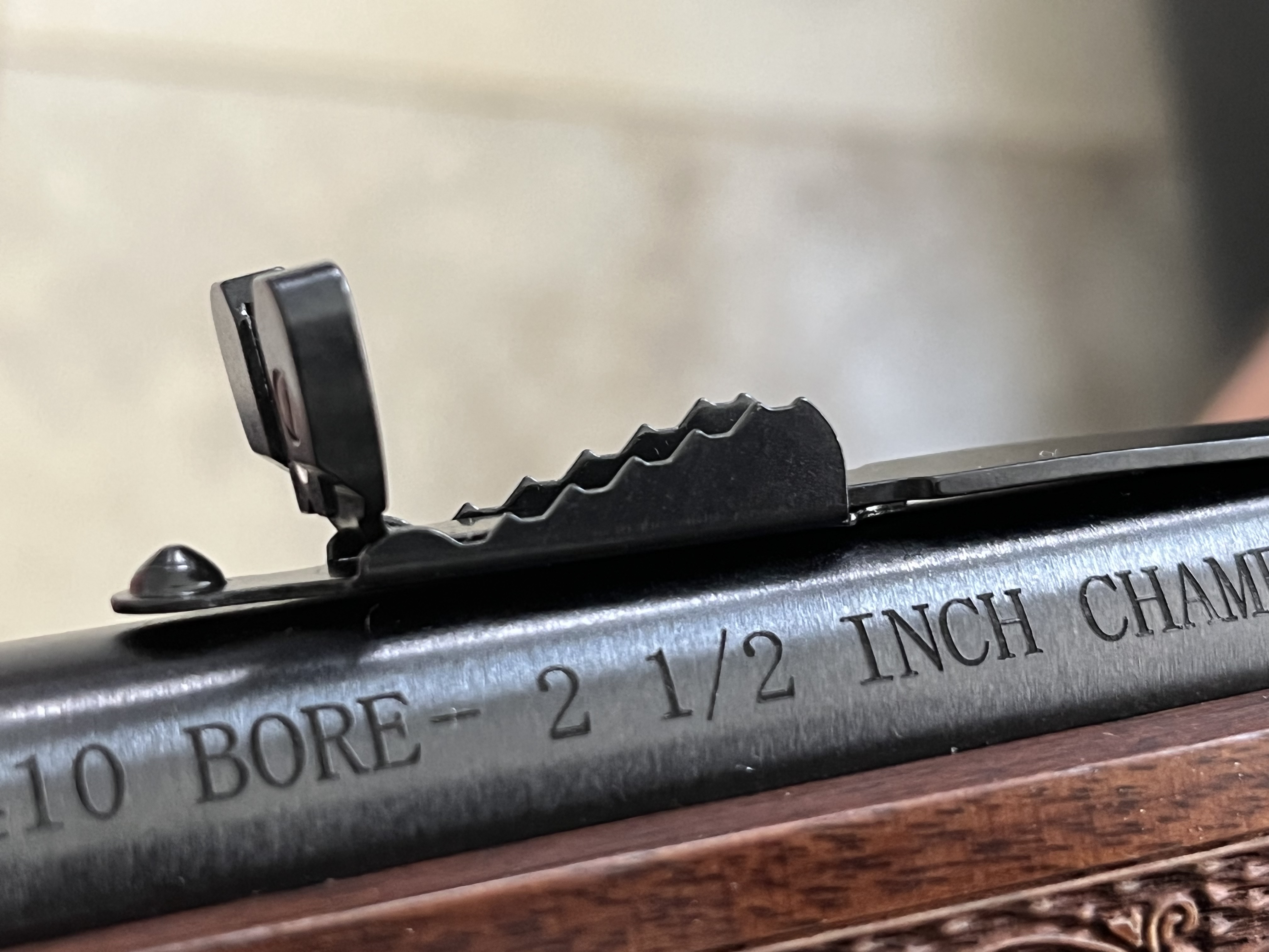

After inspecting my new shotgun I shot it at 35 yards with elbows on the table. All three shots hit about three feet high. The rear sight is on the lowest setting.
I think it needs a taller front sight.

Gene, roughly 3 feet high at 35 is pretty bad. That far off would require a front sight so tall as to look a bit goofy. Generally, that far off on a new gun would have me calling the manufacturer. Before you call Henry, though, I would bench the gun on a bag and determine exactly how high it is shooting, starting at 10 yards to stay on paper, then out to 25 yards or so. I would also shoot some other loads if you have some. Best of luck and let us know how it goes.
And I agree that using point and shoot wouldn't be too accurate and you shouldn't have to settle for that with a new gun, anyway.

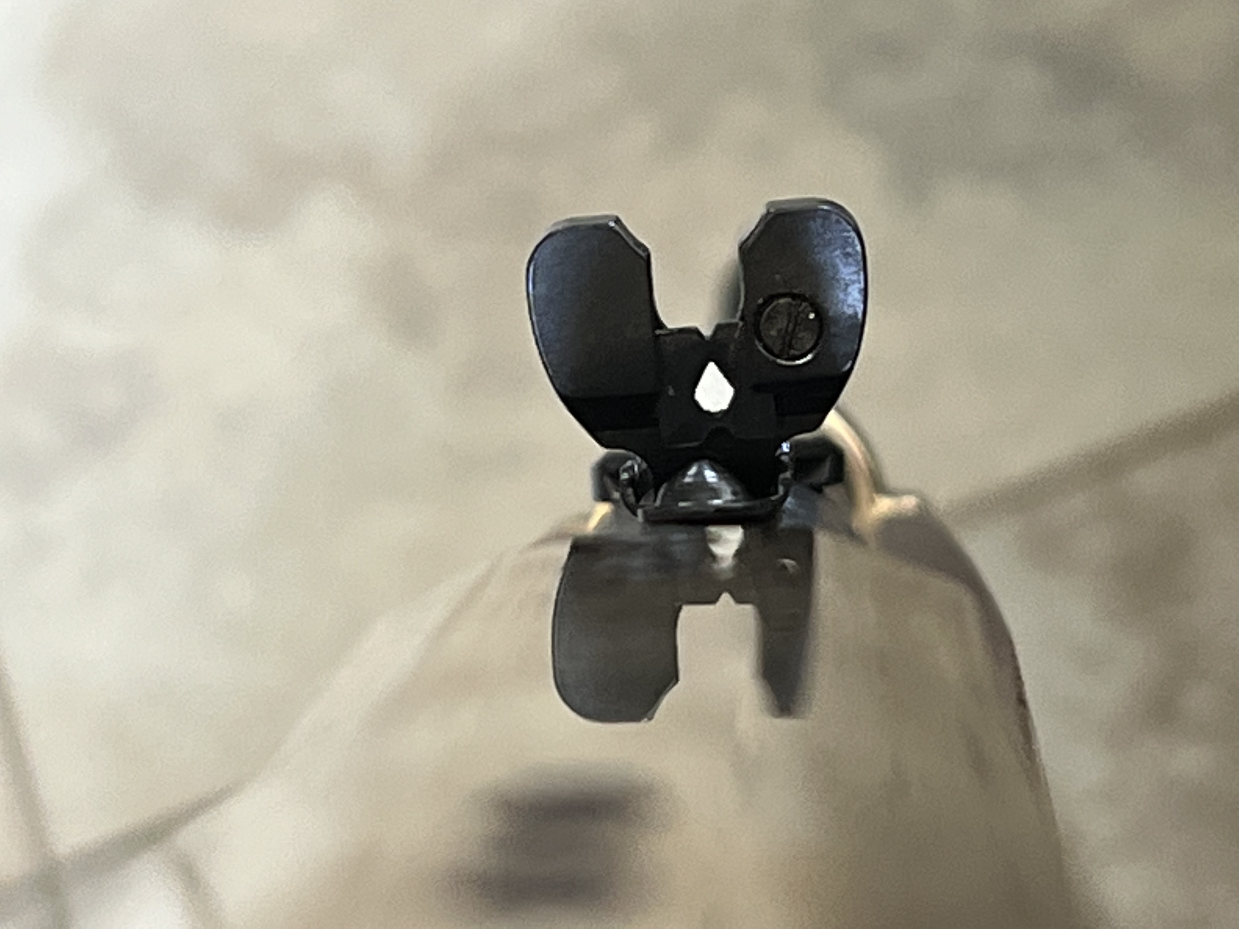

Problem solved. I made sure the ramp was all the way down.
But didn’t check the diamond insert.
Once I lowered it I had plenty of room for adjusting the ramp. I haven’t shot it after making the adjustment.
I’m not liking the buckhorn as it’s a moose. Chances are I’ll swap it for something smaller and more suited for slugs and shot.

I dont care for the white diamond staring me in the face I usually turn that around.
