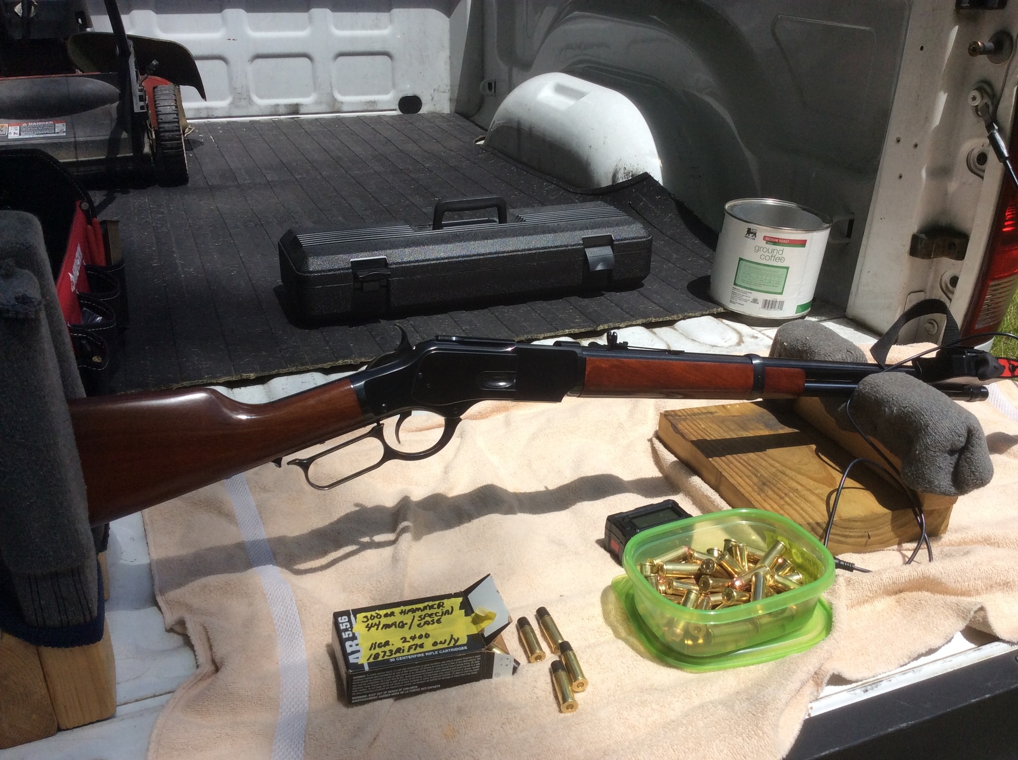

Worked up a load especially for my Uberti 1873 Winchester to shoot a 300 gr. 44 Mag load. The load is based on .44 Special brass to keep the COL under 1.600 where it ended up at 1.580. Powder was 11 gr. of 2400 which is down from 15 gr. when using standard Magnum brass.
The Winchester ate them up with no issues with feeding or ejecting....smooth as hot butter! With my Magnaspeed chrony hooked up the loads were all in the 1100 FPS range which is great for easy plinking with a heavy chunk of lead and very mild to shoot.

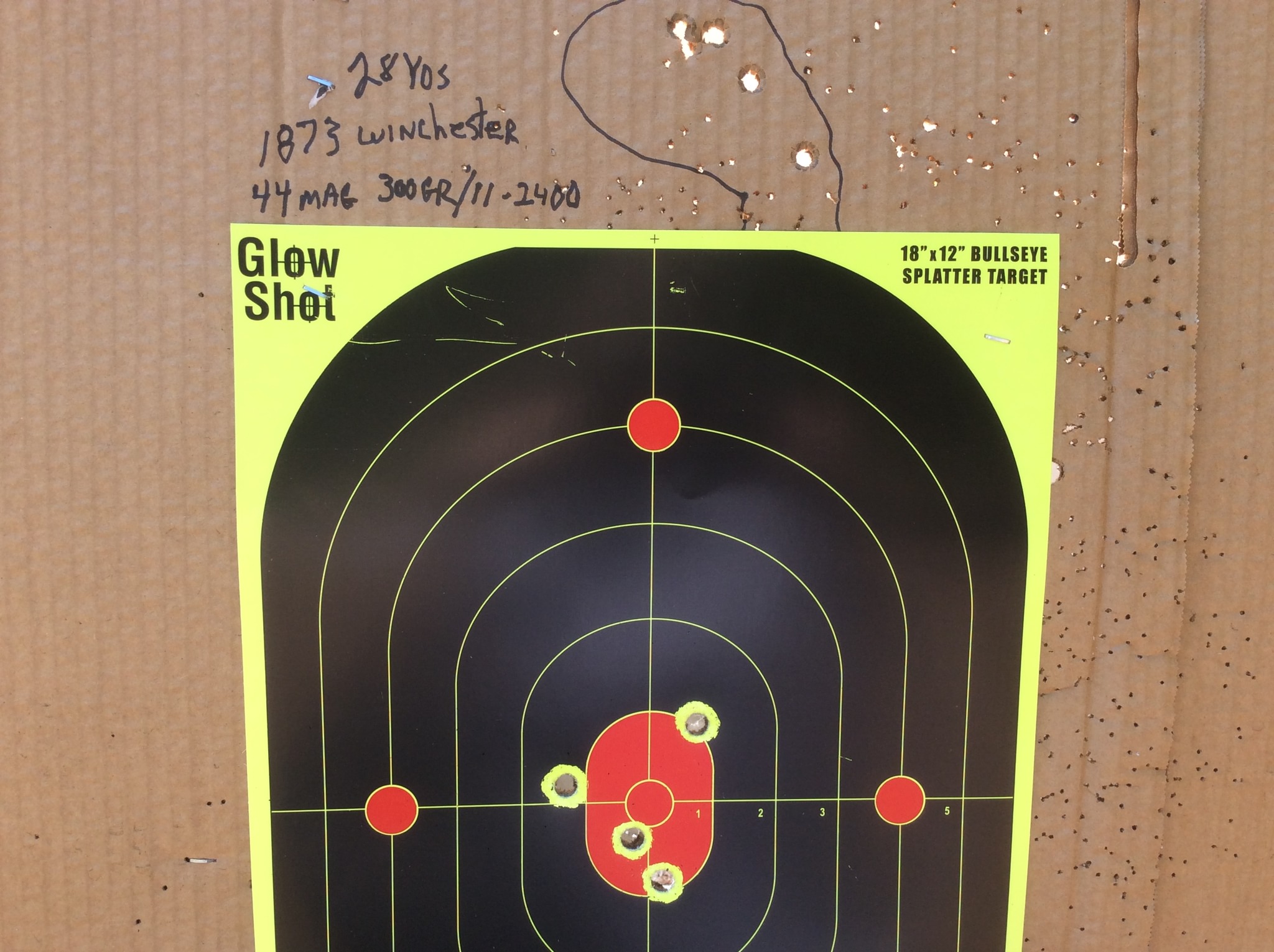

Nice 4 shot group from 30 yds. just to see where it would hit from a standing position and very happy with that. Only loaded up 15 rounds to try and will load more. They shot clean with just some powder or coating particles in the bore....great!

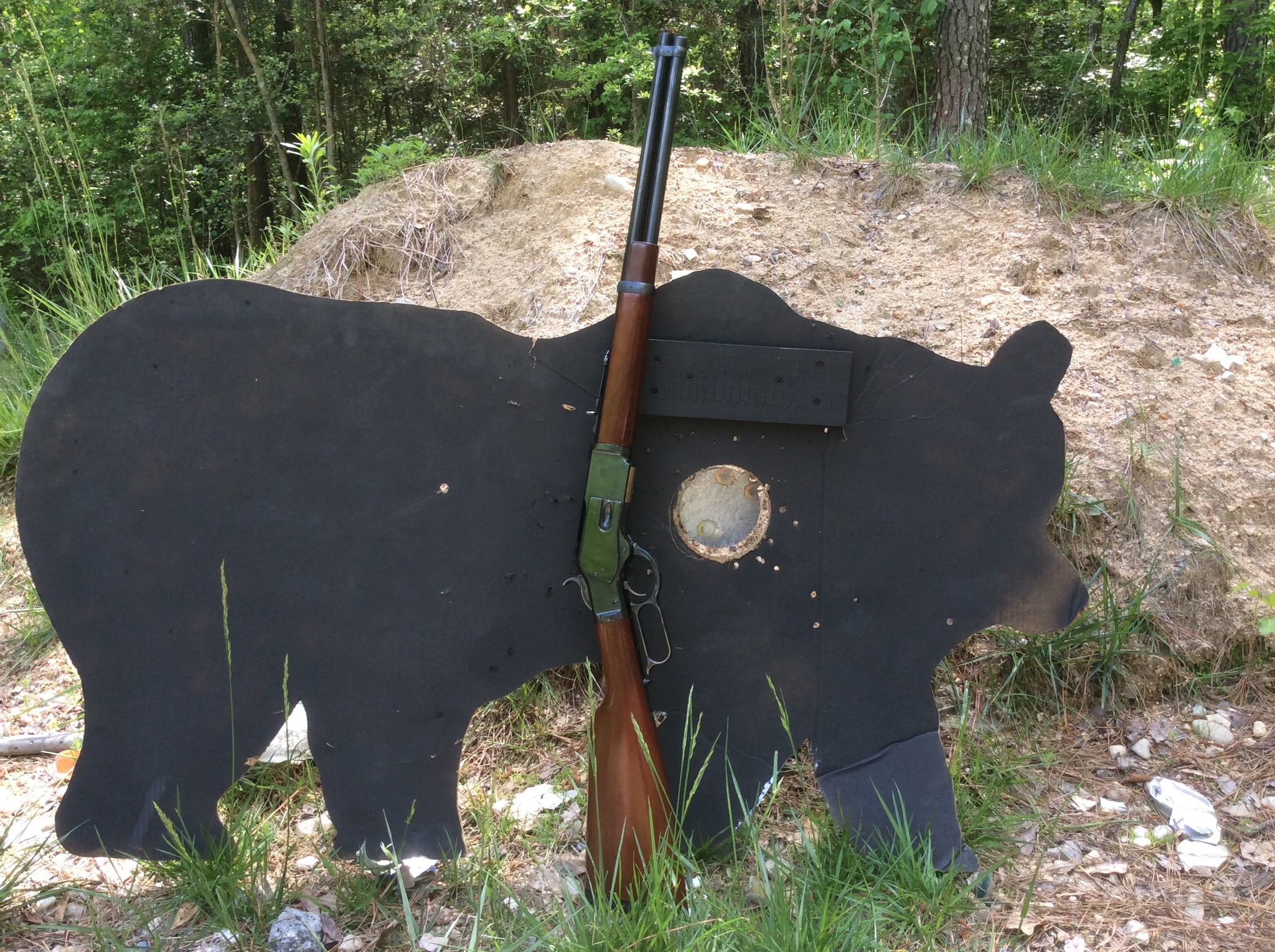

Modified Mr. Bear target with a hanging 4 inch plate and set him up for a few hits. Got 3 good hits on the steel from 45 yd kneeling position....cool!
Had bear propped up but that 300 gr slug would tumble him right down every time when you hit him in the target spot.

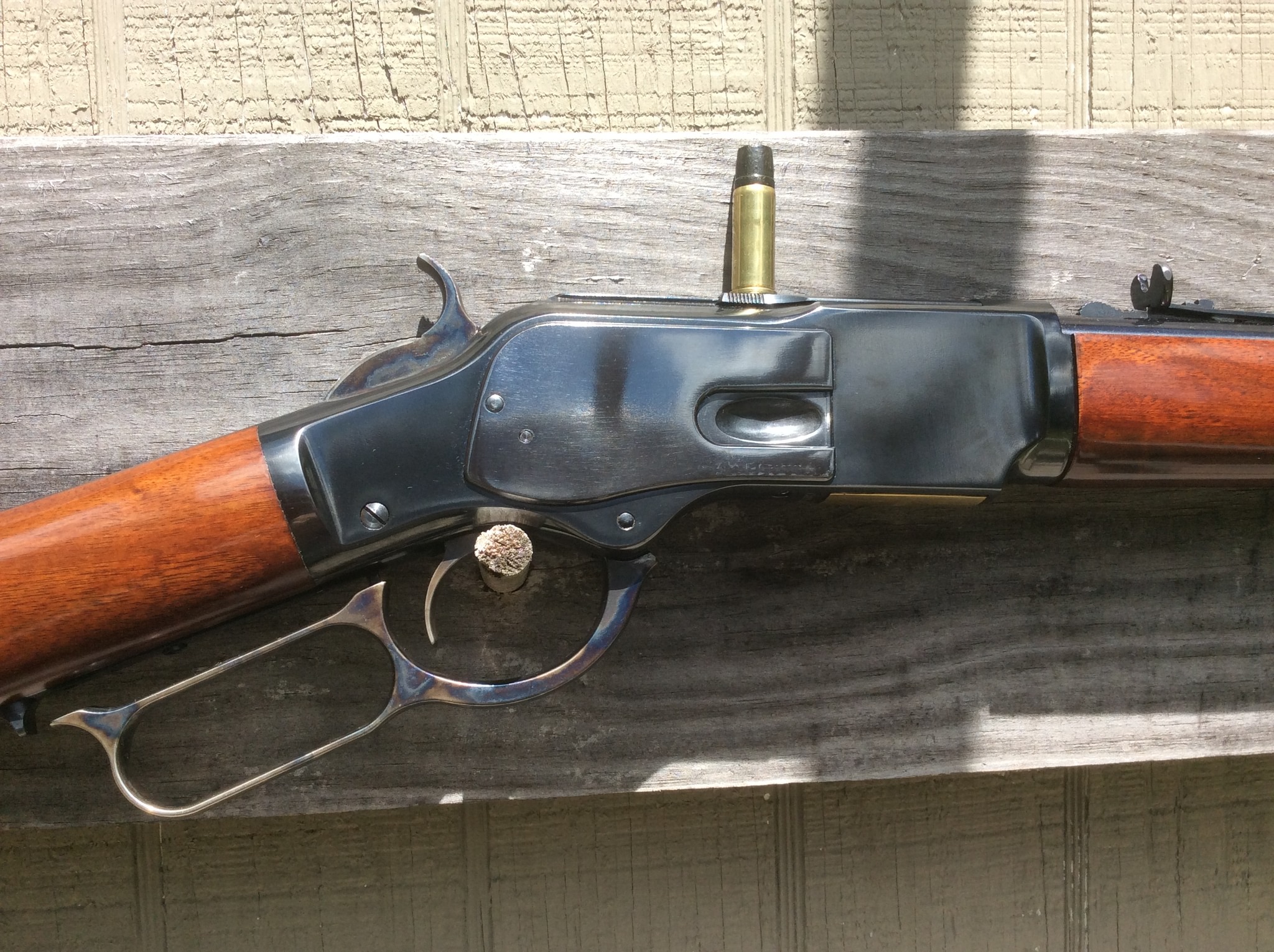

testing new 44 mag load today 5 5 23.jpg (667.16 KiB) Viewed 1130 times
44 mag 300 gr load in 44 special case for 1873 Winchester  4 shots from 30 yds. first shots 5 5 23.jpg
44 mag 300 gr load in 44 special case for 1873 Winchester 4 shots from 30 yds. first shots 5 5 23.jpg (487.29 KiB) Viewed 1130 times
bear hunt with the 1873 winchester 44 mag.jpg (978.71 KiB) Viewed 1130 times

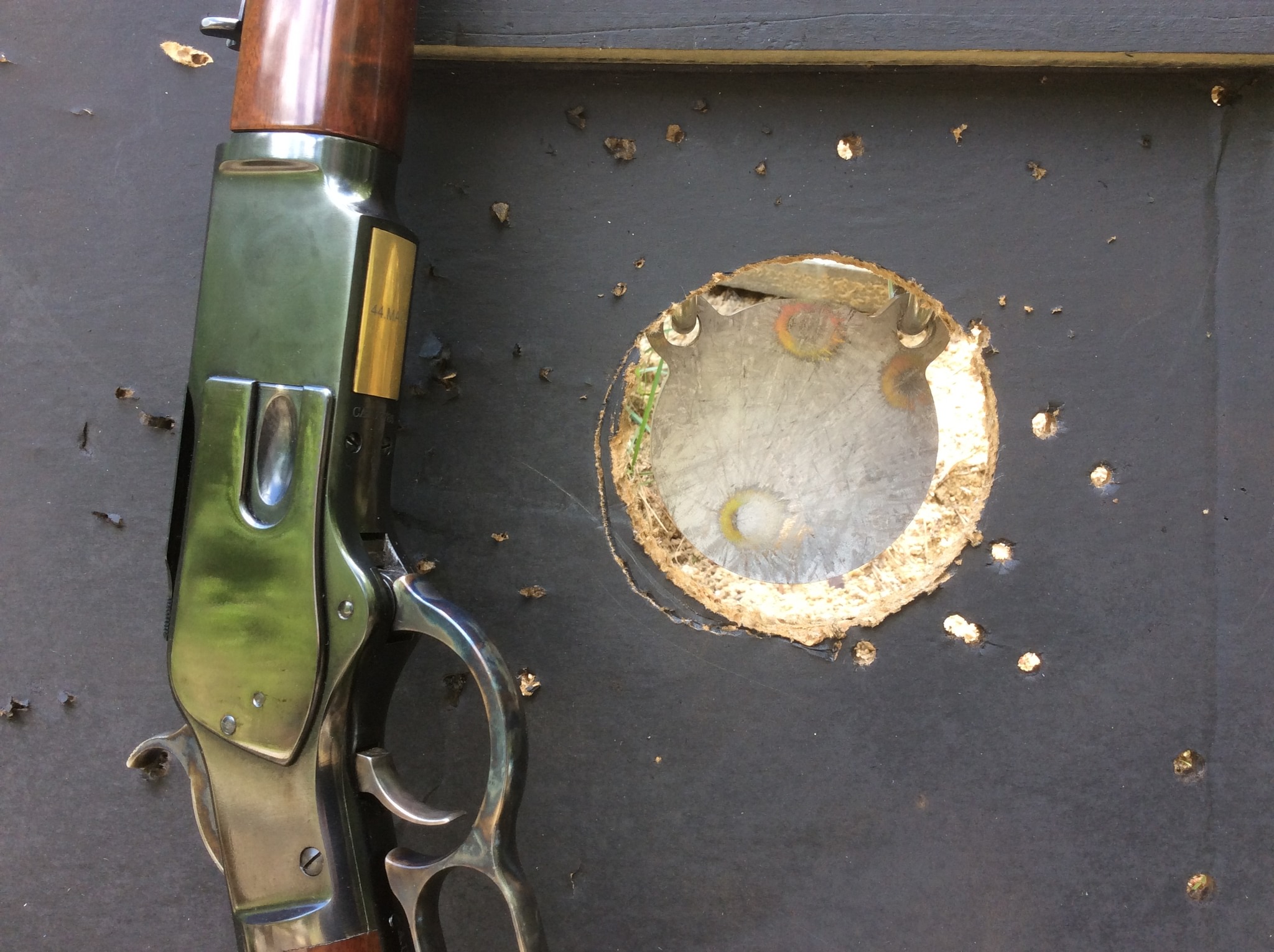

3 good hits on the 4 inch steel from 45 yds 300gr.jpg (557.06 KiB) Viewed 1130 times
great mild 300 gr 44 mag load.jpg (813.66 KiB) Viewed 1130 times
