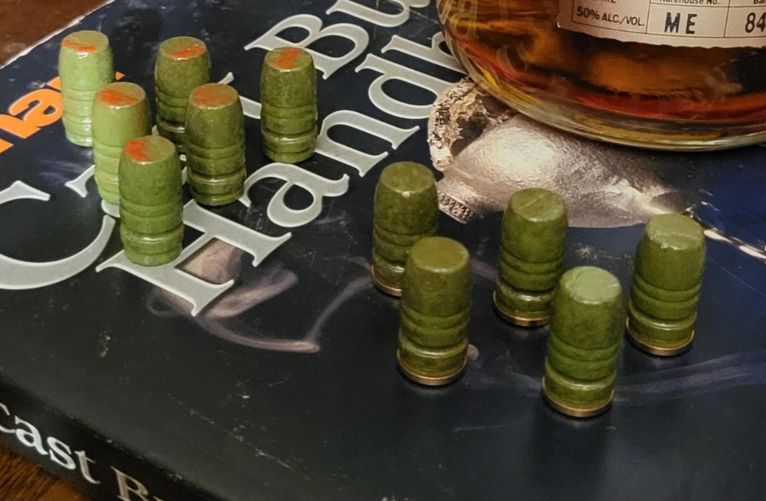

Here are the bullets after powder coating, I added gas checks to have and "was" going to see if or what the difference may be.
This is the gc'd version.

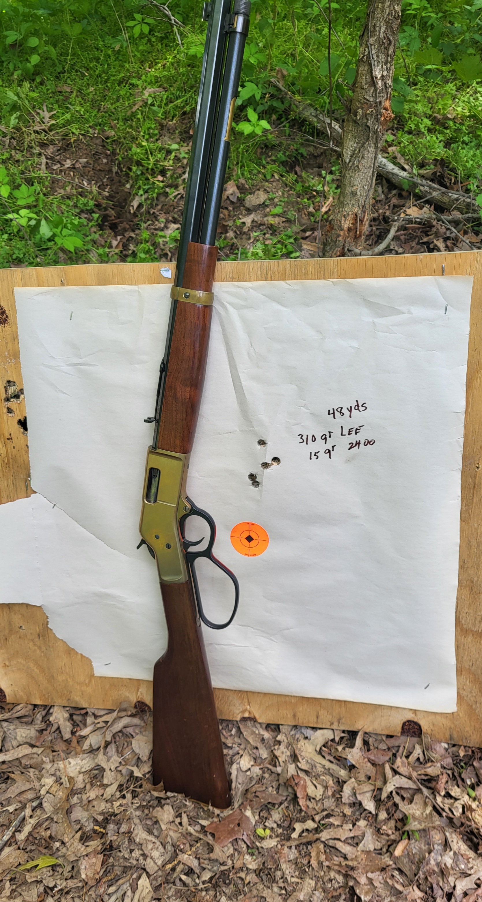

15 grs of 2400
OAL 1.60

Anyway it does look like this mold is going to show some promise.
The SBH didn't do to well at that distance.
I put 5 rds through the Vaquero and it was manageable, but you wouldn't want to shoot it long. ;)

That target looks good for groups. Man sorry to see what the wind did!
Thanks, not bad for the first try. ;)
