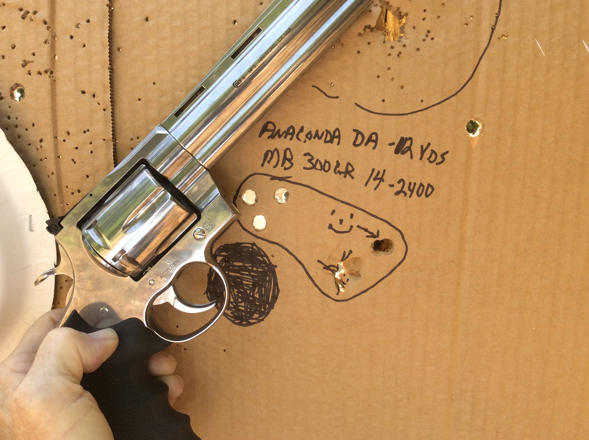

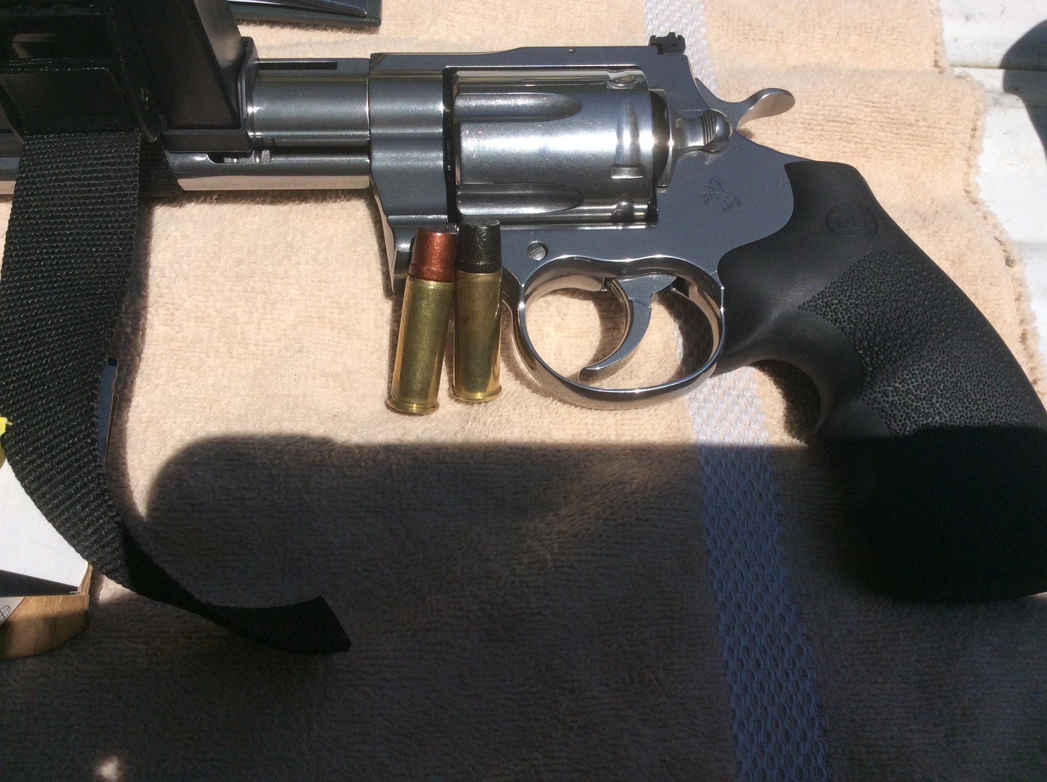

Had loaded some MB 44 Mag 300 gr. Hammers using 14 gr. of Alliant 2400 powder but never got around to check the speed of the load. Also wanted to try 15 gr. of 2400 and compare the two loads.

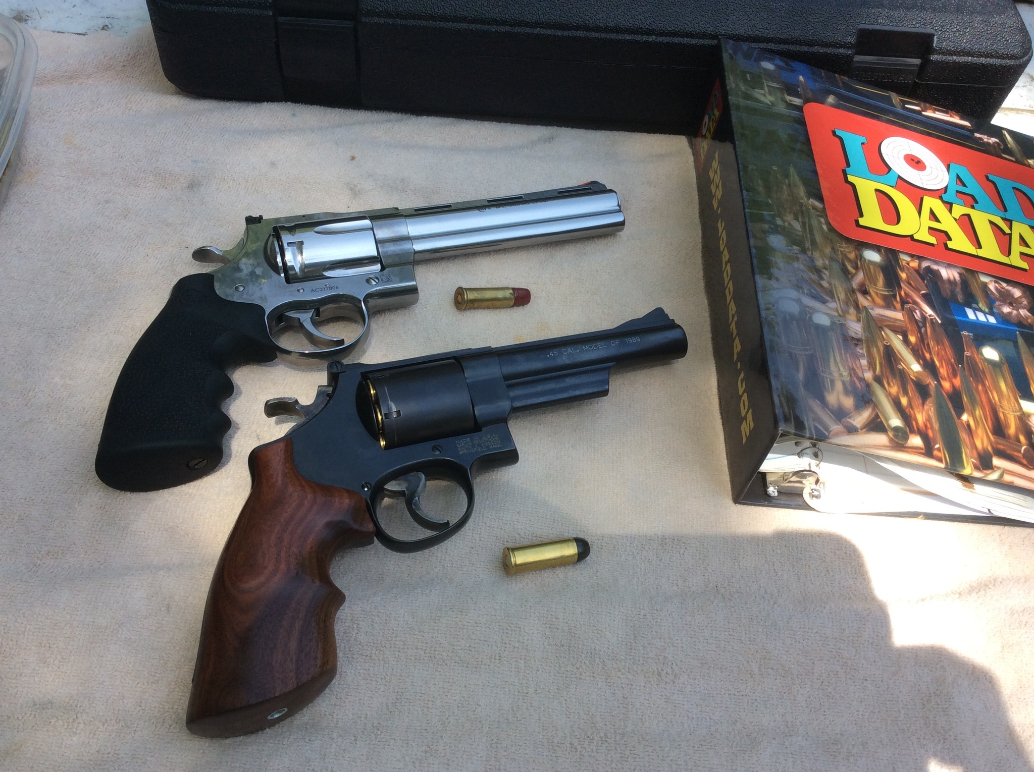

Revolver would be my Anaconda and also brought along my S&W Model 25-7 45 Colt shooter....both very nice DA revolvers the best of what I have.

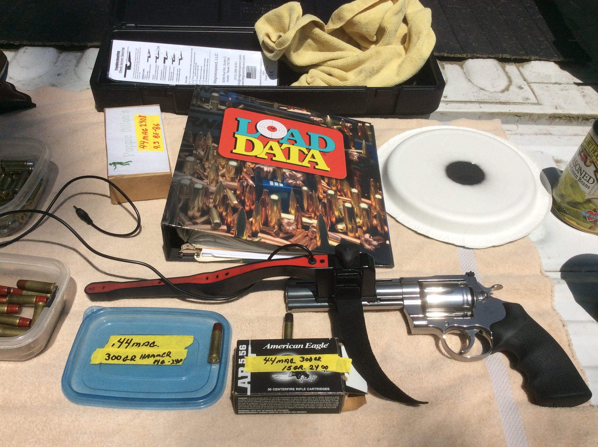

The 44 Mag Hammer bullets in red color are the 14 gr. loads with the black bullets being the new 15 gr. 2400 load. After running them over the Magna Speed the 14 gr. loads was faster than I had thought but as you can see the hotter 15 gr. load looked the best and at over 1100 FPS of a 300 gr. chunk of lead...that is as far as I will load it. If you can't take something down with that you better run fast!
As far as recoil the factory Colt Anaconda grip soaked it all up and it was very smooth shooting especially in double action where I do best.
Very pleased with results and will load more of these at 15 gr. of 2400.

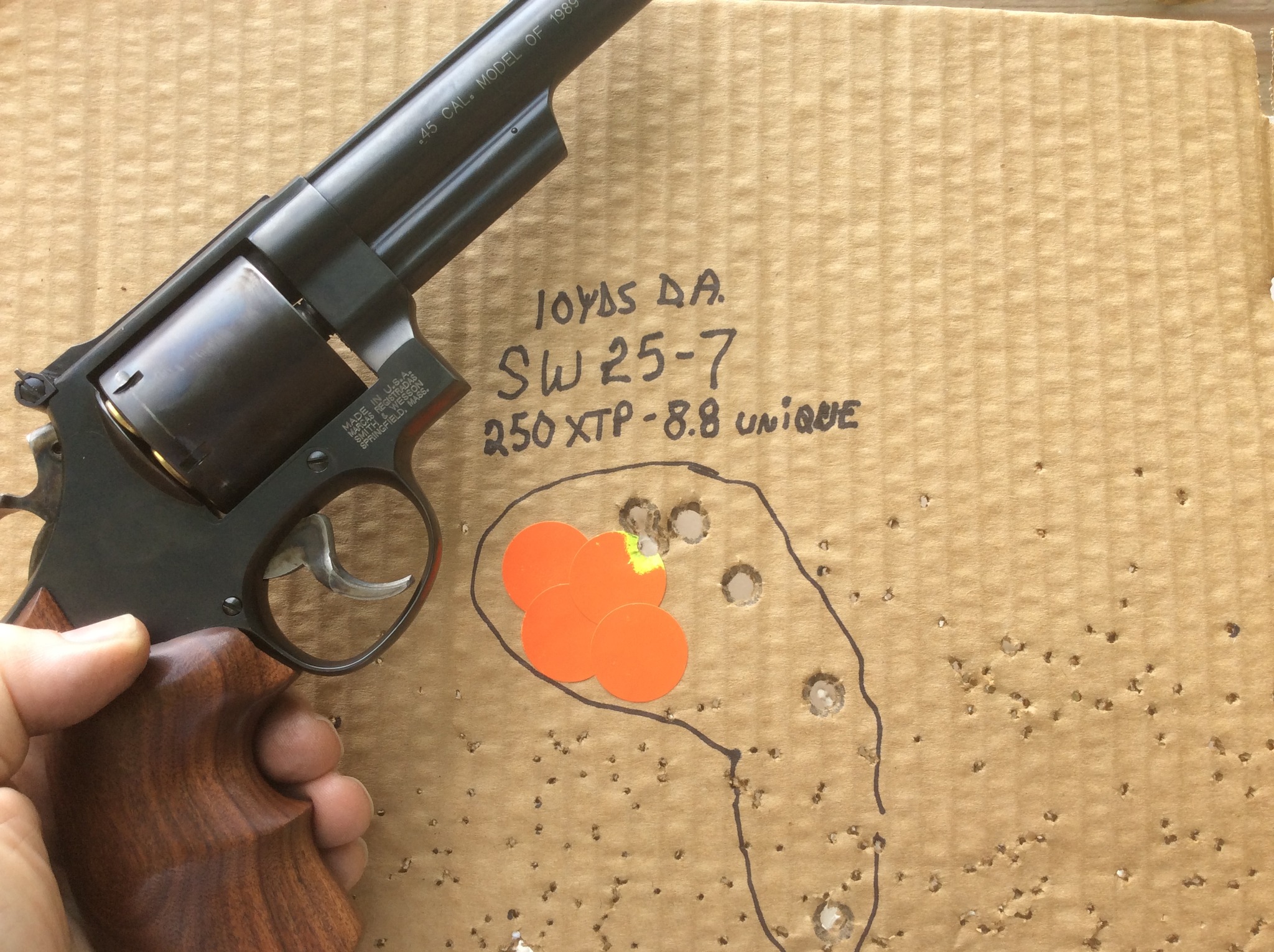

The Smith 25-7 is a sweet one to shoot even thogh the DA might not be as slick as the Anaconda the SA is very good! Had the 3 plate dueling tree set up and had fun knocking the plate/limbs around with both revolvers. These two large bore shooters give you a lot of confidence in shot placement and really fun to shoot.
Had a great afternoon at the range today!

missouri bullets 300 44mag hammer loads with 14 and 15 gr of alliant 2400.jpg
missouri bullets 300 44mag hammer loads with 14 and 15 gr of alliant 2400.jpg (709.31 KiB) Viewed 1579 times
6 shots in DA with 14 gr 2400.jpg (636.63 KiB) Viewed 1579 times
15 gr load better and centered group.jpg (508.86 KiB) Viewed 1579 times
the numbers.jpg (621.67 KiB) Viewed 1579 times
SW M25-7 45 colt double action 6 shots.jpg (787.28 KiB) Viewed 1580 times
my 2 best DA shooters in 44 mag and 45 colt.jpg (755.97 KiB) Viewed 1580 times

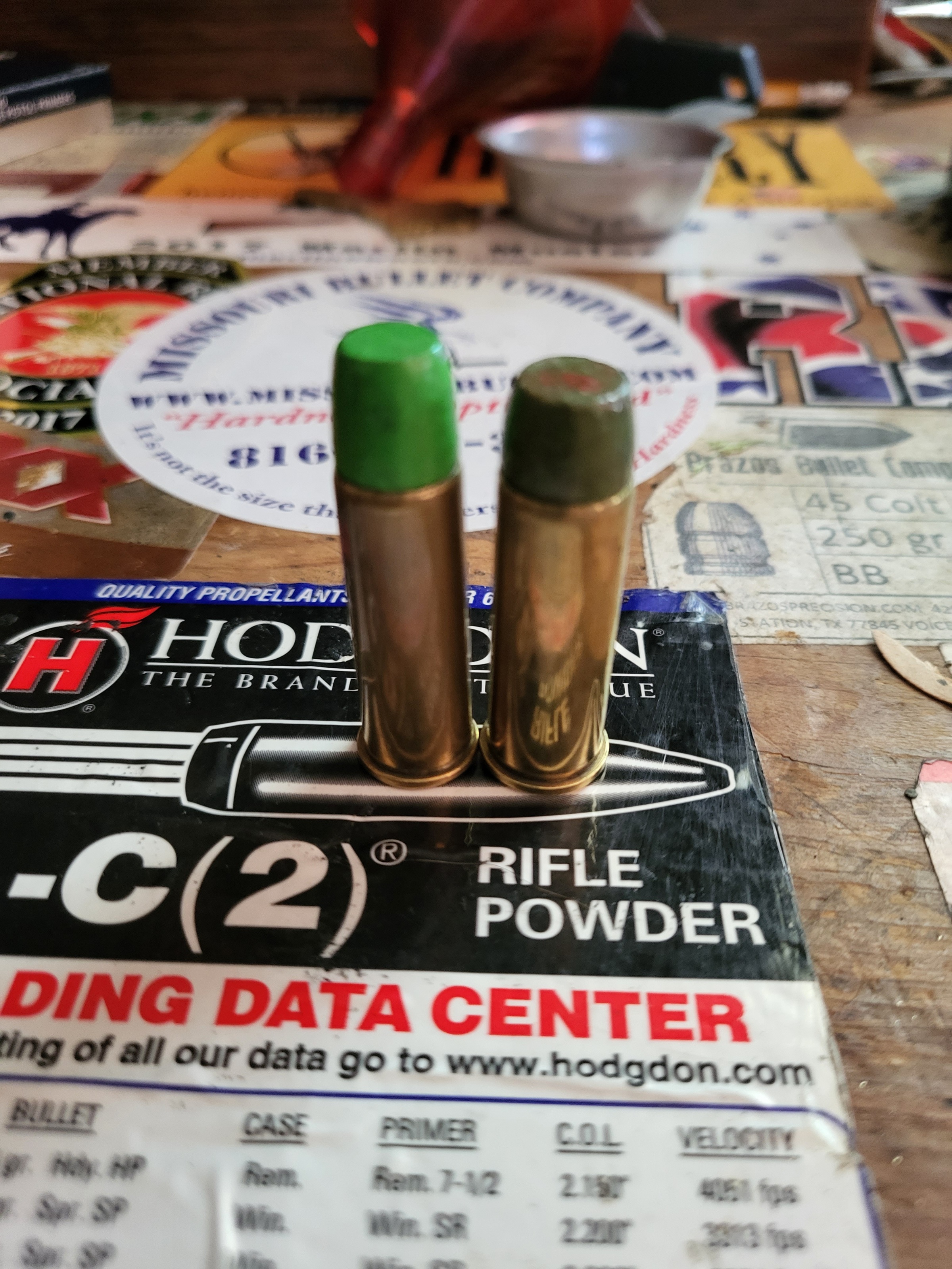

I need to load some of the 310 Lee's that I cast last weekend.
Was thinking about some 2400 with those.
I read earlier of a guy getting good accuracy from a Ruger SBH and 15.5 grs.
My Lyman cast handbook shows starting at 15, with a max of 16.6 for this particular bullet.

Forty, the 270gr 41 that I also cast, when loaded measures 1.70 and cycles just fine in my BBS.
So it just may cycle through.
Here is one compared to the 310gr 44.
