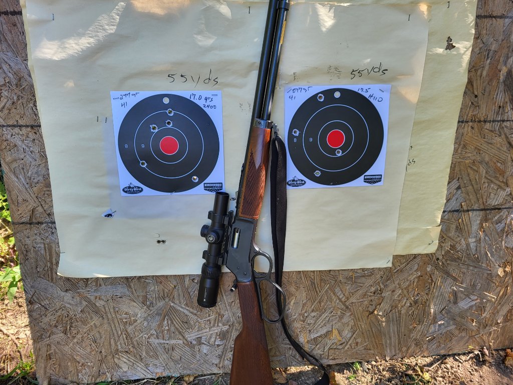

Yesterday I decided to drag the BBS and Ruger BH both in 41 mag. and try a couple of heavy loads.
I bought this mold a few years ago, it's made by Accurate and is a 270gr mold.
Well with my alloy these last ones dropped 276-280. :o :roll:
So I weighed up a bunch and found enough that were all close enough to get a half a$$ test. ;)
So the tested bullets weigh 277, and were loaded over 17.0 grs. of 2400, and the other half over 17.5 grs. of H110.
Well through the BH at 20 yds. neither load worked well at all, and were definitely a handful.
:lol: Six of each was plenty :lol:
Now from the Henry neither was bad on the shoulder, the 2400 load was a tad more.
Shooting was from 55 yds., and the 2400 load was the winner as you can see.
I started playing with these last year, but I seem to have misplaced the info so I'm starting over.

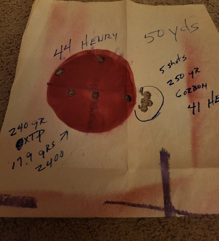

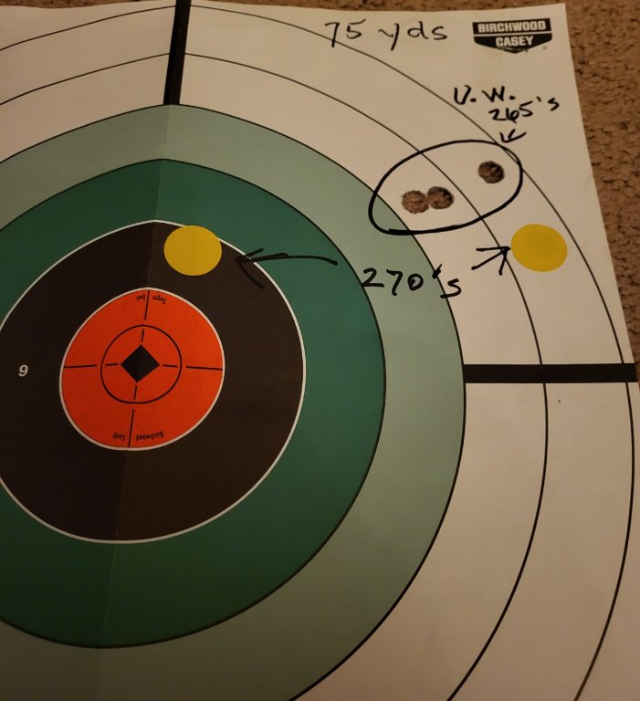

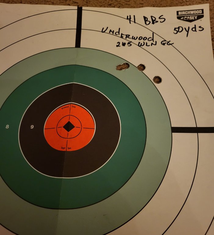

Post by Vaquero » Mon Oct 03, 2022 10:00 pm
Ok here's the cor bon 250 gr. group and the underwood's 265's.
That Cor-bon group is 3/4" center to center, ;)
the red dot is 4.5".

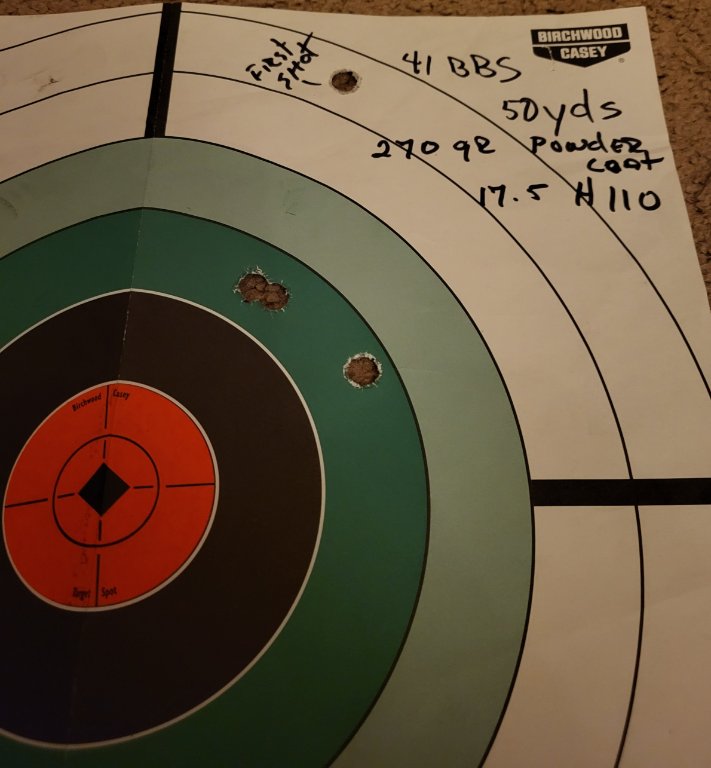

And one of my targets from last yr.

Post by fortyshooter » Tue Oct 04, 2022 5:13 pm
The 50 yd. Corbon shots made a nice ragged group!
Posts: 14168
Re: Heavy! For 41
Post by Sir Henry » Tue Oct 04, 2022 5:31 pm
All touching!
