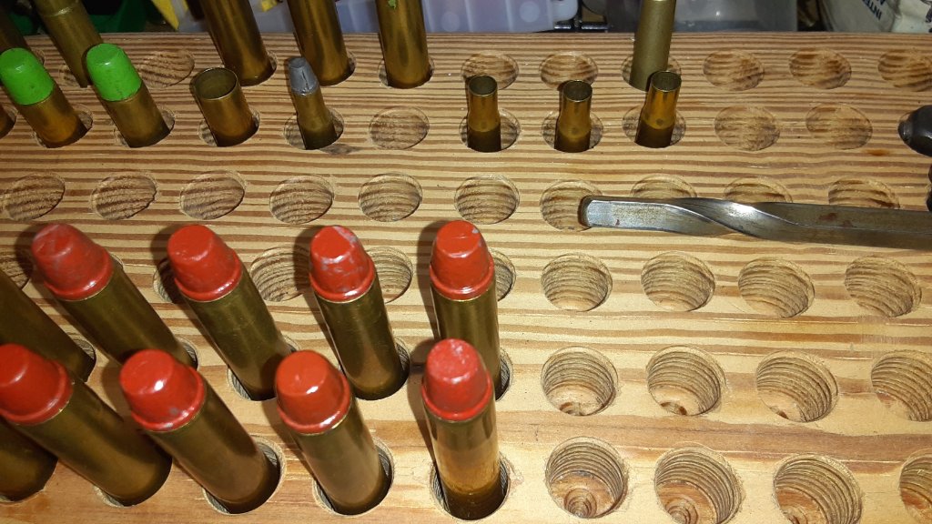

Here's mine, these are loaded with 41.0 grs of H4198.
